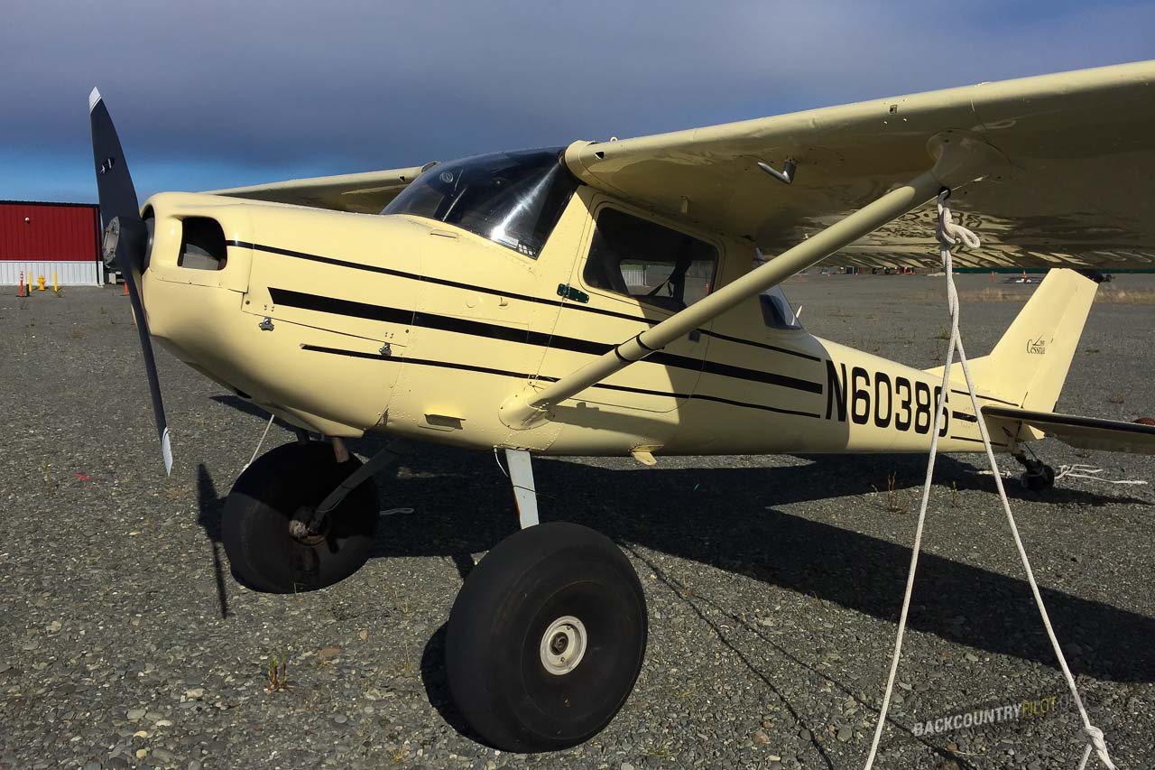

What's the powerplant on that 150TD?
I'd guess a Lycoming 320, but I can't see a starter ring.
Plus I've never seen a cowl & dual exhaust like that on a 150/150.

hotrod180 wrote:What's the powerplant on that 150TD?
IIRC it's one of Mike SIbley's conversions at Soldotna. I see the flywheel behind the nosebowl.

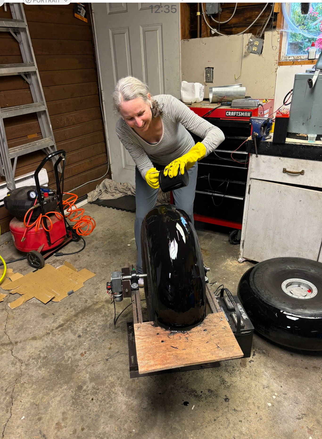

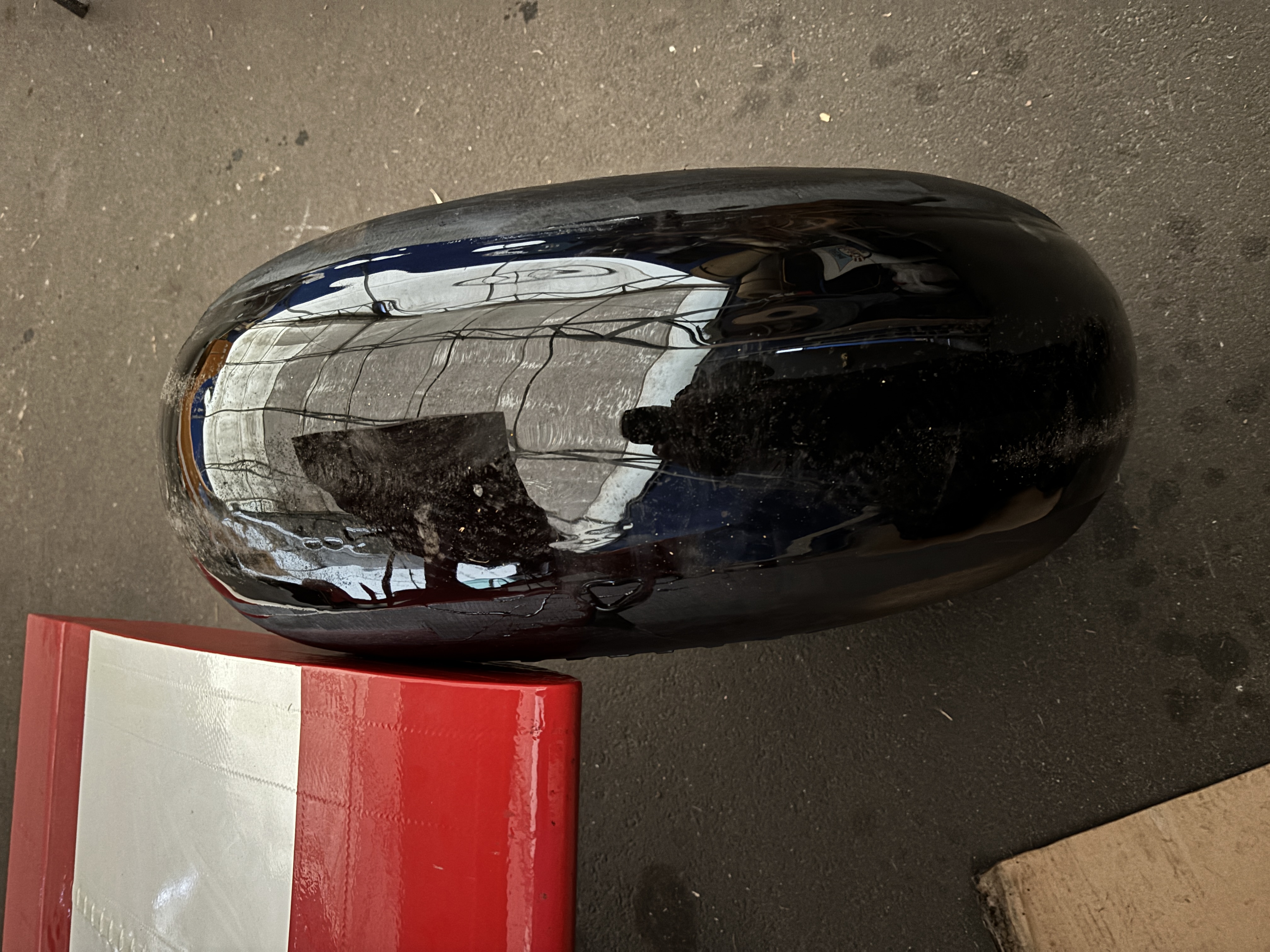

Went 8:50 on the Citabria, no spacers, tight (especially with new brake pads) but it fit the AirTracs, Goodyear might be different.
Moved up to 26" ABW, still no spacers, wore them down, Herculiner, wore them down. Would have helped if I'd flipped them on the wheel regularly as the outside "shoulder" wears faster than the rest.
Went the Devcon Flexane 80 route, built a rotisserie for 100 bucks using some old bunk bed frames and harbor freight pillow blocks. When they show cord, I recoat.
Trying a set of hand me down 29's now, cord showing, so they got the rotisserie treatment. And I've ordered a set of spacers from ACA (thanks David).
I ran the 8:50 at 14 psi, 26 at 10, 29's I dunno - gotta be able to push it out the hangar. The ABW can leak a little air, give them the Stan's treatment before you recoat, ABW sells an orange alternative to Stan's now.
Newly coated 29's
She says it's no different than icing a cake 26"
