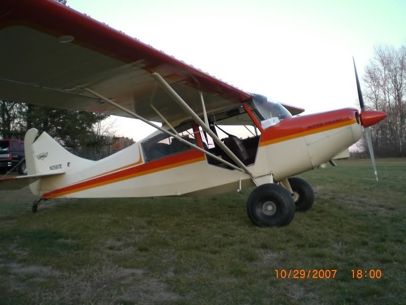

Some of these pics show 26" and 8.50's, but using a C90 or 0235 engines/
Champs on bigger rubber look pretty cool and function well IMHO

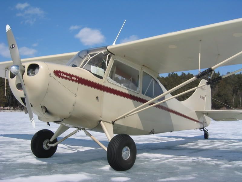

I like the fourth one down. The white one with the red stripe. On the ice. Looks terrific!

Emory Bored wrote:I like the fourth one down. The white one with the red stripe. On the ice. Looks terrific!
Yes, those tires look perfect. Does anyone know what size those are?

They look like 850 airtracs to me.
Keep in mind that bigger tires add weight. They not only need more horsepower to lift them, but they reduce the legal useful load plus affect the weight & balance. For McCreary Airtracs,which I like, I think a set of 600's (incl tubes) weigh about 16 pounds, 800's around 22 pounds, and 850's around 36 pounds. I think a set of GY 26's are close to 50 pound. Prices for these tires go up pretty much proportionally with size.
ABW's are nice but weigh alot, plus the price tag is pretty hefty too. Admittedly the best thing for off-arport, and for cool, but maybe not required for the flying most of us do.
