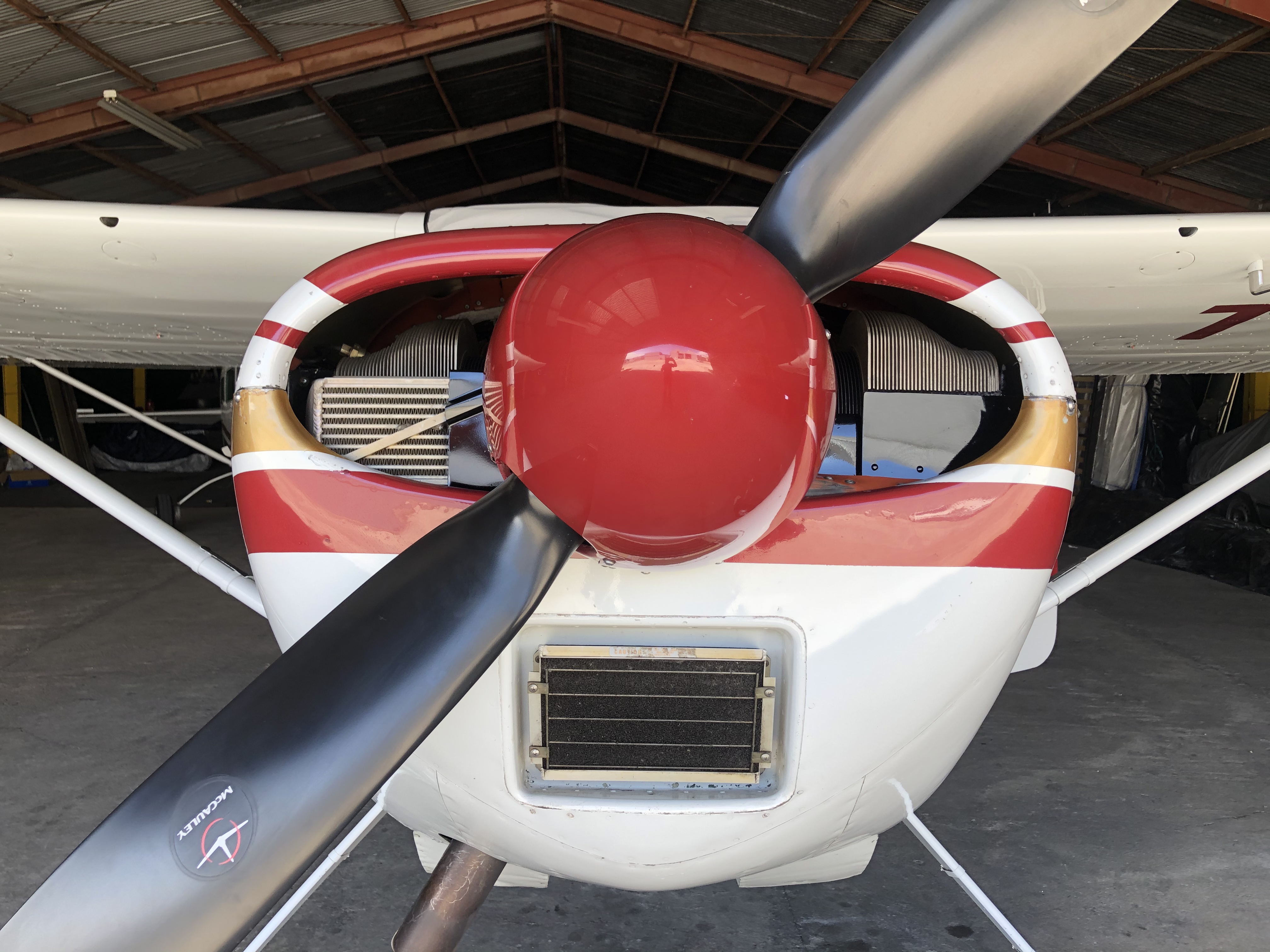

Re: C-180 O-470 R Cyl Head Temps.
Case solved.
Cyl 2-4-6 now sometimes even just 10 Deg. Diff.
Oil cooler plate also raised temps to get 180 at cruise.
