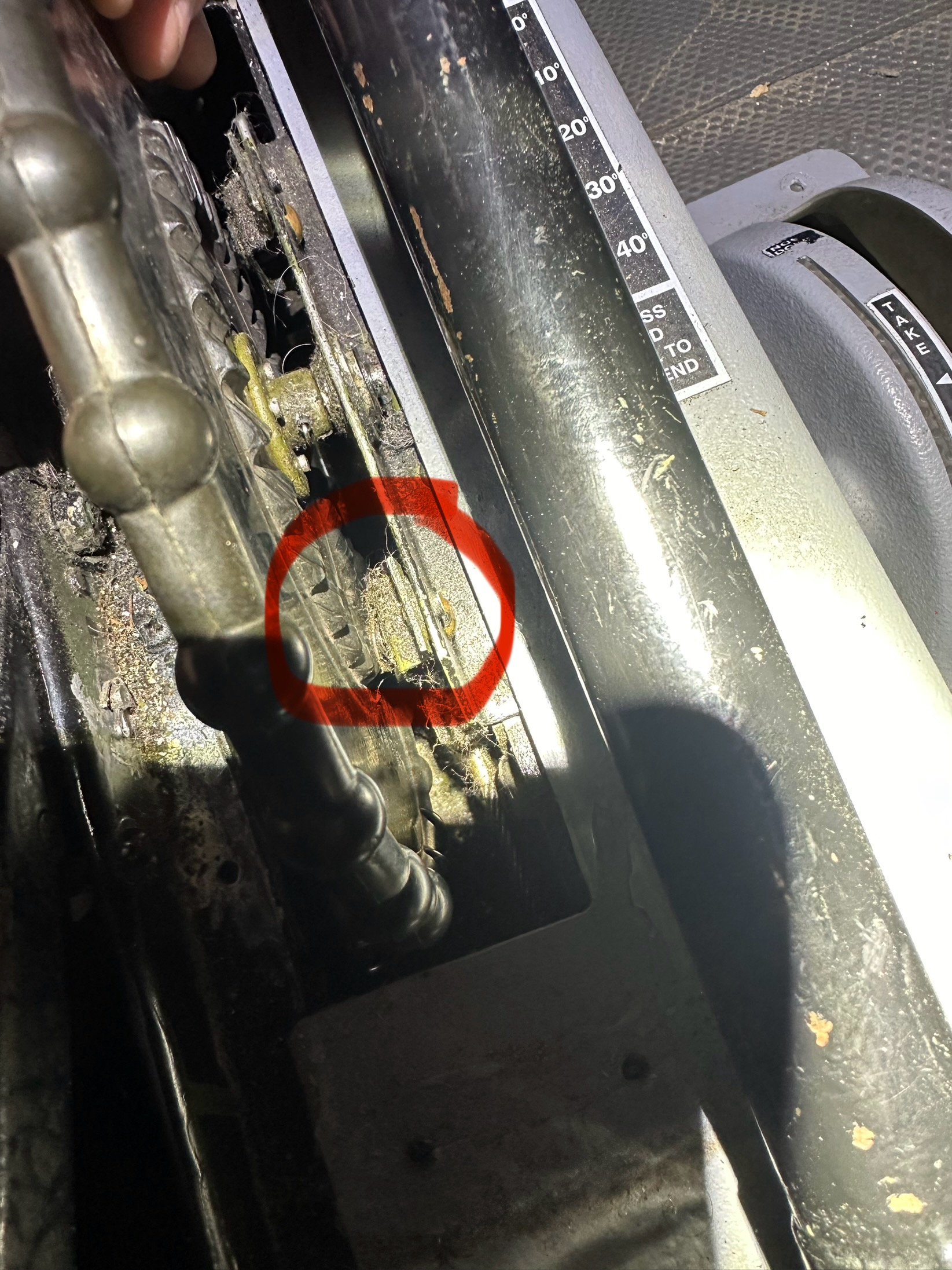

Went out and took a closer look at it. One of the “buttons” that makes the trim wheel ratchet is coming apart.
Cables all looked good, so hopefully replacing that button solves it.

Same thing here. Wheel was hard to turn then kind of gave loose. Landed took off the cover and discovered the forward catch ball had disintegrated and was left with the inner spring. I looked at the wheel and noticed the locking ridges on the copilot side had a pretty decent amount of wear. Since I have to take the whole thing apart to replace the catch ball mechanism I decided to get the whole assembly from McFarlane. New wheel, shaft, sprocket, and catch assemblies.

I own a 53 180, so no clickety-click on the trim.
Looking at that pic of your trim wheel, it seems like the "locking ridges" are biased--
in other word, they'll rachet one way but just let the catch ball just ride over going the other way.
Is this how they are from the factory, or is this the wear you mentioned?

As to the ridges, thats how the trim wheel is designed on later 180/185's. I had a '54 180 years ago and it did not have the catch mechanism.
