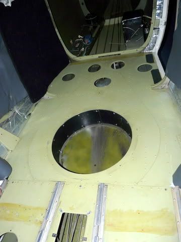

Hi Guys
Anyone seen a camera hatch like this in a 180/185/205/206 etc ?
Friend has bought it and this is posing a slight problem with the paperwork... :?
Thanks

Pretty sure its stock and if you look in the back of a parts book for that year it should show it as an option. There will be different cables and brackets for the elevator & rudder cables to go around the camera port. That should be enough proof to clear up any paperwork issues.
