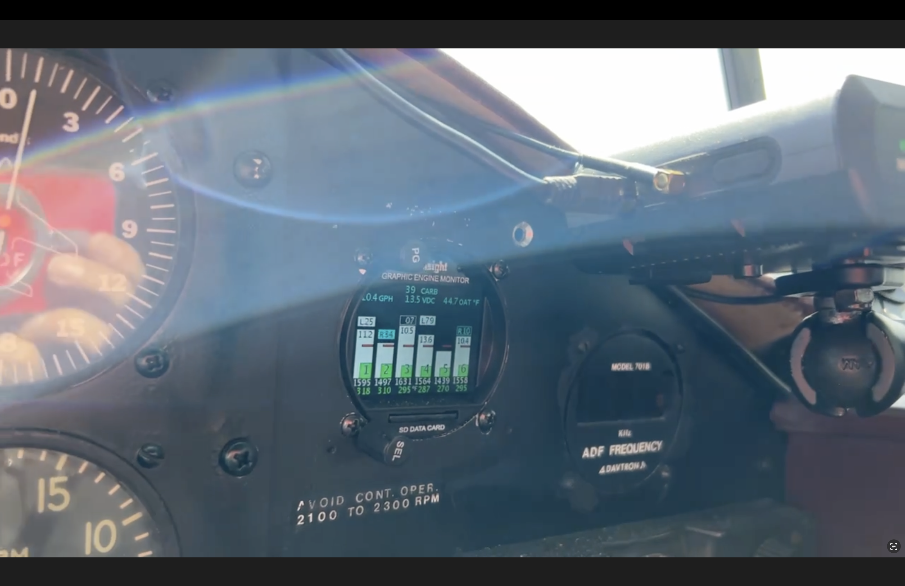

My Insight G2 engine monitor showing both OAT and carb temp. Engine is Franklin 165.
