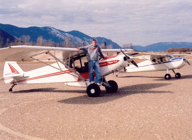

And if you look behind the Husky in this shot:
http://www.backcountrypilot.org/gallery ... m=4&pos=43
a 140 up at Crane Lake (C-90 in it, I think)

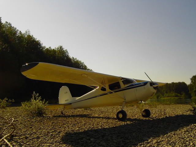

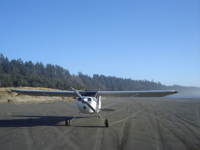

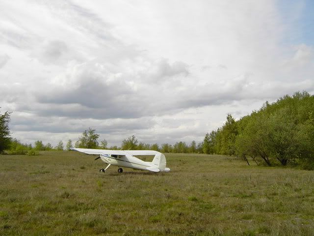

I am the pilot from the white and blue Cessna 120 pictured above. My father owns the airplane, it has a Lycoming O-290D 125 HP engine. It will do better than most would think as an off airport/back country airplane. The airplane has 8.00X6's on it: the largest the type certificate will allow. It would do better with 8.50X6's or 26'' goodyears. I have had it on sandbars as short as 500-600ft, gravelbars, and various other short unpaved strips. I've flown it with PA-18s a few times even some formation takeoffs. The takeoff roll isn't much more and it will climb out just as good as a 160hp cub. I have seen up to 1800ft on the VSI after a solo takeoff at sea level. Cruise is great, about 125MPH at 2350RPM. The only downside is that the usefull load isnt much, but it will haul anything you can get into it. I also know the guy who owns the white and Red C-140, it has a O-290D2 135HP engine, I got to fly it a couple of years ago. The VGs and Flaps really help out, I didn't get to fly it much to see what it could really do but I was making approaches at 45MPH indicated with some power.
