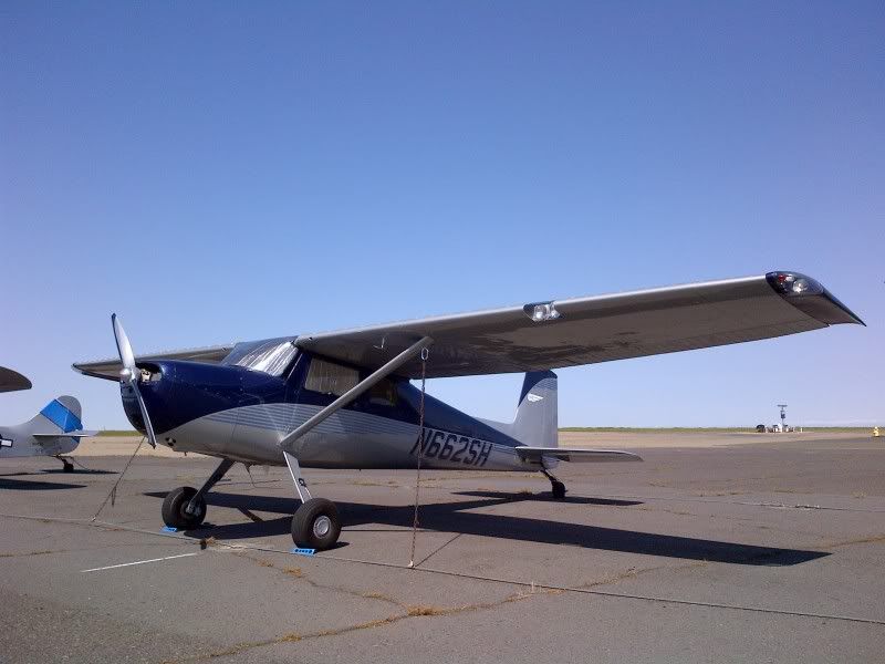

Since we've been talking about fastback 150 taildraggers I thought I would share this pic. This 150 showed up at Rio Vista today, its one of the nicest looking ones I've seen.
