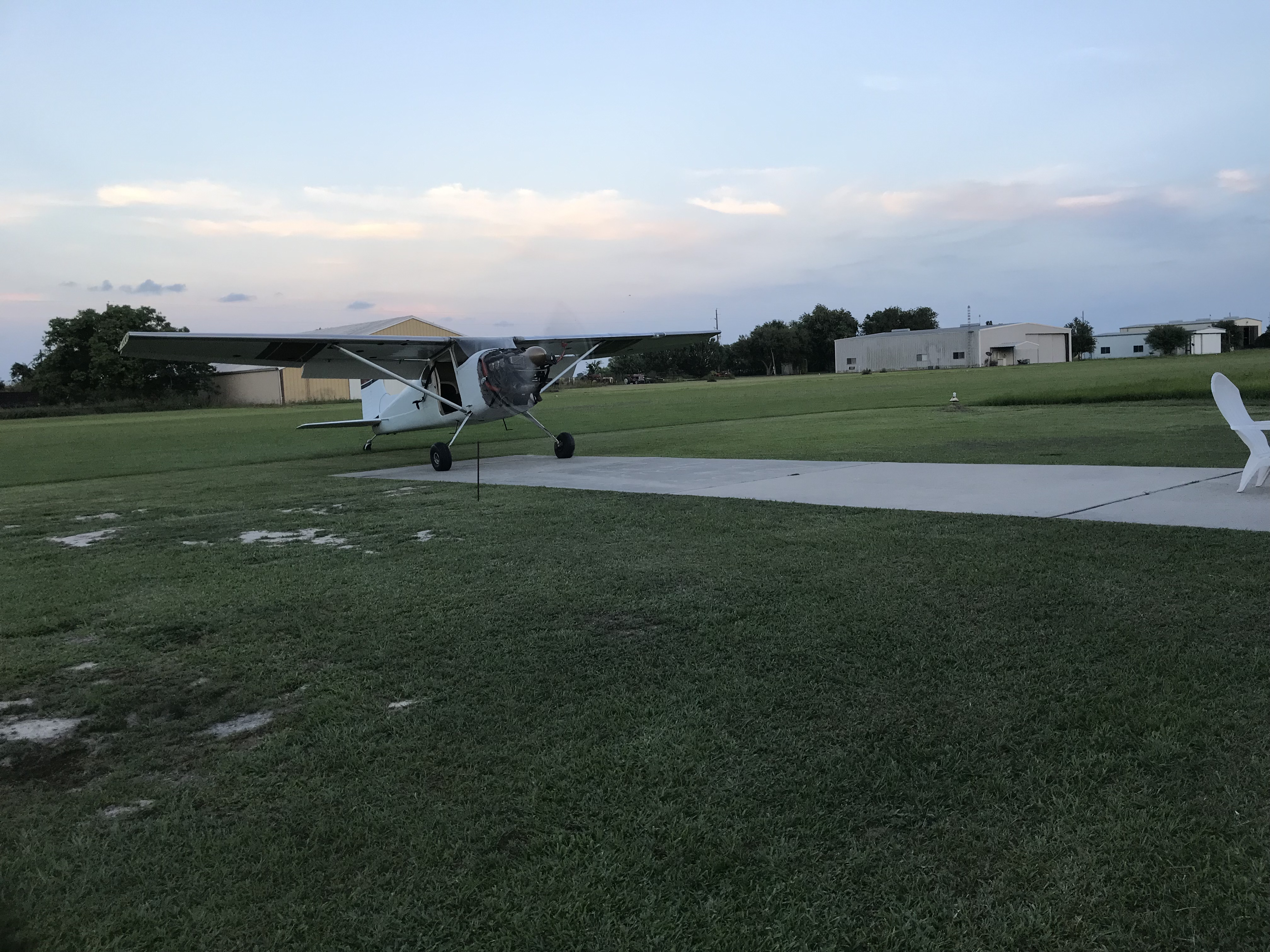

I’m new to the forum and in the middle of upgrading a Cessna 182 TW conversion. We call it the 181.
We are trying to figure out options for a rear seat and there are lots of cons to what’s out there. I’m wondering if anyone has tried or if it would be possible to add seat rails to the rear and put the old style Cessna front seats in the back.
Those seats are more comfortable, sized for adults, could be moved forward or aft to account for adult passengers or cargo (CG dependent), and they can be found anywhere.
Thanks and I’m sure this will include some interesting discussion.
