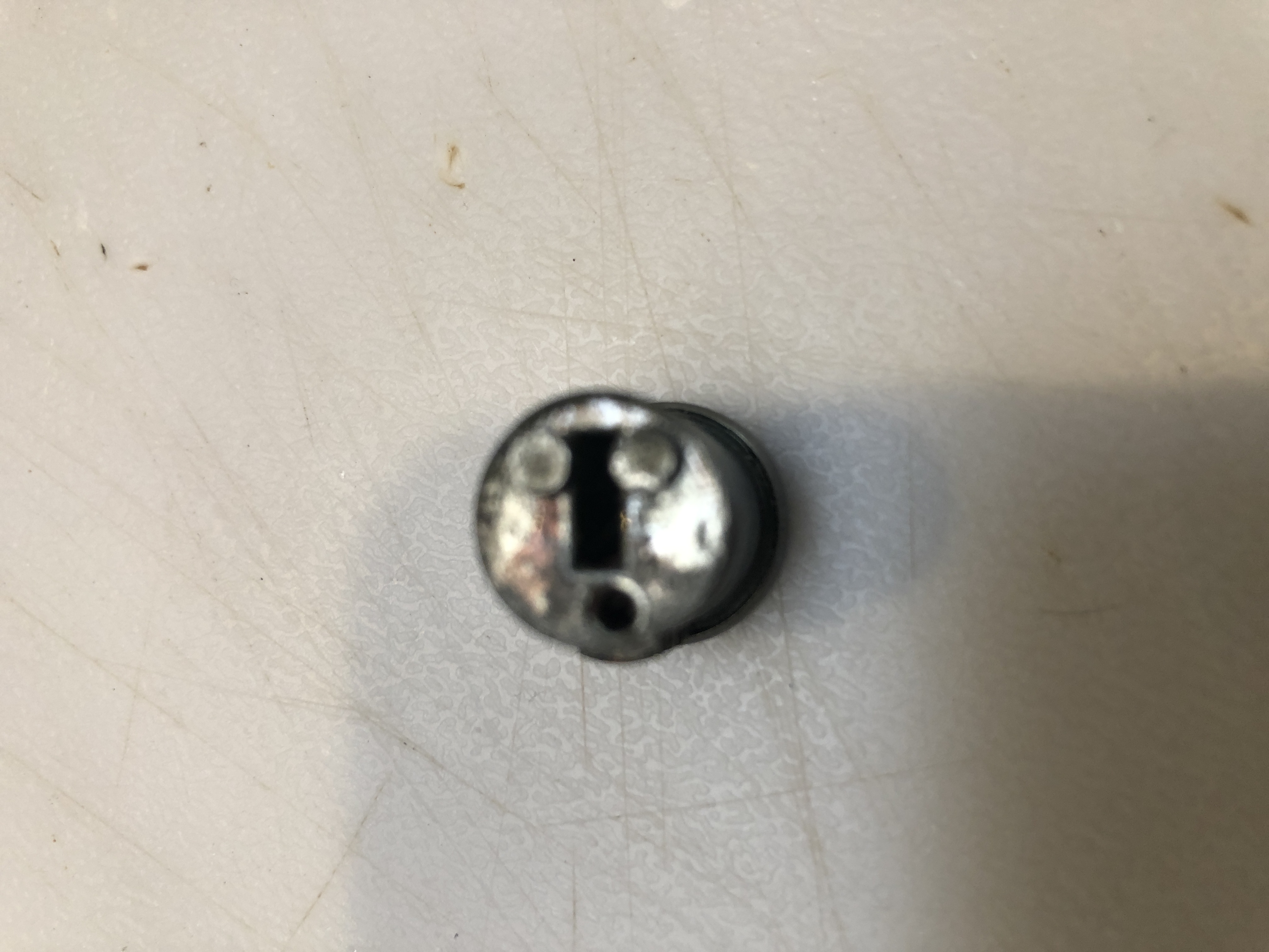

This has been posted a gozillion times. My cylinders in door and baggage are toast. Can't see paying 80+ for worn out cylinders. Who made these? They can't cost much. Has anyone found a suitable replacement?

Pull out the cylinder and take it to any lock shop. They will measure it and sell you a generic cylinder for a few dollars, probably a lot better quality than the original. On a related not, all single engine Cessna's up to at least 1980 all used 1 of 12 keys, actual security by locking the door is a joke.

Have you ever done this. I have had no luck.
Dale Moul wrote:Pull out the cylinder and take it to any lock shop. They will measure it and sell you a generic cylinder for a few dollars, probably a lot better quality than the original. On a related not, all single engine Cessna's up to at least 1980 all used 1 of 12 keys, actual security by locking the door is a joke.

Yes, I have put generic lock cylinders into a 1965 C-150 and my current 1957 C-172. I also know of a few other planes over the years that have been replaced with non-Cessna locks. They are all the same diameter with 2 flat sides (it's called a double-D hole), The difference is the length of the cylinder and how the bar attaches to the end, usually a square plug. On my 172 the bar attachment was something else, so I cut the old bar and welded 1/2 of it to 1/2 of a new bar.

This is the end that will cause problems. I am no locksmith but I have never seen one like this where it attaches to the cam.

Cessna and several others use equally POS'y locks. It isn't even the locks themselves that have negative pressure induced on your world, it is the whole way the door locks. Yes you to can be the Fonze, by banging the side of the airplane to pop the door open. The locks themselves are similar to file cabinet locks, using a wafer system. There are actually 4 to the 4th power of lock combinations, 4 wafer thicknesses, four positions. They are very easy to re-key, if you have some spare wafers. The only thing locksmith locks are good for are parts, not even remotely similar in the rear side. My hat is off to the micro welder, I would have small puddles.
So every time I go to the aircraft junkyard, I snag a cylinder. I try to re-key all my aircraft the same. If you do not use the little star washer and some locktite, the screw will back off and your unicorn-like cylinder will fall off into space. Usually killing something on the ground. To re-key, you put your key in your prospective cylinder, if one or more of the wafers stick up, or is depressed into the cylinder, then it needs to moved about to another position. If you have a few wafers (I've never done this before), you can swap them out quickly. You just need some small needle nosed pliers to grab the wafer. Be careful of the little tiny springs, they go in the round holes on one side of each wafer. They like to enter a parallel universe if you do not keep them under control. If your effort to get all the wafers flush with your key inserted and you have no more selection in your pile, then you can file off the offending part that sticks out of either side. Not optimum, but these locks are a joke anyhow.

The point being you can buy any Cessna cylinder and move the wafers over to match your key. You can find them on eBay.
