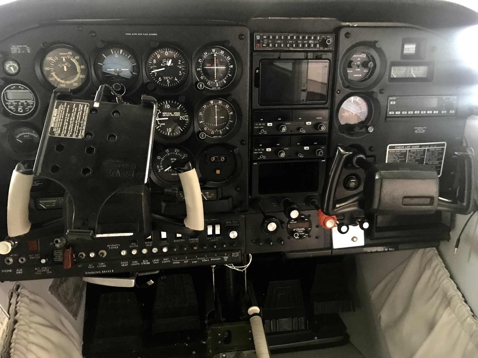

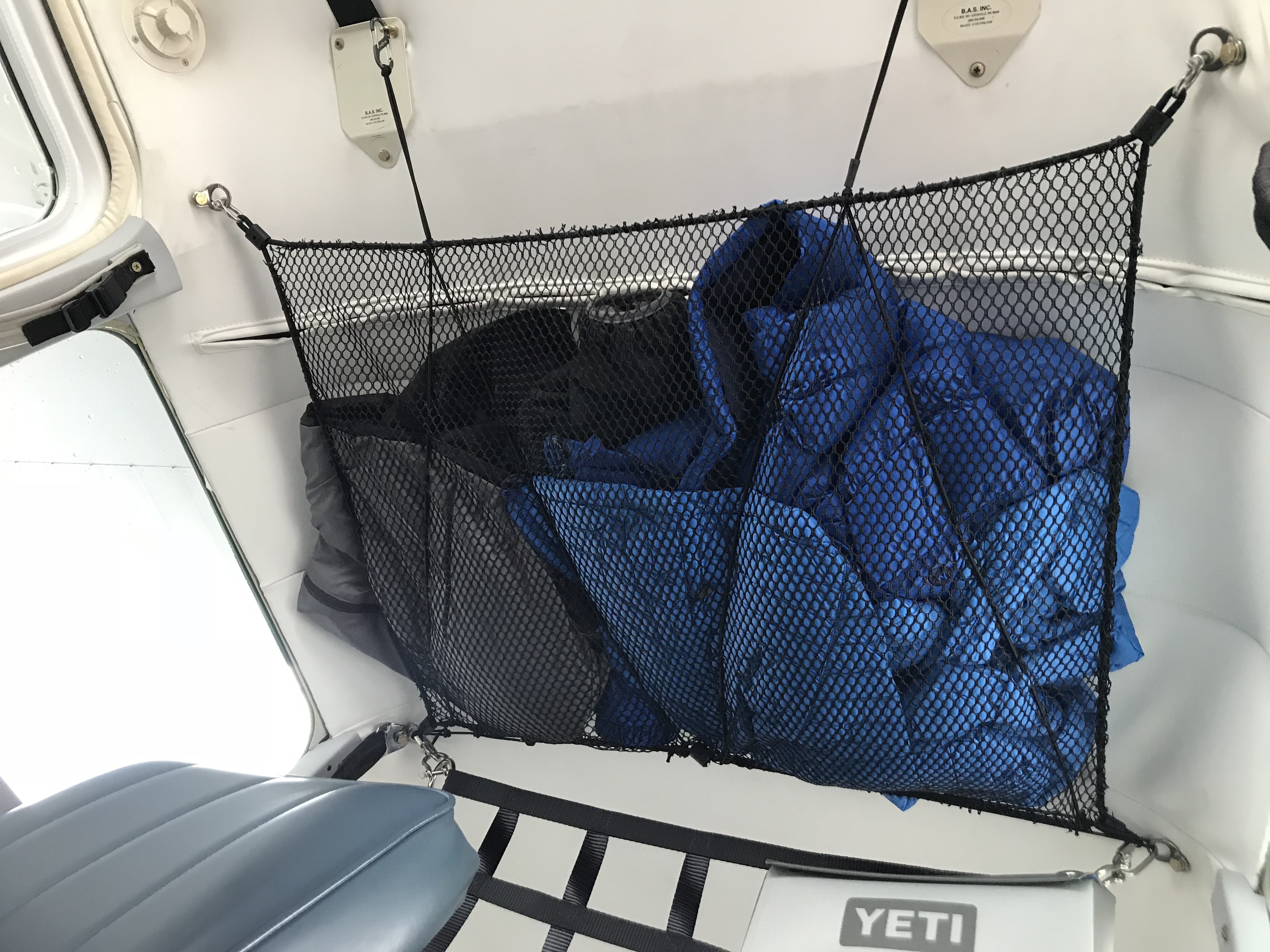

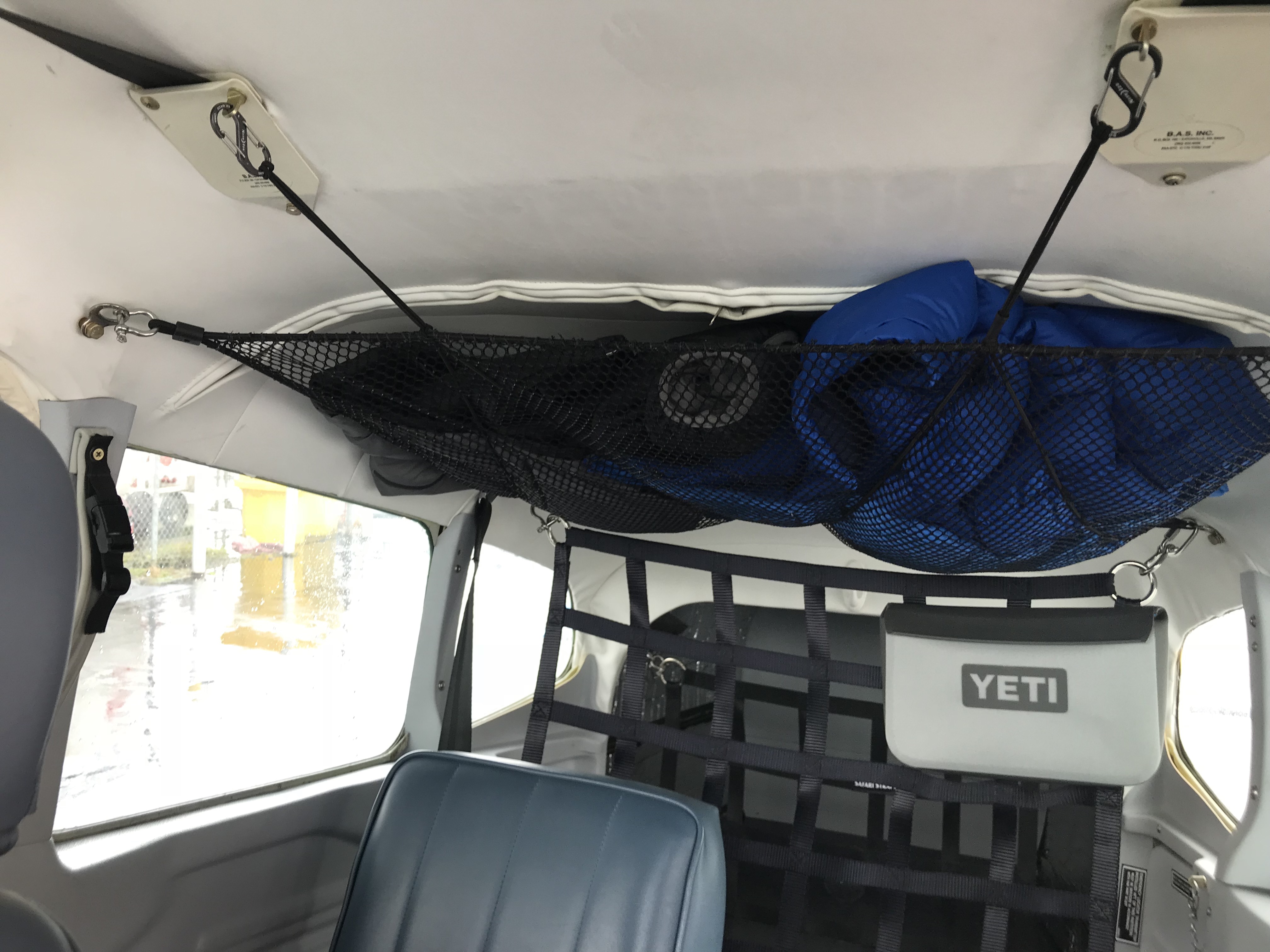

So after an almost 5 week business trip to the Middle East and all the other distractions in life I finally have my Annual Inspection done along with some of the modifications I have been wanting to do. In the past two months I have been able to complete the following in preparation for our trip to AK:
Removed and repainted instrument overlays
Removed and repainted KX-155 faceplates with Cerakote H-series paint
Installed Jupiter Avionics "glove box" in avionics rack
Removed carpet and installed SCS vinyl flooring
Installed door stewards
Removed old King KMD-150 GPS and King KR-86 ADF
Installed standby 28Volt Attitude Indicator
Installed Garmin Aera 660
Installed Garmin GDL-52
Replaced RH Cowl Flap cable:(
Installed Shadin Microflow fuel computer
Installed Stratus dual USB Chargers
Installed EI “Super Clock”
Installed NVG compatible cockpit post / flood lighting
Installed aft and middle cargo nets
Removed 4th, 5th, and 6th seats
Installed shoulder harness for 3rd and 4th seats
About all that’s left to do is install the Air Plains (Bonair) 252Hp upgrade for the O-470U and source bushwheels and tailwheel.
