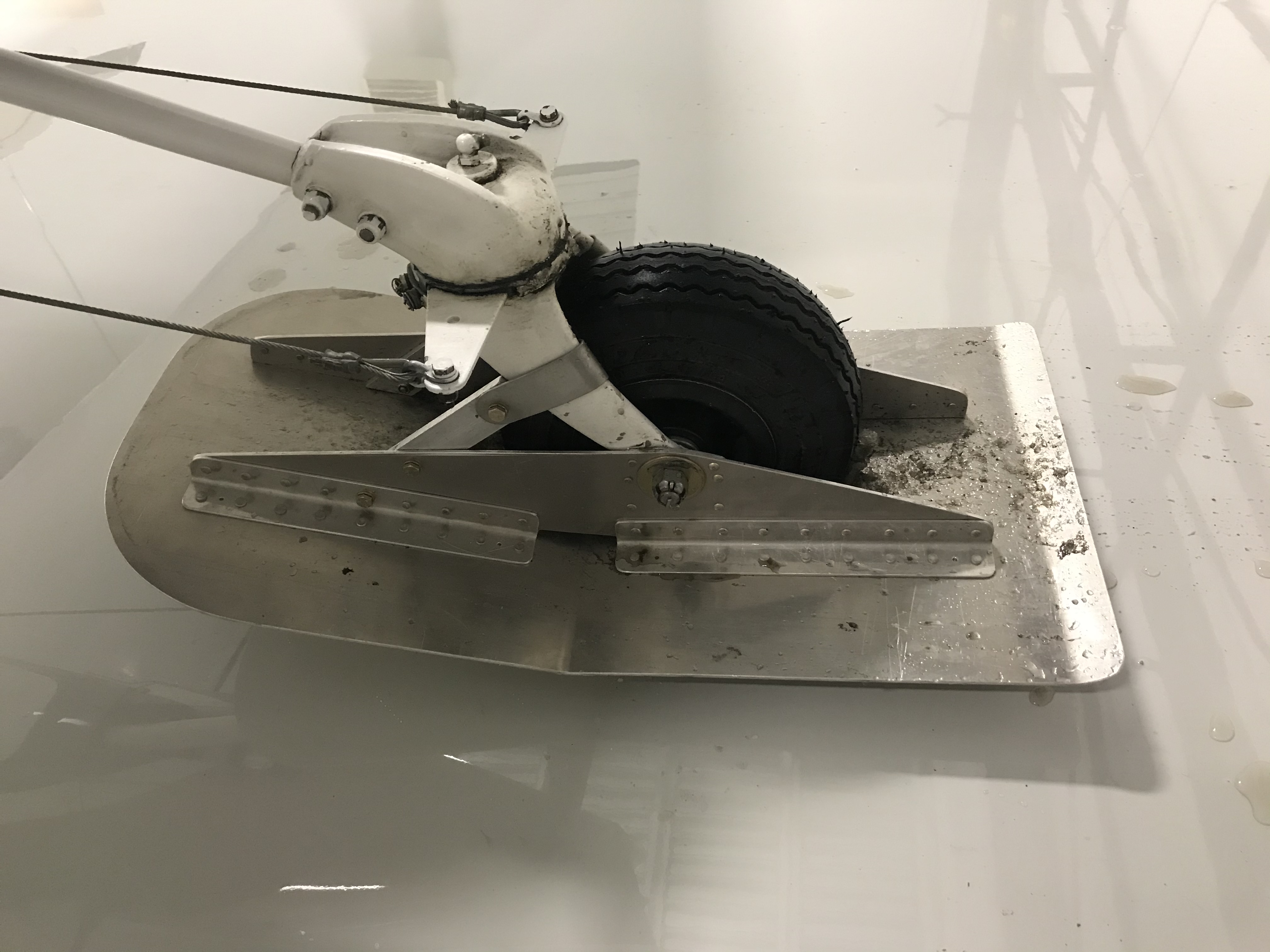

Hi, I just did the install of a tailski on my 185. It is an home made tailski.
I did 4 landings and 2 of them had really bad shimmy associated with the tailwheel. Never had that before.
Pretty straight forward installation, the only new thing is the axle that needed to be longer and bearings were regreased.
When I did my last landing everything was fine and i gave a little bit of rudder to go on a high speed taxi way and it started the shimmy. It lasted almost until the airplane was full stop.
Any thoughts?

You may find that you trash your mounting bracket, as you have no give in that ski. My first home made attachment for my ski was similar, no give. As a result, my mount hardware got beat up, things got bent. Here's a pic of my current setup.Image

Along these lines, I think you are better off having the ski shorter going forward and longer behind. The mass looks mostly forward on your setup which, like Asa says, will make the shimmy worse.

I agree with ASA and A1. Add length or weight to the rear of the ski.

I don't like the attachment on your ski to the tailwheel yoke. I think that tailwheel should be able to float some, nose up. Not sure if that'll cause undue wear on the yoke. Yokes are spendy, BTW.

I’m not sure changing the relationship of ski forward or aft will eliminate the shimmy. It MAY reduce it. Frankly, I think the weight and differences in weight on those tailwheels, due to load differences, change the angle of the wheel, and may just make them more susceptible to shimmy, at least more so than lighter planes. Adding mass to that wheel may be just the straw that flattens the camel.
