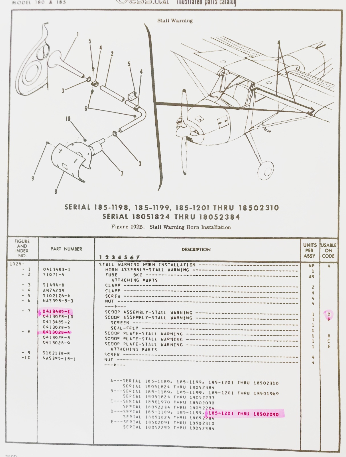

Re: Cessna 185 - What stall warning mechanism to install?
It's been a few since I looked closely but I think both sensors are adjustable up and down the leading edge to fine tune. But as I say it's been at least three years since I heard one on a Sportsman cuff. I copied some below that look adjustable.
Thanks for the reply. Our C185 is the first one in the Czech civil aviation authority register, so there is limited experience on both mechanic and authority side. I hoped there might me some alternative solution with STC. Now I understand that there is not.
We have S/N 1740, so as Gary mentioned I need to find vacuum based horn.
The electric vane is adjustable, though internally not like the picture above of the plate on the outside (on my 170 wing). I found with my Sportsman install that the radius of the leading edge where the vane now goes is tighter than the original and the mounting plate needs to be rebent to fit the new shape. As a result I think it would be fairly difficult to actually move it much. The jig that Sportsman supply makes it easy to get the vane where it should be.
The stall characteristics have changed so much that the horn is more of a "guideline" now. You will love the way it flys.
