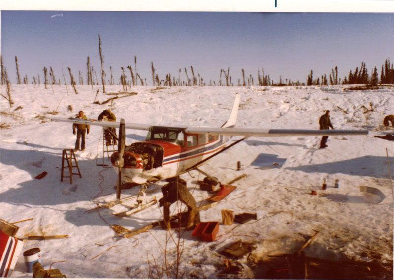

Mike I have to agree with you on this one. You hit the nail on the head this time. C206 is in my opinion the best all around single engine Cessna ever made. But Gump is correct the 207 was an Air Taxi $$$ maker for a wheel operation airport to airport. I did fly a C207 on skis once after Atlee Jr. worked on it for 3 days #-o He replaced nose gear, 3 ft of each wing and prop. One of Vanderpools kids left in the toolies. Guess I needed $$$ more back in those days :roll:

Atlee bought it from the insurance co. for $12,000. Paid me $1500 to fly it back to Anc and he sold it for $30,000 the next day =D> Easy to make $$$ in Alaska :mrgreen:
Mike I have to agree with you on this one. You hit the nail on the head this time. C206 is in my opinion the best all around single engine Cessna ever made. But Gump is correct the 207 was an Air Taxi $$$ maker for a wheel operation airport to airport. I did fly a C207 on skis once after Atlee Jr. worked on it for 3 days #-o He replaced nose gear, 3 ft of each wing and prop. After one of Vanderpools kids left it in the toolies. Guess I needed $$$ more back in those days :roll:
