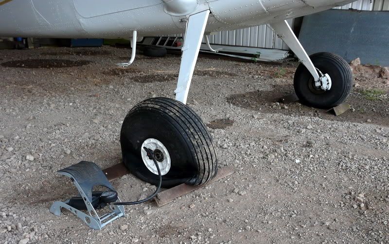

Or maybe one of those air bags the city slickers use to lift their 4x4 trucks(the ones that stay on the pavement).
Might be light enough and still get-r-done in a pinch.

a64pilot wroteThe other day I had to fly the 210 somewhere and on preflight noticed the nose wheel was a little low, so I put air in it, pushed out of the hangar and took off. On landing it was dead flat. The schrader valve core was slightly bent and stuck when I aired it up. Did you just air up that tire before you left?
