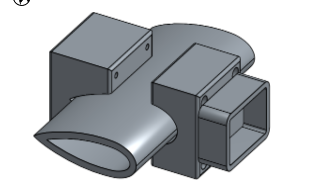

This is what I ended up building.
Liabilities:
o It's kind of a hassle to put on and take off
o It can only point the camera perpendicular to the strut
o You need access to a 3d printer to make one
Advantages:
o There is no moment arm to add wind vibration
o You can rotate the camera box to, at least, have the image parallel to the horizon
o There is no vibration ground to transmit aircraft vibration to the camera
o Anyone with access to a 3d printer can download (or modify) and print this design
https://cad.onshape.com/documents/5857d ... f070c5863a

To the OP, I like that fabricated tip mount, plus how it uses several screw points for stability. That 3D printed one is a neat idea as well. I have a WingIt mount for my strut which works well, and gives me 3 cam positions. The one directly in front approximates that 3D mount as it's directly in line with the airflow, but the ones on top and bottom are well into the slipstream. The shots work but are a little bouncy between the vibration and wind blast. I am somewhat hesitant to put a bulky vibe mount on there with it, it's just more stuff hanging in the breeze.
I am still determining how I'm going to mount one on the vertical fin. I don't see any screw-based method working where I can still reach the thing unless I install a rivnut into a rib, and I don't want a single-piece adhesive mount up there just out of an abundance of caution. I'm probably headed towards a custom CAD design / printed object that can stick in multiple places and streamline the flow a bit for less drag.

colopilot wrote:I'm probably headed towards a custom CAD design / printed object that can stick in multiple places and streamline the flow a bit for less drag.
FWIW, my mount is probably as draggy or more than using a sticky, but I found the moment arm was far more important than the total drag. Because mine essentially has none, the drag doesn't have anything useful to act against.
When I have access to a printer again my plan is to go a very different direction and create a mount sufficient to hold a small gimbal with an acrylic dome over the whole thing. Then I can get stabilization and the ability to change what the camera is pointed at in-flight.
