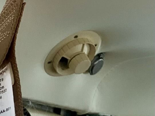

Anyone have experience with a more modern replacement for the rear Cessna vents? Preferably something of the same diameter and screw pattern as the original so it can mount to the existing can. I see some options around online but reviews are mixed and some require more extensive modifications. I'm installing new vents for the crew seats, these vents are the only thing that feels cheap/dated in the cabin so I'd like to replace them for aesthetics and function.

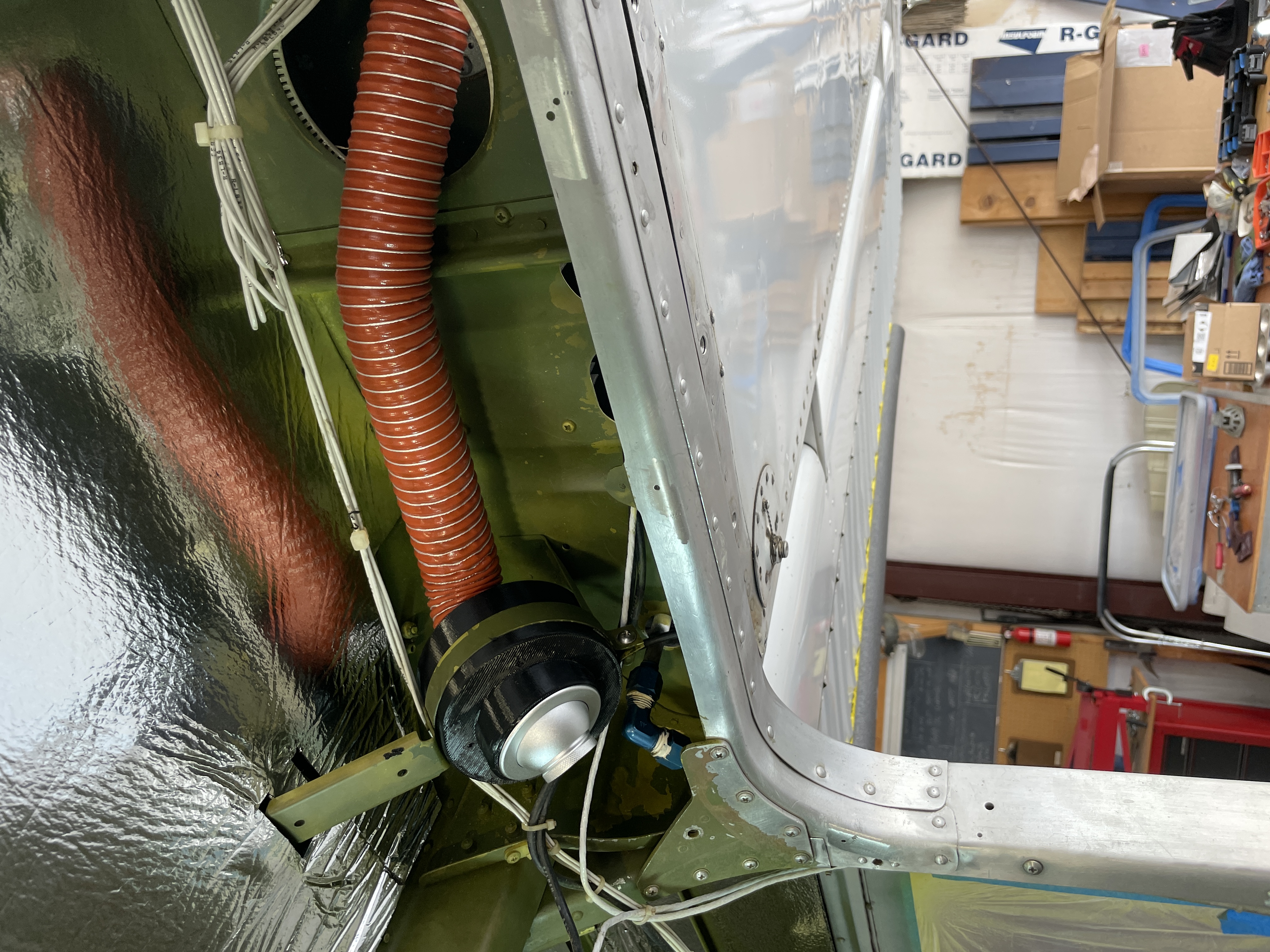

My solution for the vents was these from A/S. https://www.aircraftspruce.com/catalog/ ... ilver2.php
I had to replace the vent tube due to tears and discovered that Cessna had 1 1/4” tube from the wing necked down to 1” tube to the vent which of course restricts the airflow. The new vents have a 1 1/2” inlet so my son 3d printed 1.25”-1.5” funnels to run 1.5” tube to the vents. He also printed the fixture to hold the vents and fit into the original brackets. It’s an improvement in every way. The airflow is outstanding! I’m an A&P and signed it off as a minor repair.
