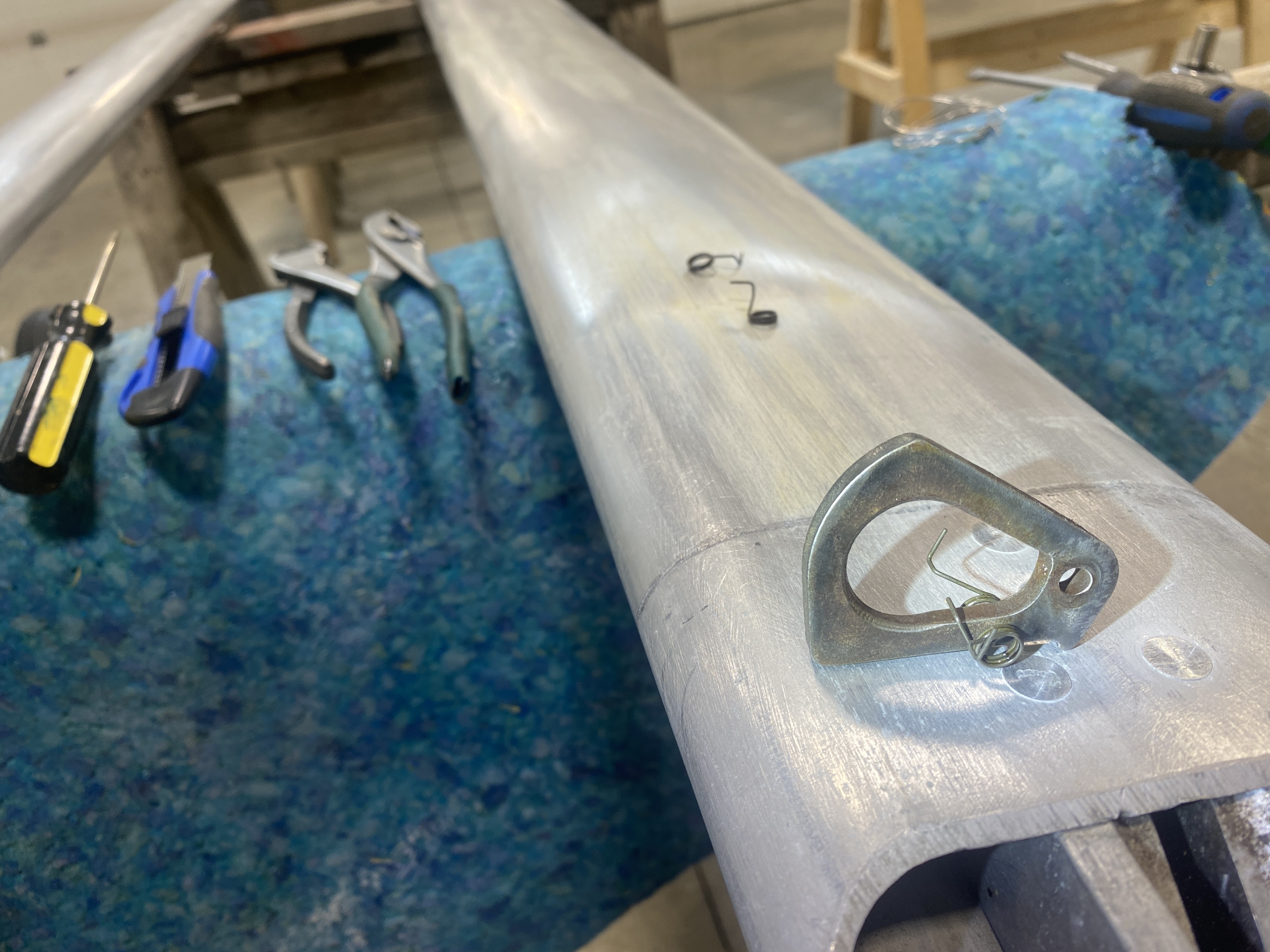

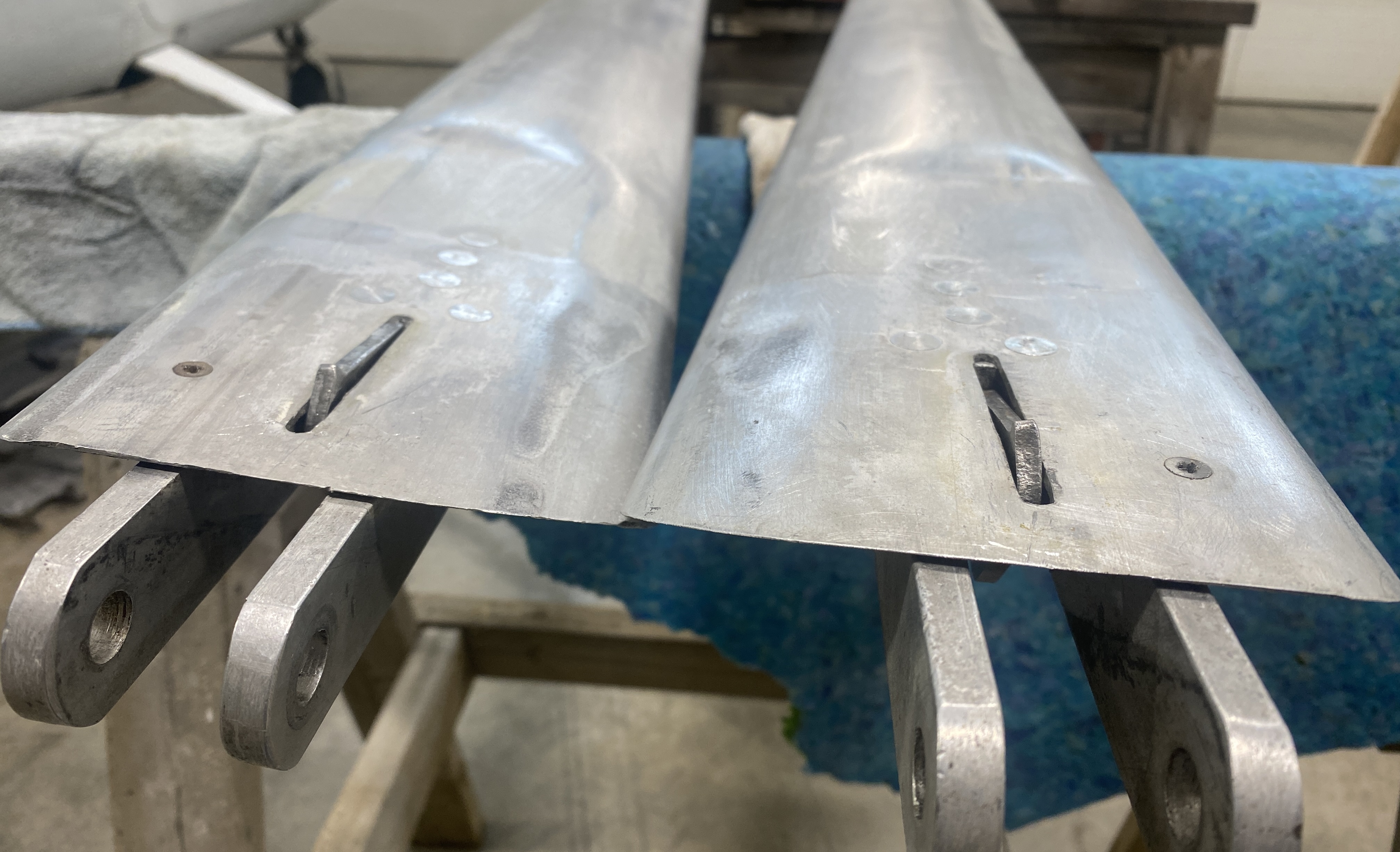

Old post so hopefully someone is watching.
I’m trying to figure out how they ever got these springs in position. Anyone have a video or instructions.
I did pay the $40 each and don’t want to see these springs get loose and disappear when they get a chance to escape.
I’m going to try posting a picture.

Re: Cessna tied down ring retract spring replacement
Another

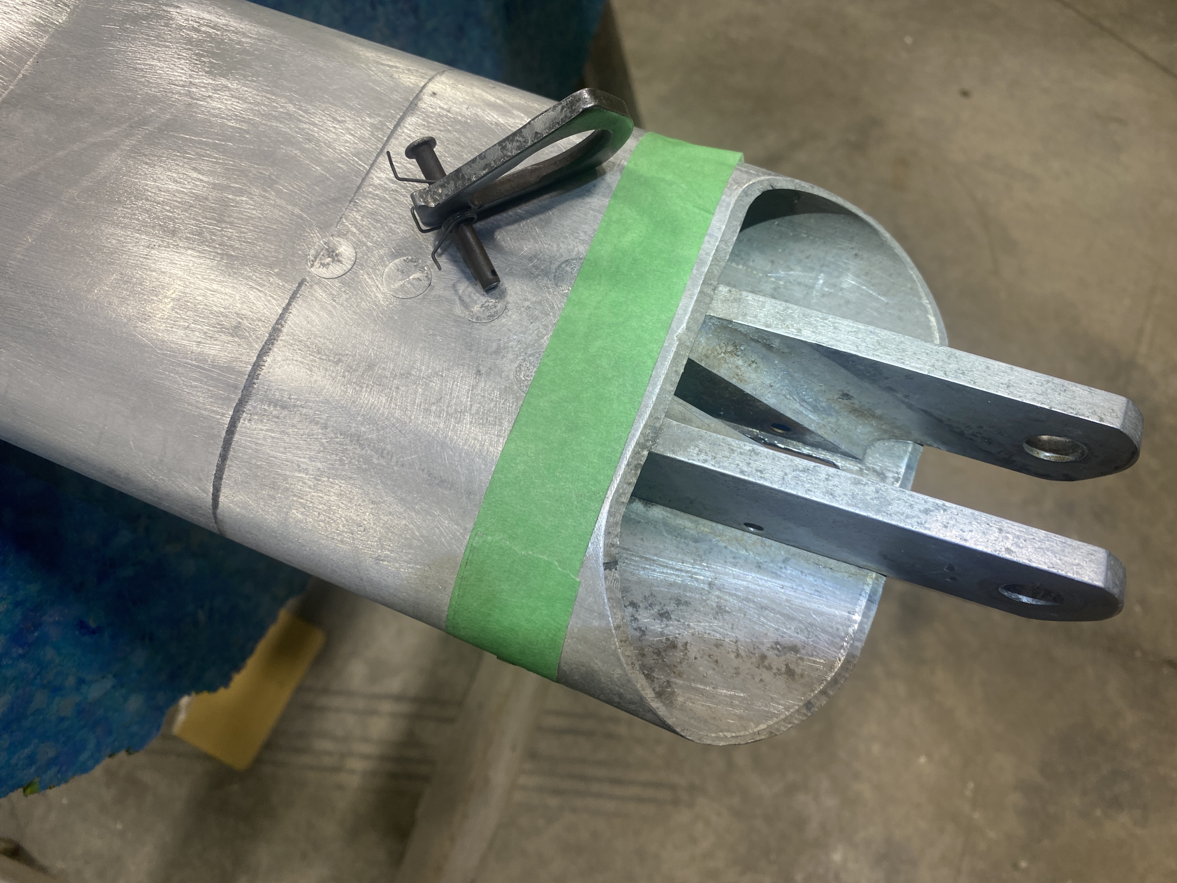

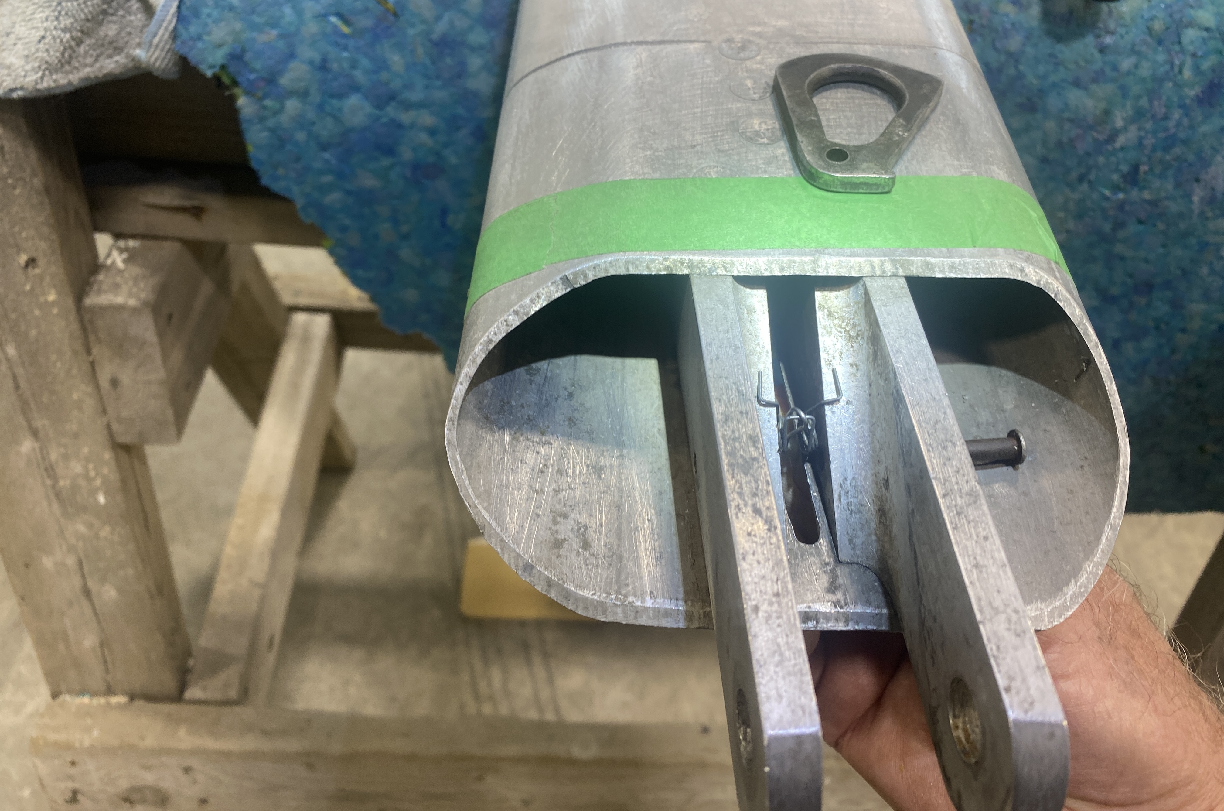

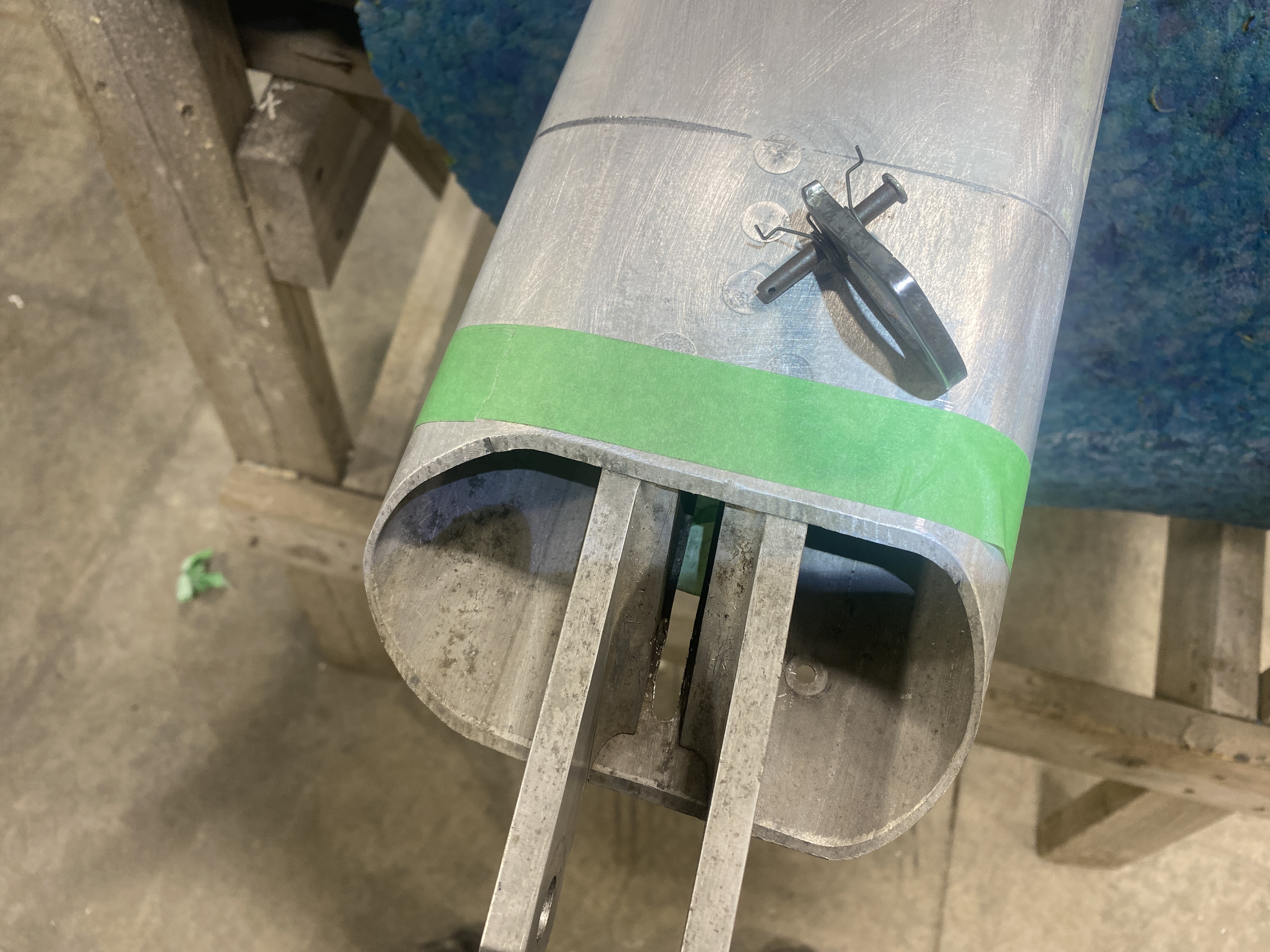

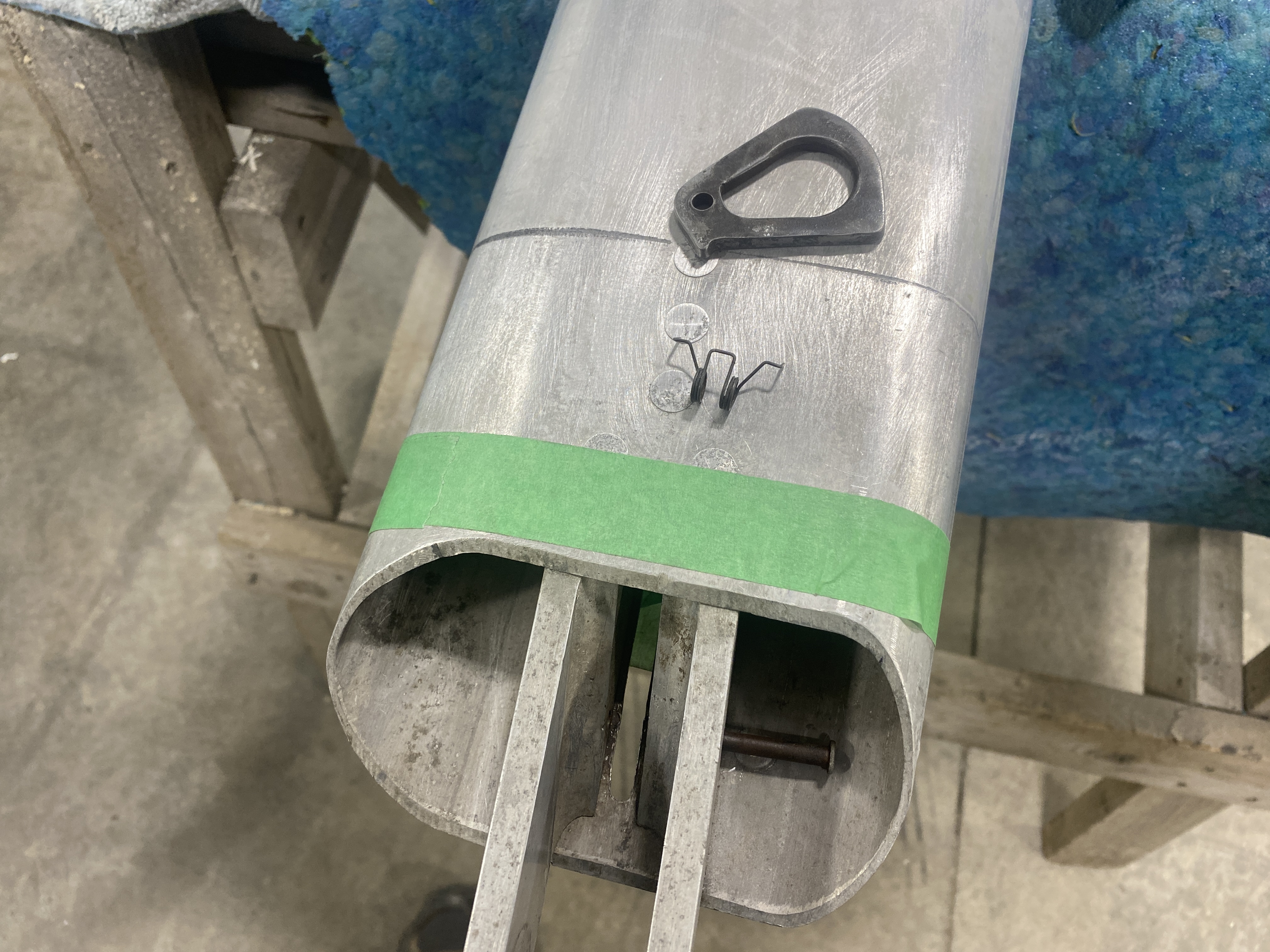

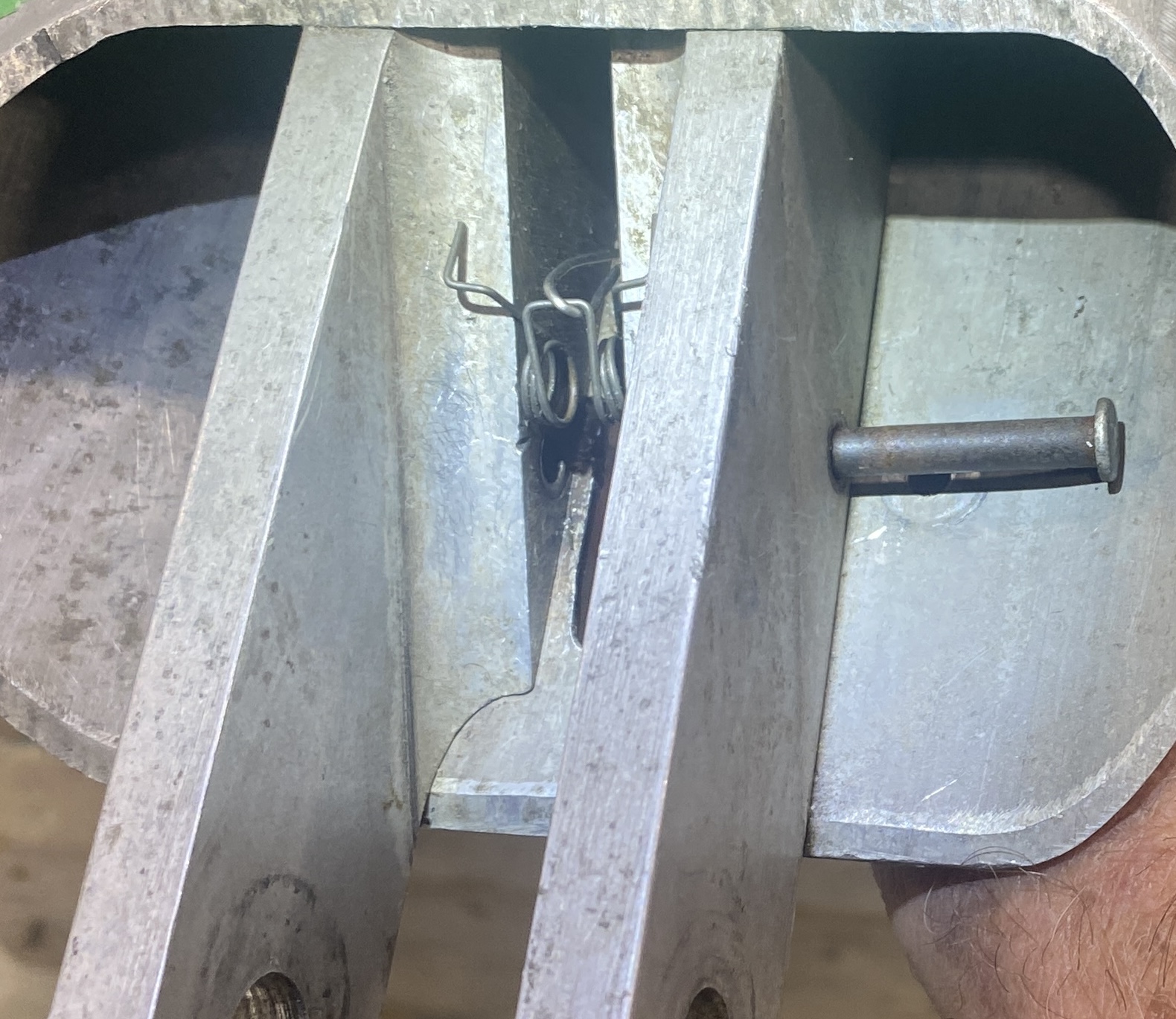

I’m holding the return spring in position with a bit of lock wire.
From where it is the spring has to torque about 3/4 of a circle to grab the tie down anchor.
That seems like a ridiculous amount of torque, so I’m thinking it is wrong.
But … this cranking the spring up, I could also flip the spring around and torque it just as badly in the unwind direction.
No information on which way this fits.
Ha! I figured out that the spring bar fits inside the tie down ring, not pushing on the outside of the ring but lifting on the inside.
Easy peasy after that, but took a few days thinking and messing around to get it.
