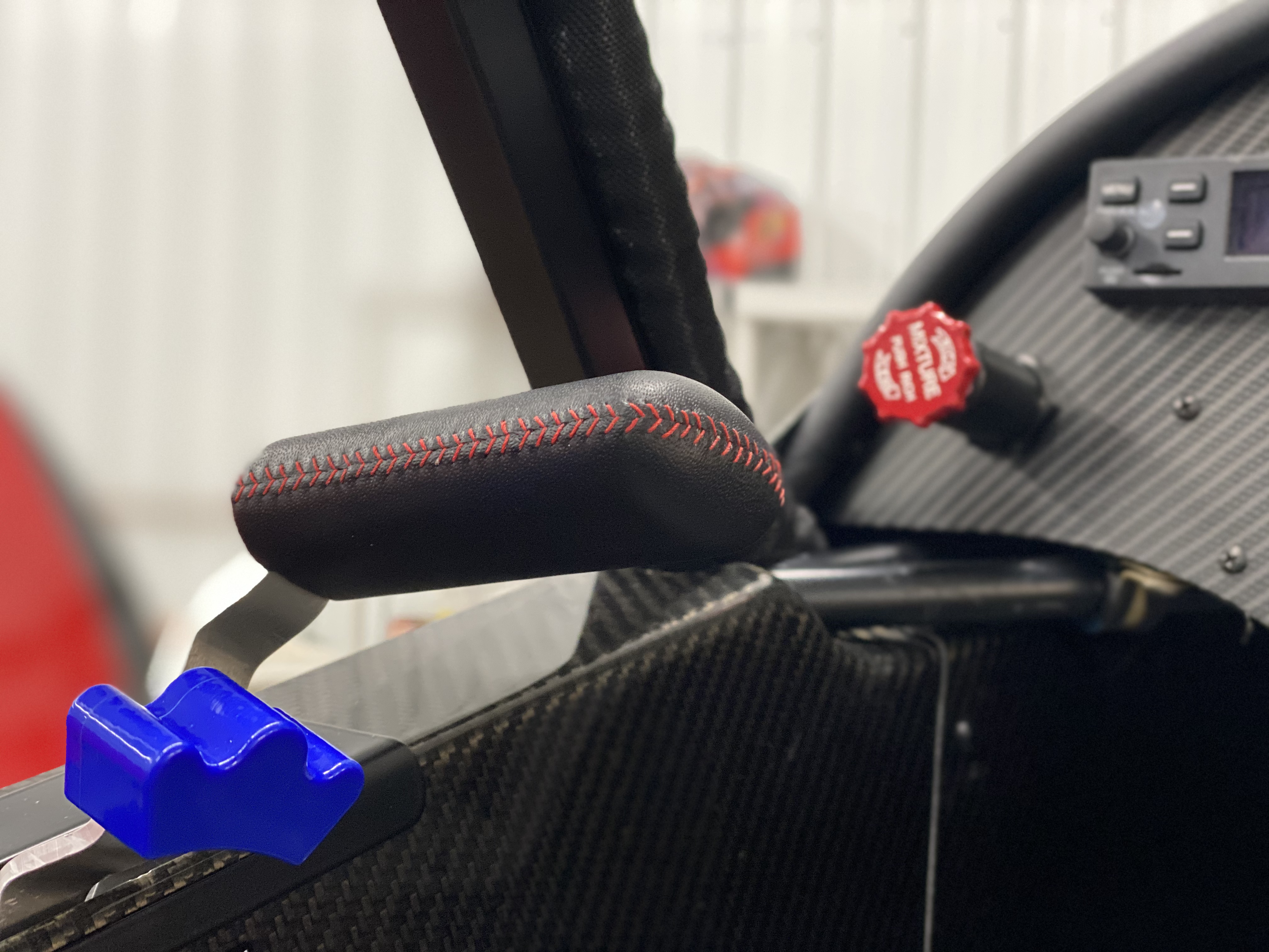

Yep Larry over at Saircorp is great to deal with - just did mine:

Larry just covered and stitched my throttle. Awesome place.
