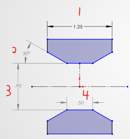

New member here! I am looking for the dimensions of the metal conical mount that is cast into some Lycoming engines. It looks like an inverted hour glass, with 2 back-to-back cups, ready to accept 2 rubber cones. I think it has a 1" through hole and a 30° cone...I think. Anyone know what the flat-to-flat thickness of the mount is? Or any other dimensions?
I am making custom motor mounts, and I ordered the rubber cones (I got the softer ones from aircraft spruce) but I can't find what the dimensions of the receiver should be to accept them.

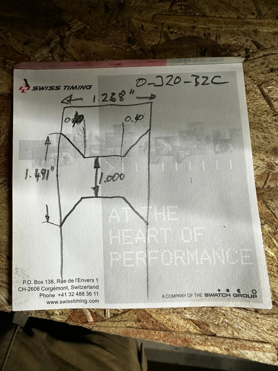

I have a O-320 sitting in my hangar I could examine for you.

I just measured an O320-B2C that i have in my shop.
The machining looks like it has been sanded to take all of the
sharp machined edges off, so it is hard to get accurate dimensions with a caliper, but this is what I got. Im guessing that was to avoid damaging the rubber. Looks like this on all four holes from two engines (both low time first run)
