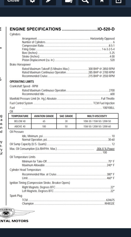

This is for a conti IO520D, but should be about the same for your engine I’d imagine
Seems you’re well within margins
For me I like to know where my engine likes to run and judge things from there, but also keep in mind those normal for YOUR engine obviously may change when you do a alteration to the engine
Taxi after flying, hot and now thinner oil, slower RPM for the RPM driven oil pump, yeah those numbers are going to be lower than cruise flight or the initial taxi after cold dark cockpit engine start
If it’s not burning more oil than normal, doesn’t smell like burnt oil, isn’t making odd noises or vibrations and if performing per the book numbers and passing run up checks, I don’t think you have anything to worry about
