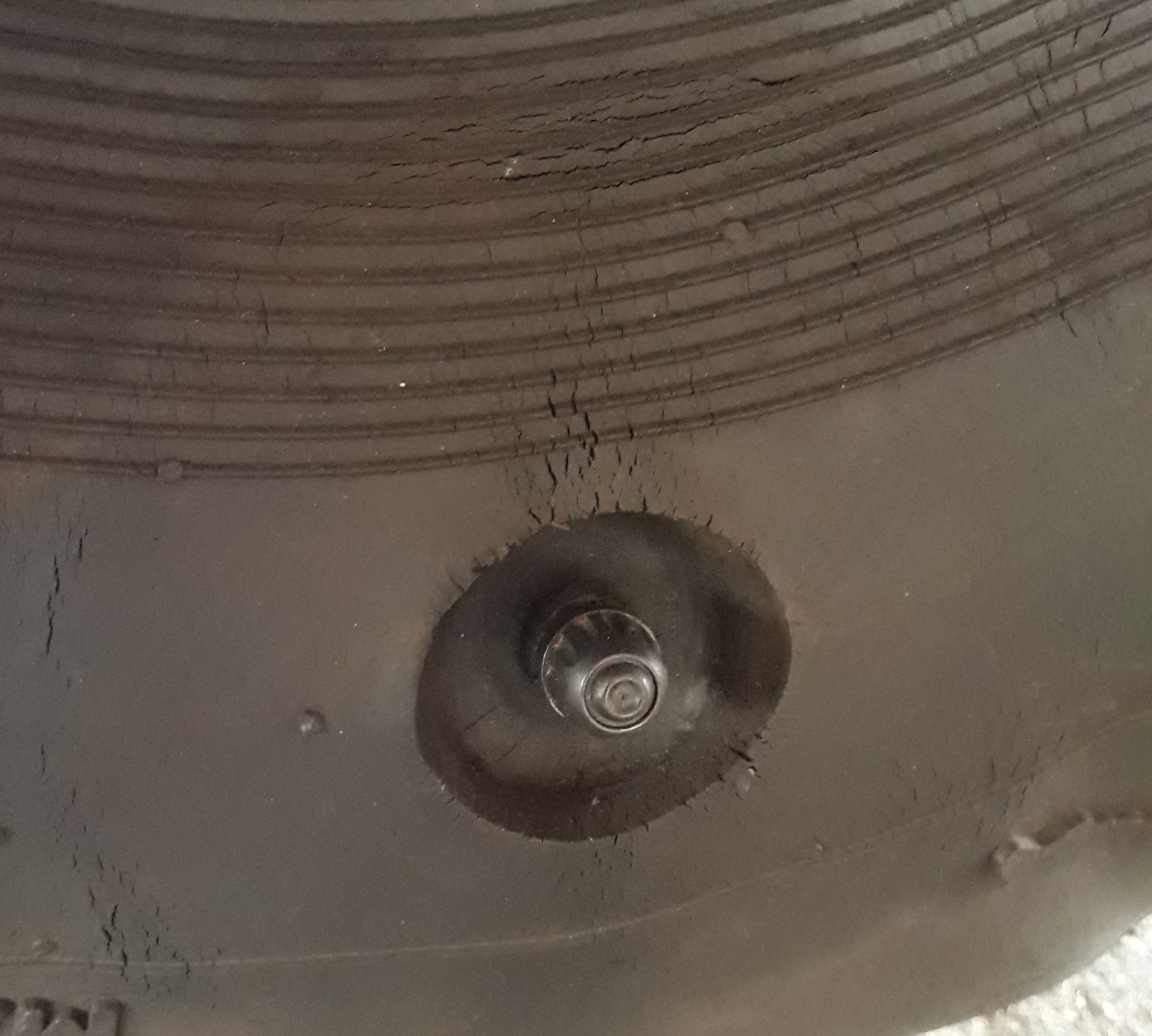

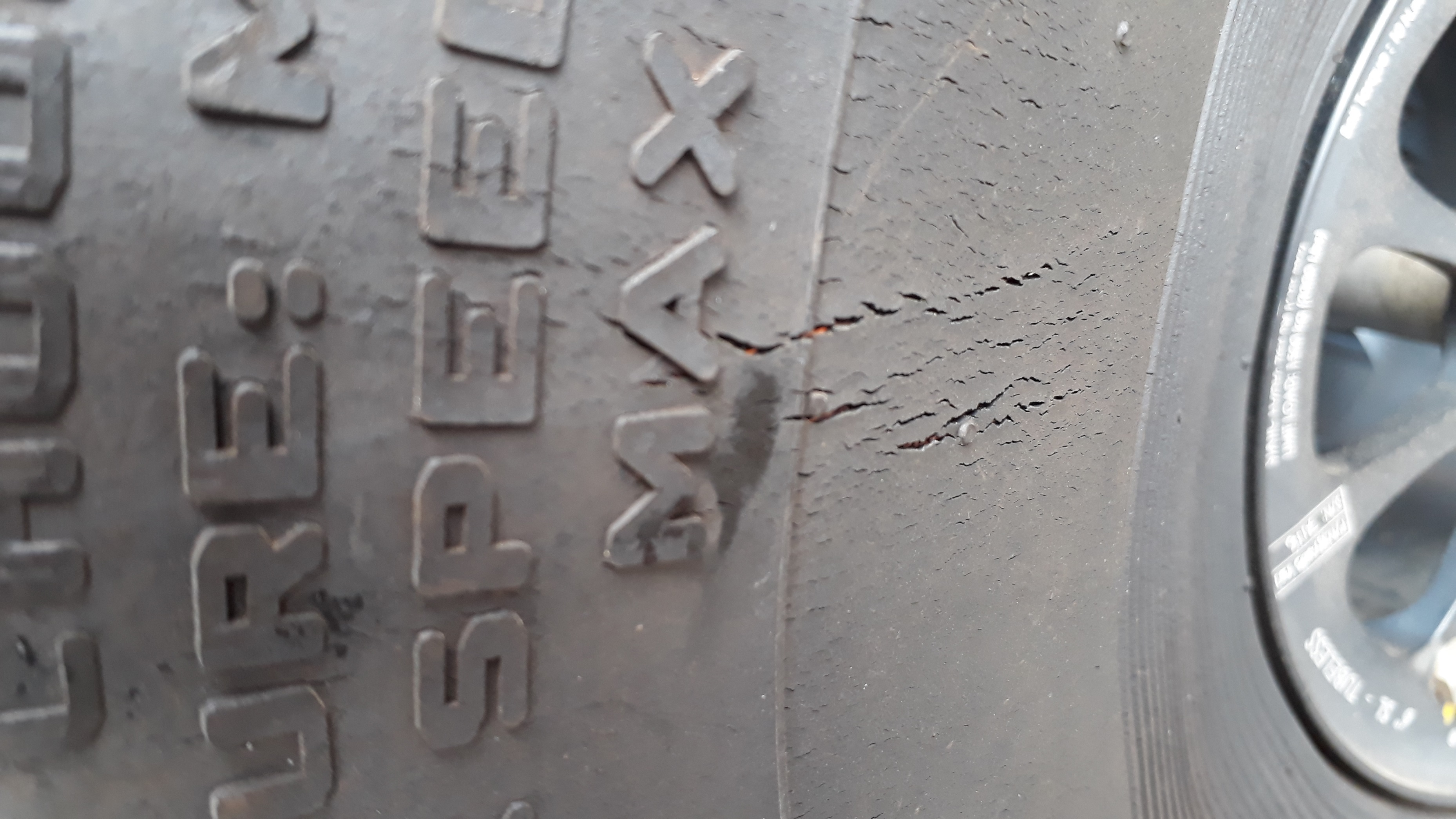

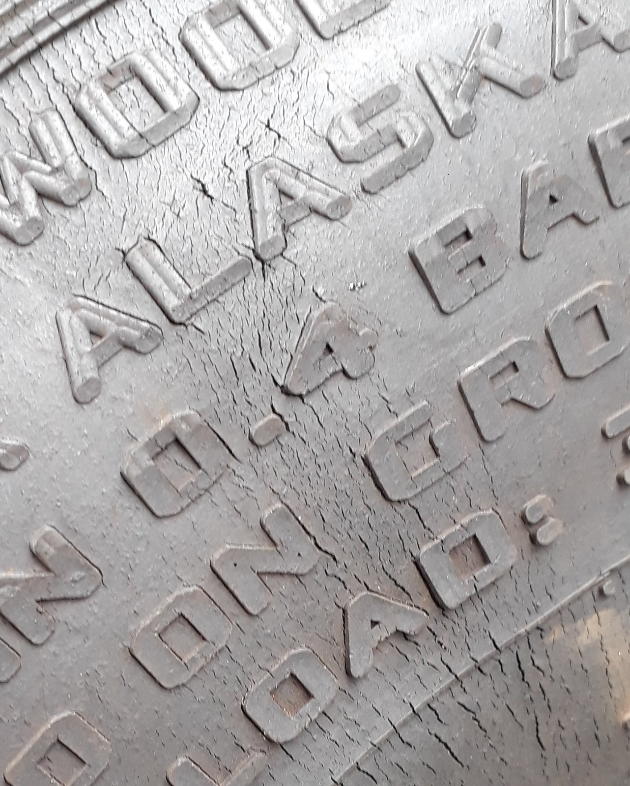

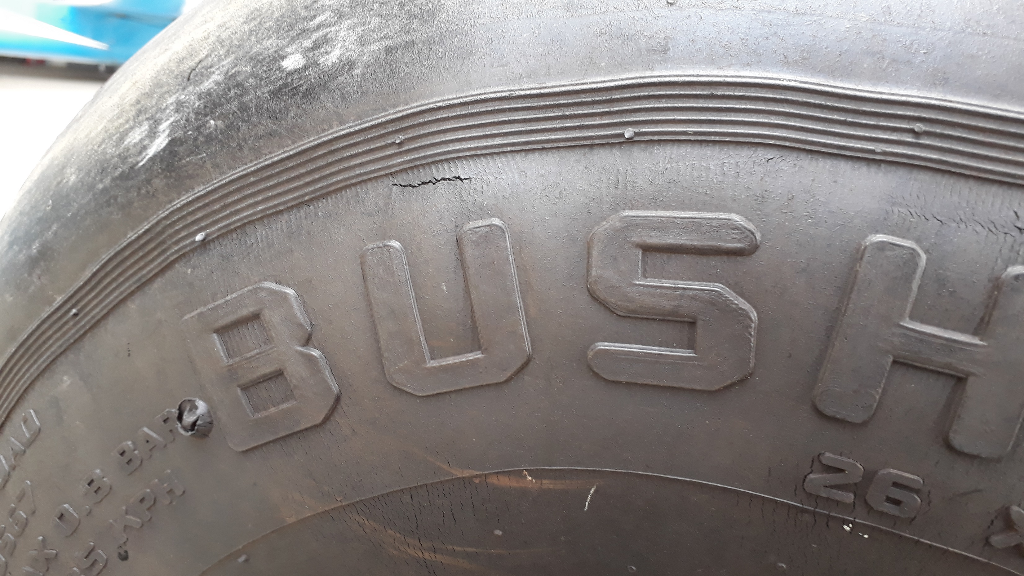

Hello Backcountry frieds,
One and half year ago I bought 26" Ultralight Bushwheel (Airframe alaska)
No I find lot of damaged/cracked on both tires. (see atached files). Somewhere you can see red, underlying fabric.
Both tire are 1,5 year old. Plane stay in hangar. We fly aprox. 30-40h per year with this plane and we use 99% grass / earthen surface (no asphalt). We use pressure aprox 0,6-0,7 bar = >aprox 8,5 – 10 psi
I know, that is In my opinion, degradation of tire surface is too fast. It´s look like 10-15 years old. I have a comparison with other tires and I have never seen this. ( I have been flying for 20 years with 7000 hours on airplane)
What is your opinion? Do you have same or similar experiences?
Thanks!

Have you contacted the company yet?
In my experience, they have very good customer support.
That should be first step.
Re: cracks on Alaskan bush tire
They can do what you have experienced. Some get worse sooner than others. There's no excuse with today's manufacturing process to have that happen, but the company's explanation and help may be beneficial. Give them an opportunity to reply.
Some cover the tires when outdoors. Indoors there are things described int this document that can make their rubber products deteriorate: http://www.airframesalaska.com/v/vspfil ... CA-AML.pdf
Contact the manufacturer and ask for an explanation and relief. In the meantime in my opinion for the expense involved there's no reason it should happen. Billions of automotive tires are proof it can be avoided.
Please share with us their response.

If I'm not mistaken, these tires are sensitive to UV light, and storing the airplane outside in the sun will do this to the tires.

Wup told me to use this stuff a few years ago, even for hangared aircraft:
https://amzn.to/2Retr0o
That 303 Protectant has been around for a long time. It was used by rubber boat manufacturers like Zodiac and Metzeler to prolong their life. I used it on an older set of Bushwheels but they finally cracked.
My current 26" Airstreaks didn't last a year before cracking...first noticed on the bottom where they contacted grass and dirt. Now it's spread over the remainder of the carcass.
The manufacturer must have a valid reason for the problem not being corrected during build-up. They told me to cover them and I told them for $2000 they could cover them with a warranty like any other quality tire manufacturer.
If decades old Goodyear 25x11x4" can hold up then it begs the question about the rubber and manufacturing techniques used for their replacement from Airframes.
I had the current 26" Goodyear "Blimp" tires for a few years and they never showed signs of weathering. Something's not right about this issue but so far they're the main game in town.

Well, I think it's a trade-off.
Tires in both the automotive world and aviation that are high performance tend to have more desirable characteristics, but they don't last as long.
Your high performance auto tire is soft rubber, and is really sticky.
Your high performance bush tire is soft and stretchy, so it can mold itself to the terrain and absorb bumps.
Your "high mileage" auto and aviation tires tend to be a harder compound of rubber and tend to be stiff and noisy, but, they last a long time.
I think it all comes down to the chemistry / materials of the tires.

This happened to a friend of mine, he had 29's. Very little pavement use with no tight turns and only a few years old. Big crack opened up width wise from sidewall to sidewall. When he called and emailed pictures they seemed to not care, they were of the attitude of "oh sorry, bummer". We were amazed at the lack of concern or explanation other than "hmmm, interesting" thats about all they had to say. They did offer him $100 off a replacement tire if he was interested. I was shocked at their response, I did not expect that out of them. He is running 8:50's now.

Savage, that seems kinda fast to have weather checking that bad, usually takes about 3 years for mine to get to that point. As an aside, I think your post seems cordial and valid.
Owned 7 sets of bushwheels, only one set failed from wearing into the chord after 800 hours. 5 sets failed from weather checking, the other set is brand new and are on the wagon now. These have all been 29 and 31's, I will continue to use them, unless something better comes along. Average about 700 hours per set of tires on the wagon iirc, and longer on the cub.
ABW are fantastic tires, but severe weather checking has been the biggest weak link in my experience. I primarily operate in the Chihuahuan desert, so despite routine application of 303 and mostly keeping them in the shade, the tires just get eaten up by the dry air. This go round, I sprung for the $200 covers they sell, which fit great and stow nicely in the small stuff sack they come with.

I would like to share my experience with customer support of tire manufacturer - Airframe alaska.
Communication with the European dealer was without success.
But approach and response of US headquarters was absolutely different. They responded within a few hours and were very interested in my problem. I sent them all the information about the tire, photos and the operation spectrum and during one or two day I received info, that this issue is covered by a warranty and they send me new tires.
I have to praise the professionalism of the US airframe alaska team!
