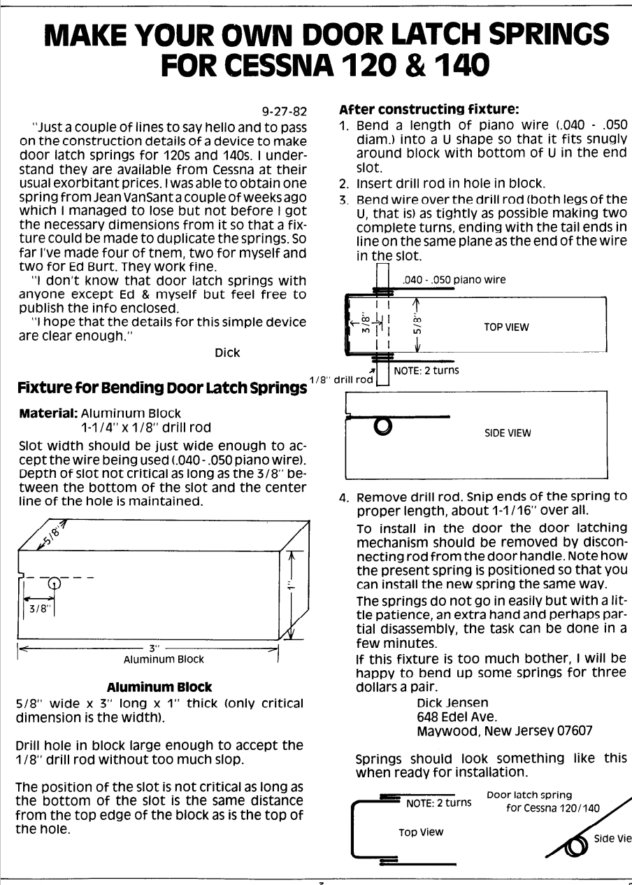

Years ago, someone in the 120/140 Assn provided instructions on making a jig for bending up your own mosuetrap springs from music wire.
I made a jig, made a few springs (which worked only so-so), but gave away the jig when I sold my 170.
I asked the guy I gave it to, to see if he could find it.
He found it & will be giving it back to me, I'll post a pic when he does.

hotrod180 wrote: Years ago, someone in the 120/140 Assn provided instructions on making a jig for bending up your own mousetrap springs from music wire.... .
Here's the pic.
The wood is .645" thick.
I used .032 music wire.
An 1/8" drill bit goes in the hole,
You put the wire in the saw-slot, wrap it around both sides of the wood,
take two turns around the drill bit, and cut the tails off at 1-1/16".
The springs I made for my 170 weren't all that satisfactory,
but they were better than the broken springs they replaced.
Posts: 10540
Re: Door latch mousetrap spring
Here ya go....

dsbur wrote: Here ya go....
Yes, that's what I used when I made my jig.
Thanks for posting.
