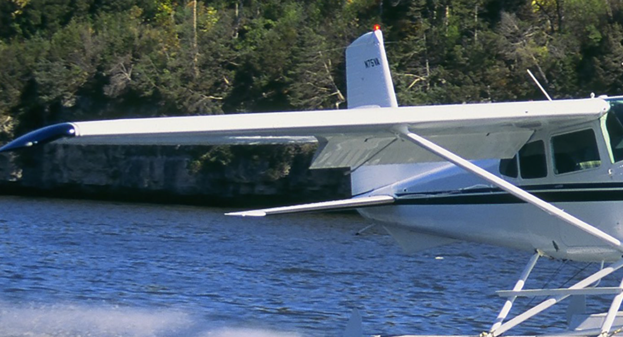

And yes 'beefier' they got with age. Every skin facing up on the wing has a different part number than late model planes. That is not coincidental, they are thinner. And yes they will crack if you treat it like a later plane. Your own gear legs are astonishingly heavier than what came on it, I respect Glidergeek greatly, but if I had 185 legs on a '50's 180 and someone wanted to swap me an original set, I'd be all over it. All that extra baggage way up front fighting the sweet spot in my CG [-X . More so if they were a set off an original '53, which were set back ~3".
Here's one not even most good Cessna mechanics don't catch. Roll your ailerons out of the way so you can see the flap or aileron ribs. Now do it on a late model plane.... All those lightening holes probably don't make a pound of difference, but it alll adds up.
Lots of love out there for late model 180's. Personally, if I worked one, I'd take an early 185 over a late 180 every time. As it is, I don't, I'm a bush beating wannabe, who loves a 4 place plane I can stick into cub spots, and that commands keeping it as light as possible while not completely ditching a few creature comforts.
My '53 and a random internet grab, looks at the flaps;
Take care, Rob
