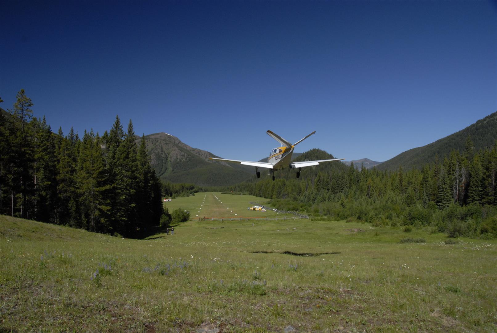

I have the 550 in my S35. I also have a 58 182A. Bonanza outperforms the 182 in all aspects except the 182 gets off the ground in about 10-15% less runway with the same load. Same load means my Bo is about 180 pounds heavier than my 182. The Bo is so much nicer to fly. I am at 2000 pounds empty so 1400 useful vs 825 useful on the 182. Landing at Schafer.

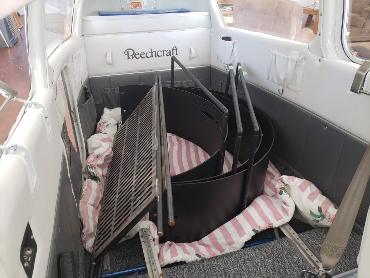

Can the Beech fit long guns and archery gear?
DJ Balla offline
Posts: 78
Joined: Fri Oct 19, 2018 11:31 am
Location: Apex
Re: Early Beechcraft Debonair
DJ Balla wrote:Can the Beech fit long guns and archery gear?
I carried 8 foot 2x6's in mine this past summer to take up to Meadow Creek.
And a couple hundred pounds of fire pits for Schafer.
