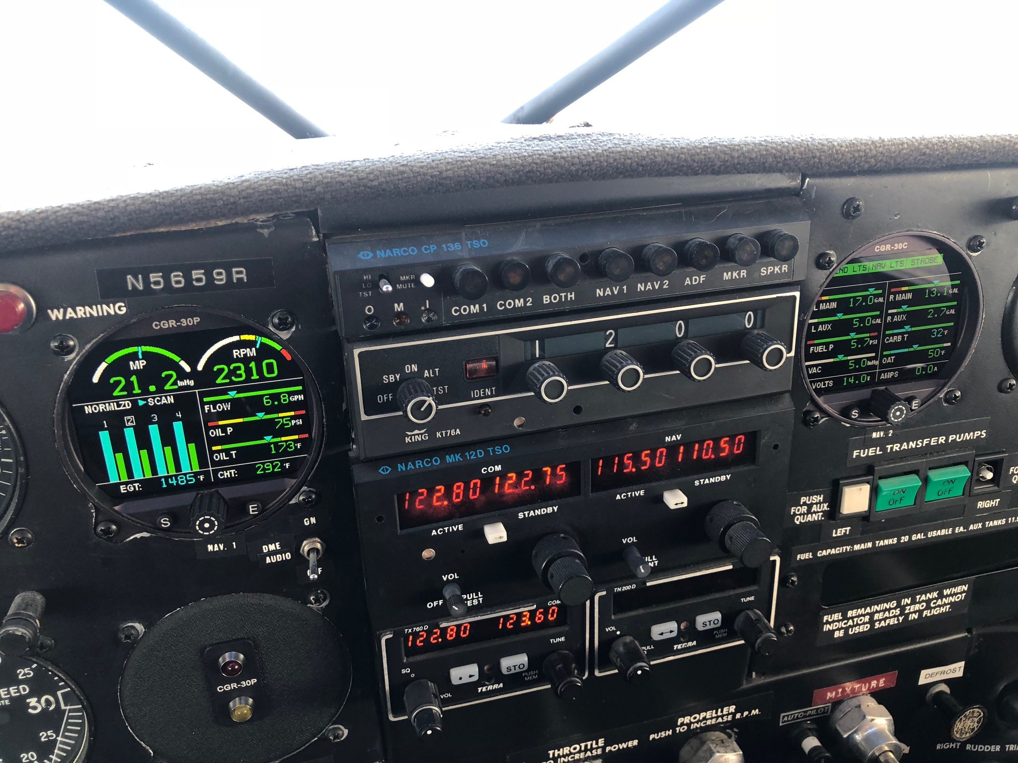

I also just had the CGR-30P/30C combo installed. Install was 38 hours and some of that time was removing the ADF, VOR, original gauges and making block off plates to clean up the panel. I only have about 5 hours on it but so far I am impressed. Easy to read in all light conditions. Considering the 1k rebate, I'd do it again. After never having a good engine monitor, I know I'll never have a plane without one again.
CGR Combo
