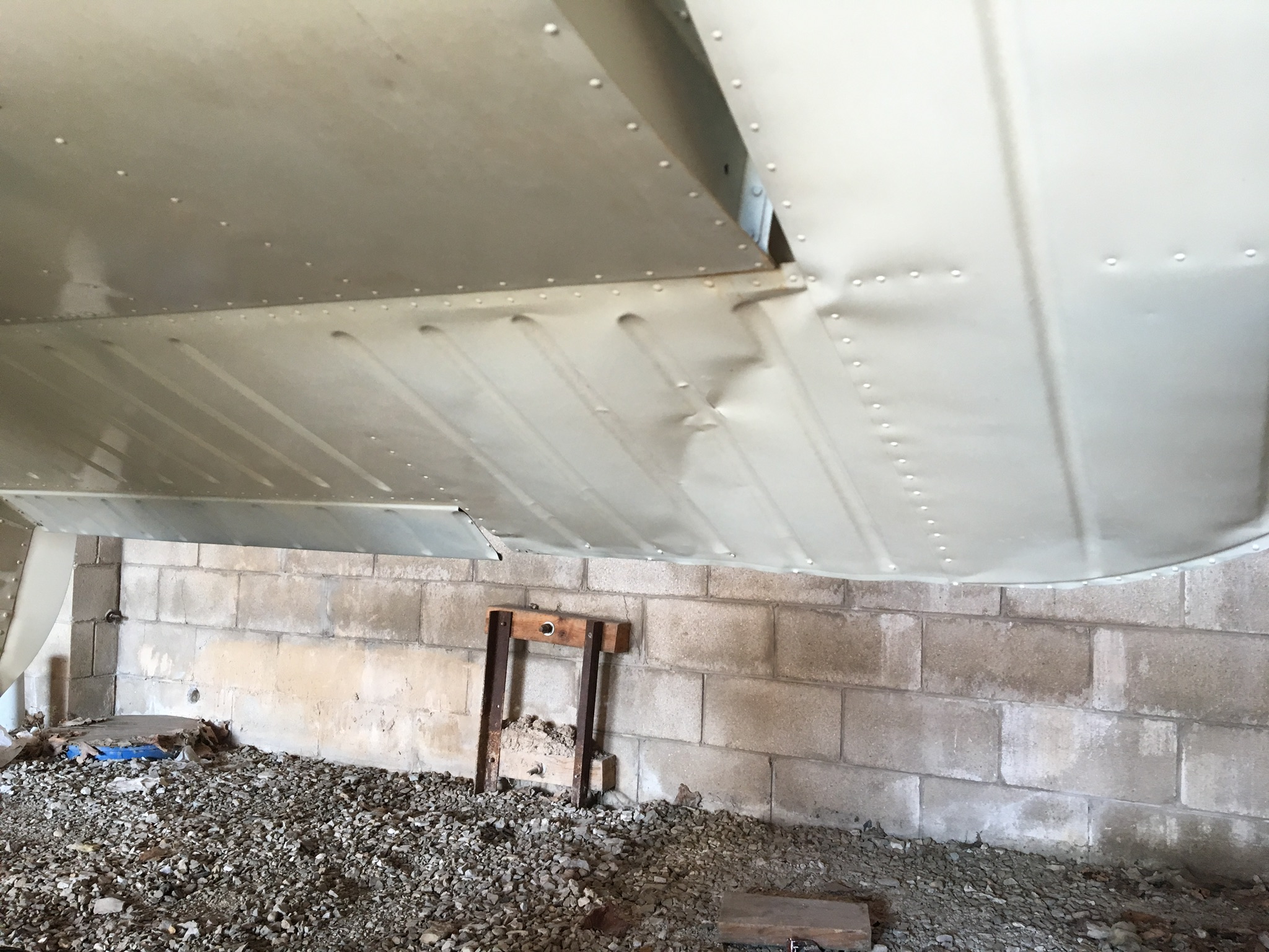

I'm looking for a reputable place to fix a sizable dent on my Stinson 108-1.
I contacted Airframe Components in Indiana, and they don't have a jig for the Stinson.
Any ideas?

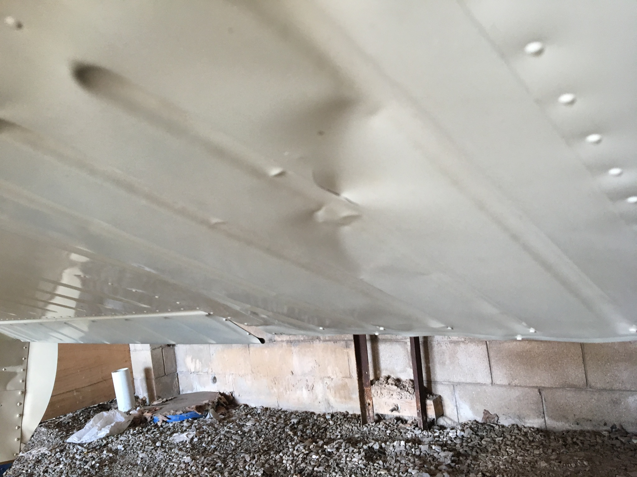

Those skins are not produced new anywhere that I know of. I was working on doing so, but the market is very limited, you get to deal with an ever increasing heavy handed FAA, and it's a bunch of stages to hydropress and heat treat them, so I abandoned that project.
That being said, there are used ones floating around. I know that Univair produces the rudder skins in the same corrugated style as a Cessna...but not sure if they offer elevator skins as well. If you buy from them, you're on your own as far as quality.
It also looks like you're going to need a new spar from what I see. You'll know once you're in there, but from the one picture, it looks like it's damaged.
You might be better off just replacing the whole elevator. I'd try Earl Allen in California...he's most likely got a room full of them for a bunch less than you're going to have into trying to repair this one.
