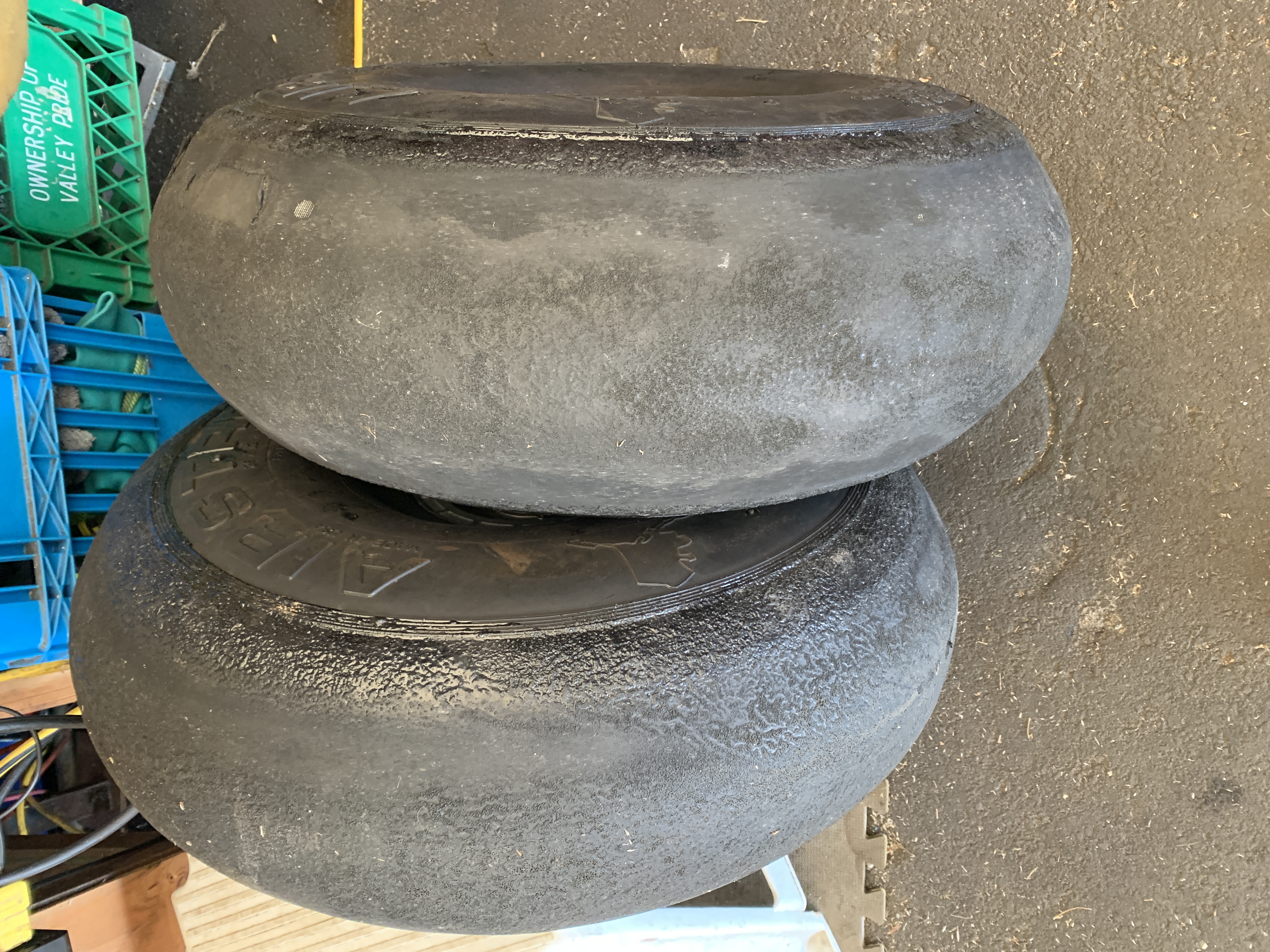

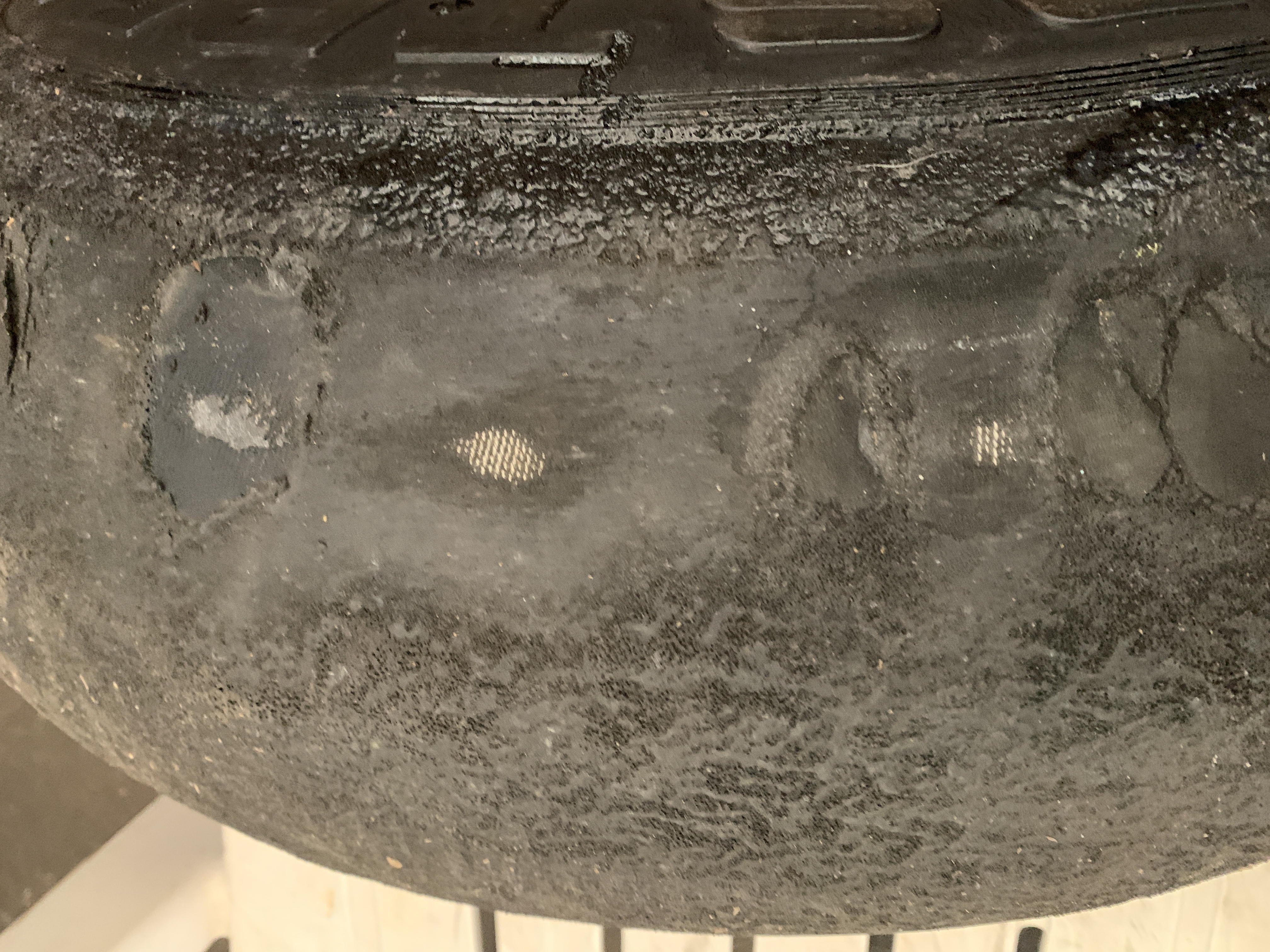

Sucks to operate from a paved airport, even often switching to mounted 8:50 when the fat stuff wasn't required. 7 years, and got the quarter-sized tread patches showing through. Herculiner last few years didn't save them. I flipped them side to side but never tried putting the valve stem on the inside.
Any market for worn ABW? Ultralight guys or hobby vulcanizers?

Tough lesson here. The bushwheels need to be periodically rotated on the wheels. Not simply moved to the opposite side.

Regular bushwheels that have cords showing can sell for $500-1000 depending on age on other condition factors; weather checking, etc. If any cords are worn though then the tires are garbage. I'd assume Airstreaks would be worth something less since they are cheaper new. Tires that have some kind of recoating treatment that is worn out would be worth less since that old coating would need to be dealt with.
It sounds like the bed liner gave you a few extra years so I'd say it worked. Re-coat and flip the the tires on the wheels and you should be good to go for another year or so.

lefoy84 wrote:How does one “correctly” rotate them?
Look at the first picture in the first post. See how the wear is on just one side of the tire? Now ask yourself what you’d need to do to get the tire to wear on the opposite side.

You have to remove them from the wheels, remount opposite. A PITA, unless like me, you're putting 600s on prior to the seasonal wheel ski install.

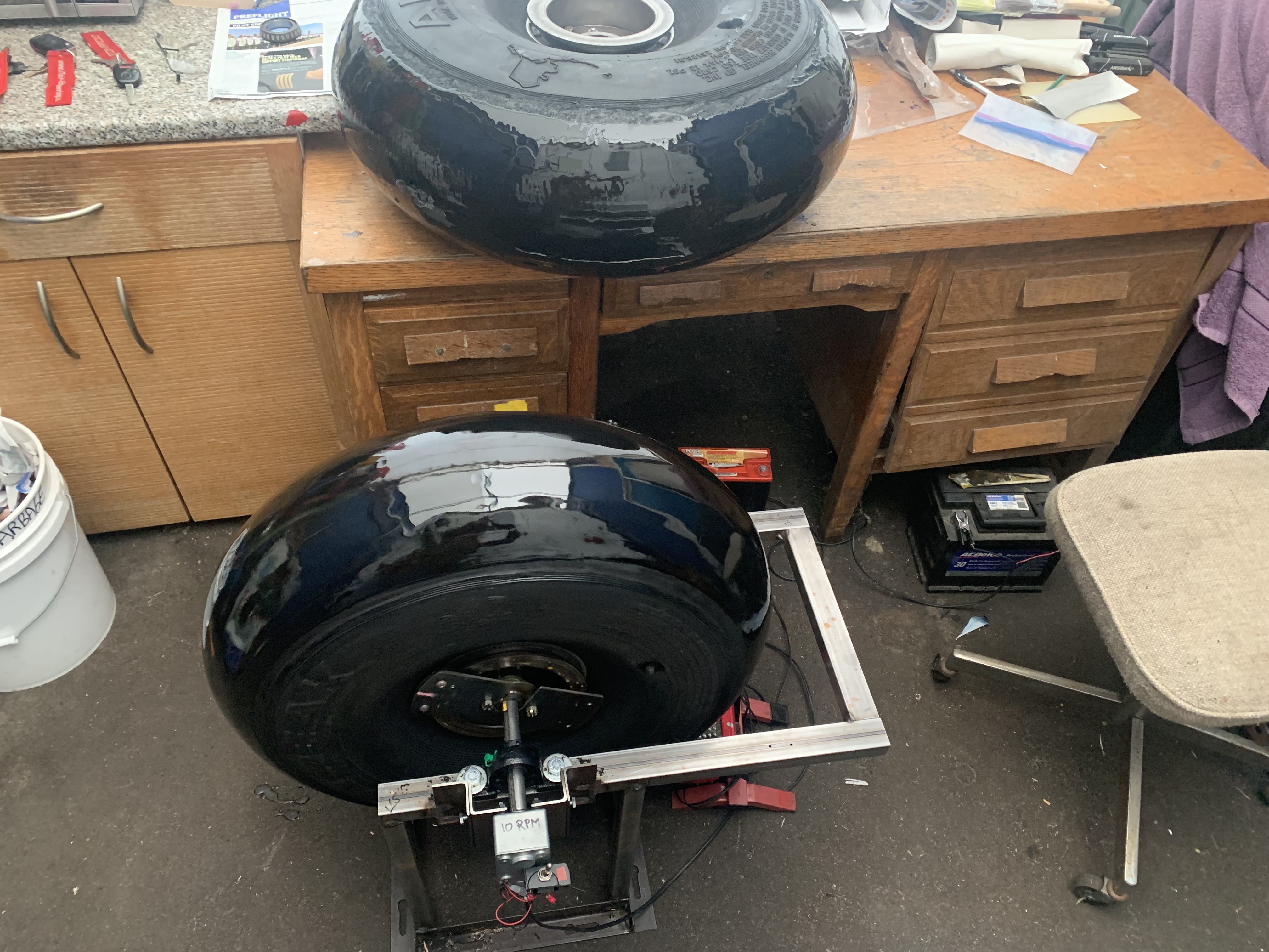

Parts list:
Devcon FL20 primer, 4oz, enough for two tires. $40.
Devcon Flexane 80 15800, 1 lb (500g) per tire. I would have done 2 but I wanted to proof it before I buy another 2 lbs. Each kit has the two parts you mix together, a mixing stick, and a mixing container. About $100/lb.
Built the rotisserie using a 12v 10rpm reversible motor. $40 on Amazon. Some square tubing and some old bed frame angle iron, used a spare axle through a rod held to the frame with a couple of pillow blocks ($12 each).
Bought some 60 grit discs for my angle grinder to "prep" the tire and clean most of the remaining Herculiner off. $10. We'll see how it goes, so far so good.
What else? Took advice from this thread and reversed the tires on the wheel so that the valve stem is on the inside.
Somebody asked about gross weight, 1650, Airstreaks are good to 1700.
