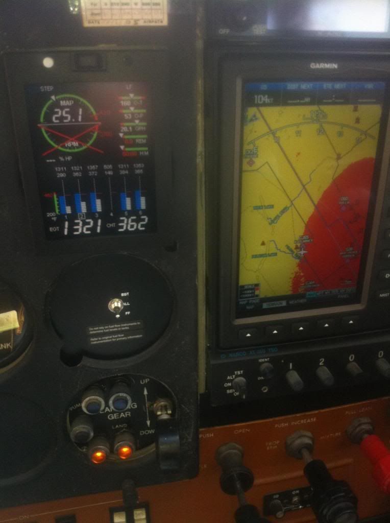

Taxi
Sorry I didn't get rpm working yet but prob around 1500

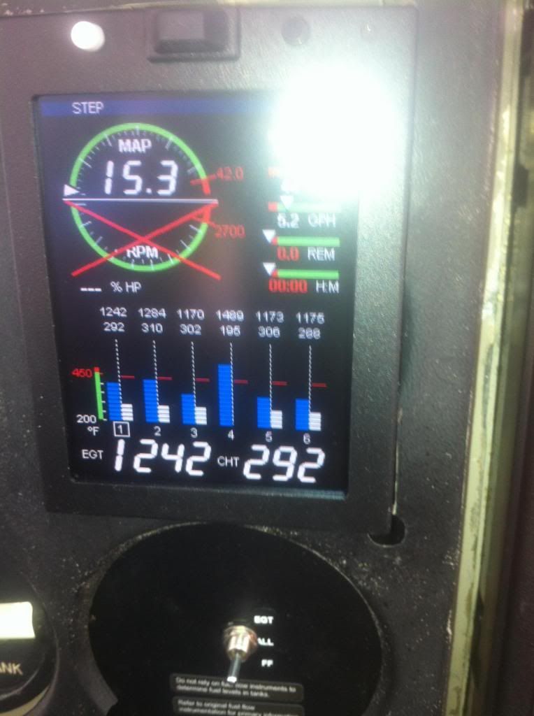

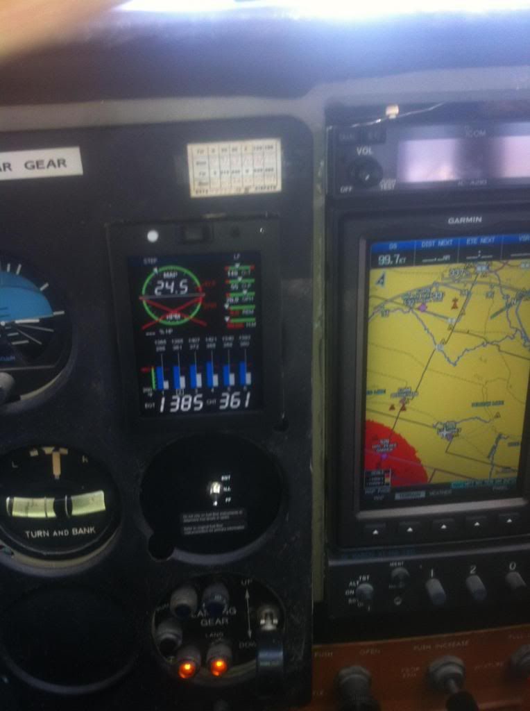

Flying
Rpm 2500
Io 550 on 185 first flight after winter storage in heated hanger. 95 hr tt since factory new.
Any guesses ..number 4 in flight reads 505 degrees egt and 140 cht.

Stuffed probes / damaged wiring? The thermocouple wires are different to regular wires and might have been damaged? Rodents are good at that in storage.
Maybe swap the sensors with the ones next door (if your able) and see if the reading stays with the sensors or the cylinder.

Thermocouples do go TU, but two at the same time, on the same cyl. Seems a unlikely bet. I agree with akt. That cyl is firing lean at low rpm, and not at all at high. I am betting on an injector

Yup, pull the injector and ultrasonic clean it. You should be able to see what's blocking it, often a piece of filter medium or a hair. High EGT at low rpm and cool EGT/CHT at high are the giveaway. You should also see a higher fuel flow than normal on the factory gauge. The JPI's are a neat piece of kit, should be able to see all this if you download the data
I do like the 42" MAP redline! :D

Injector it was...small piece of something in it and I had no idea my almost new engine was struggling this bad.
Rob you hit the nail on the head.
