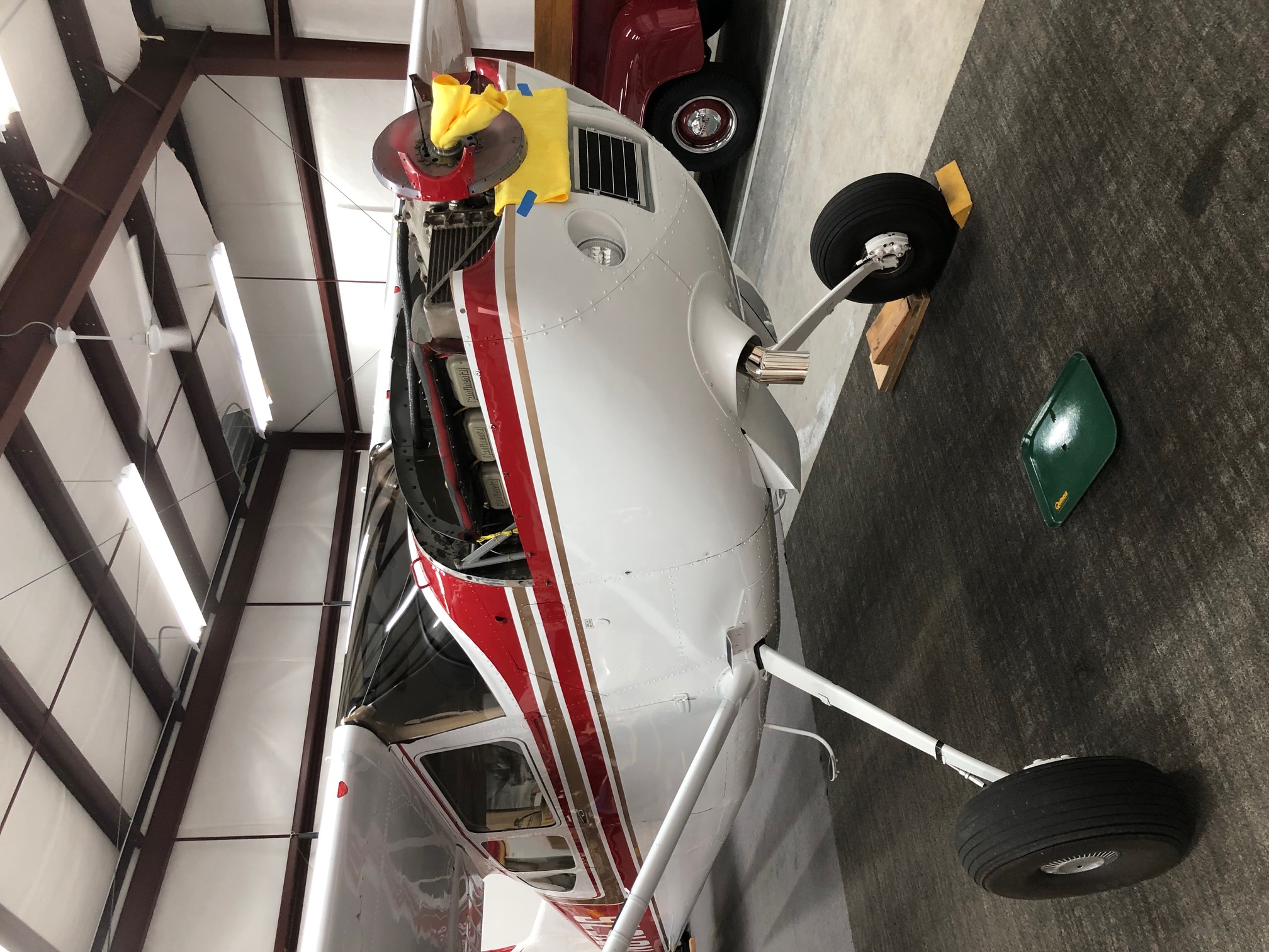

Updated Image
I posted reference the Maple Leaf fairing on or around April 6, 2021. Lowered my temps 10-15 degrees. My 2-4-6 cylinders ran hotter and the temps on those dropped. So not uniform on all Cylinders. Acorn Exhaust. O470U. Updated Image. -Bruce

Thx for the good pic Limerick. What a nice aircraft and pickup.
You mentioned that your 2-4-6 Cyl's Temp went down. Do you recall if 1-3-5 went down pretty much the same amount or if there was a different Temp drop depending on which side?
My 2-4-6/left ones are fine.. 1-3-5/right ones are about 25 hotter but still within conservative limits so I would consider putting the exhaust fairing only if it would help lowering these last ones more.
The fairing looks very nice.
