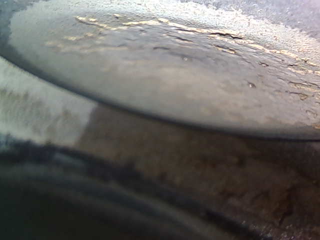

Re: Exhaust Valve Leak on a P Ponk & options
Here are a few pics
Valve leak? Ever seen that color?

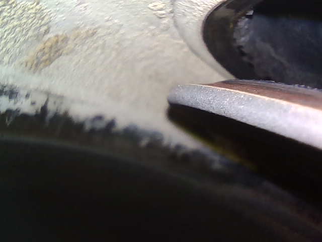

Another shot of the exhaust valve
#2
I don't see any reason to take drastic measures with your valve..... As an IA, and also I follow Savvy, I don't see a reason to take a cylinder off yet..... There may be some blowby, buts its not a burnt valve from what I see.... IF YOU MUST feel compelled to do something, then I would recommend to take the valve cover off, and take a look at the valve springs, and maybe change the roto-cap. at $15 a-piece + labor, I start changing those around 1000-1200 hrs.
Pulling a jug, IMHO, is a last resort, reserved for a jug that is in "NO SHIT" fixing to "SHIT ITSELF". But, what do I know!
AND, your compressions are WELL above continentals concerns.
Tangogawd wrote:I don't see any reason to take drastic measures with your valve..... As an IA, and also I follow Savvy, I don't see a reason to take a cylinder off yet..... There may be some blowby, buts its not a burnt valve from what I see.... IF YOU MUST feel compelled to do something, then I would recommend to take the valve cover off, and take a look at the valve springs, and maybe change the roto-cap. at $15 a-piece + labor, I start changing those around 1000-1200 hrs.
After seeing pictures of the valve I'd agree with this for sure. I would check the springs just to ensure they aren't broken, but the valve looks good in the pictures.
