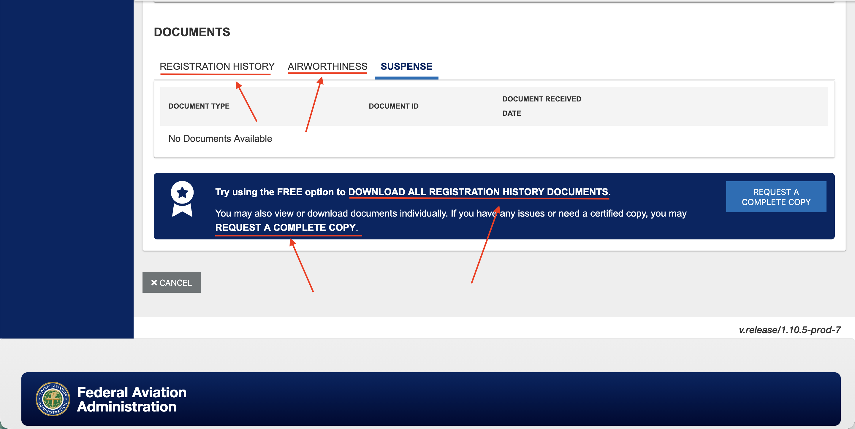

You got me thinking about this now because I just bought a plane recently and instinctively did what I always do, I requested a title search from one of the companies that has been doing this forever.
So after reading this thread I went to CARES and downloaded their info 2 ways. Individually for registration and airworthy documents, and also using the DOWNLOAD ALL REGISTRATION HISTORY DOCUMENTS.
Both downloads had the same information, so at least their system is working correctly there. Then I clicked on REQUEST A COMPLETE COPY and it opened to the typical CD request page. That's where I noticed that it has the page count of items so I went back to the downloaded files and the ones sent from the title search company and they're all the same.
So with this information I believe that :
1- paying a title company search is wasting money because they apparently just go to CARES and get what you can get online
2- paying the $10 for the CD is also a waste of money because you can get the same paperwork instantly on CARES.
So that clears up any doubt regarding using a title company vs ordering a CD vs CARES, for this type of paperwork search.
Now regarding "1. cares.faa.gov is not representative of everything on file..." part, it seems to be everything they have on file, but it doesn't help with the fact that some paperwork isn't at the FAA or in some logbooks because humans store, hide, or destroy some paperwork, so we still have to do those in depth pre-buy inspections.
My experience with the last 4 pre-buys I did since my search began about 6 months ago for my next new-to-me plane, is for another time, but please, to all who read this, do a really good pre-buy with a very knowledgeable mechanic with experience in the model you're buying. Don't settle for using any mechanic !
