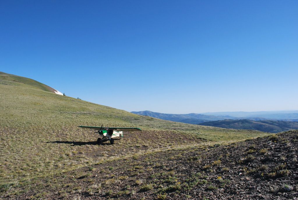

Hmmmm, I just had a 8400' mountain top landing where I definitely was coming in behind the power curve and "hanging on the prop" in order to keep my rollout as short as possible. Then when I took off I killed the engine and glided at 650 FPM and 46 MPH until I restarted at 5800'. (Rans S-7S one notch of flaps, a little slow for best glide ratio but seems to be best sink rate at that speed, at least today) So I guess I do/fly both? Does it have to be either or?ImageImage
