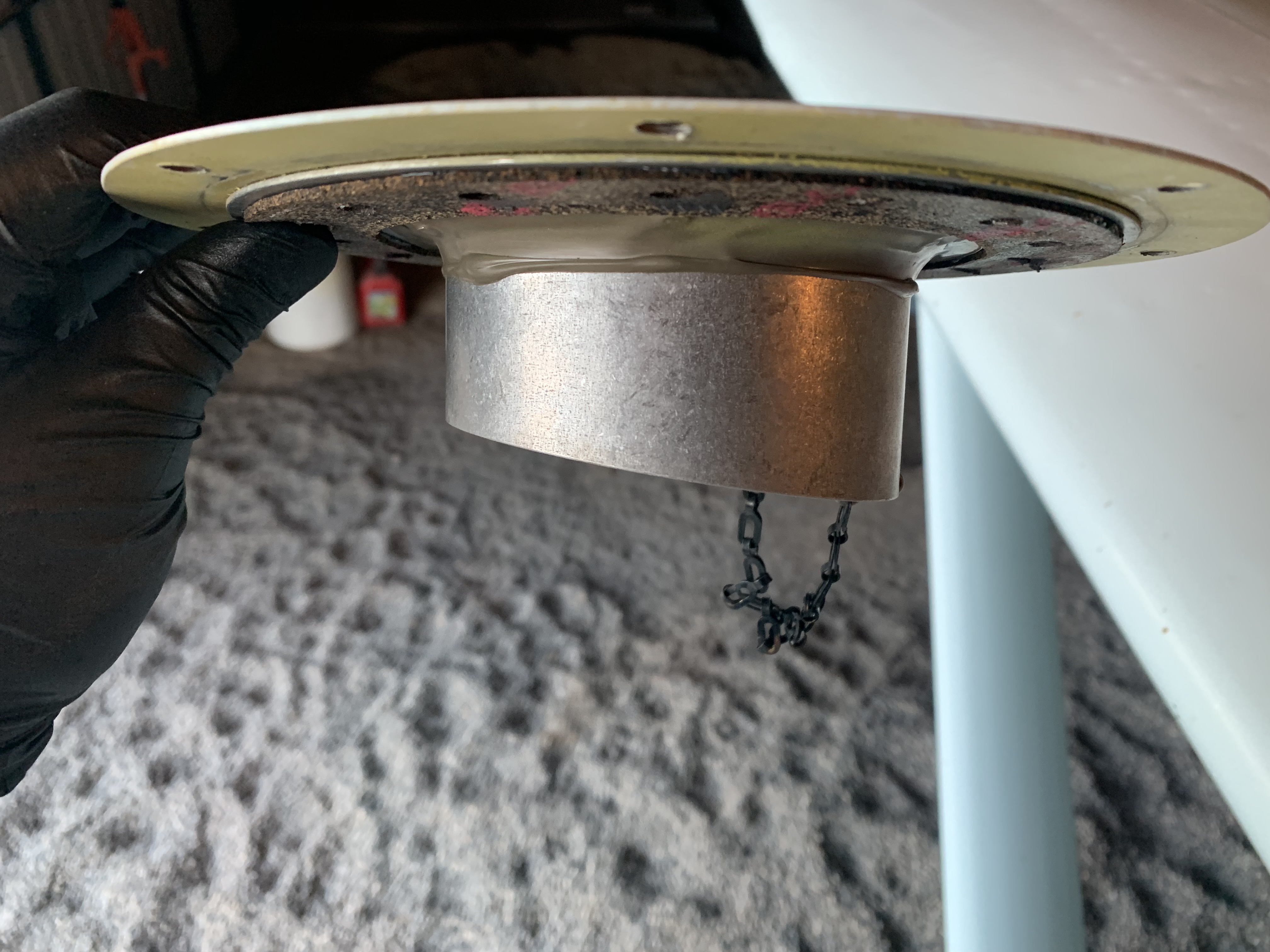

I thought I had it fixed. I flew two three hour legs on Friday and had zero trouble. The last leg on saturday I had it happen again right at 3/4 fuel indicated in both tanks. Was cruising at 11,500 MSL in smooth air. EGT's started to climb, I noticed right away because my EGT gauge is on my regular instrument scan because of all these problems, rocked the wings and boom the EGT's dropped back down. By rocking the wings I either move something away from a choke point or cleared fuel from the vent line, I can't think of anything else?
I thought I had it fixed because I found the flapper on the right tank cap was crusted shut. There are multiple issues though, because once the crusty flapper was fixed my fuel burn was now perfectly even.... but the weird leaning issue still exists.

Guys, just wanted to check back in and let you know how it's going.
I haven't had a lick of trouble since replacing both fuel caps. Whatever is going on is at least now being masked by the secondary venting from the caps.
I also found that the small aluminum vent tube that crosses the top of the tank was bowed down in the right tank, I'm wondering if this was essentially creating a liquid trap that was preventing air from venting properly. As far as I can tell, the vent air from the single vent on the left wing has to vent through that tube to the right tank. If that's an accurate assessment, I think that was the problem all along.
Either way, equal fuel burn and no issues for a few months now.
