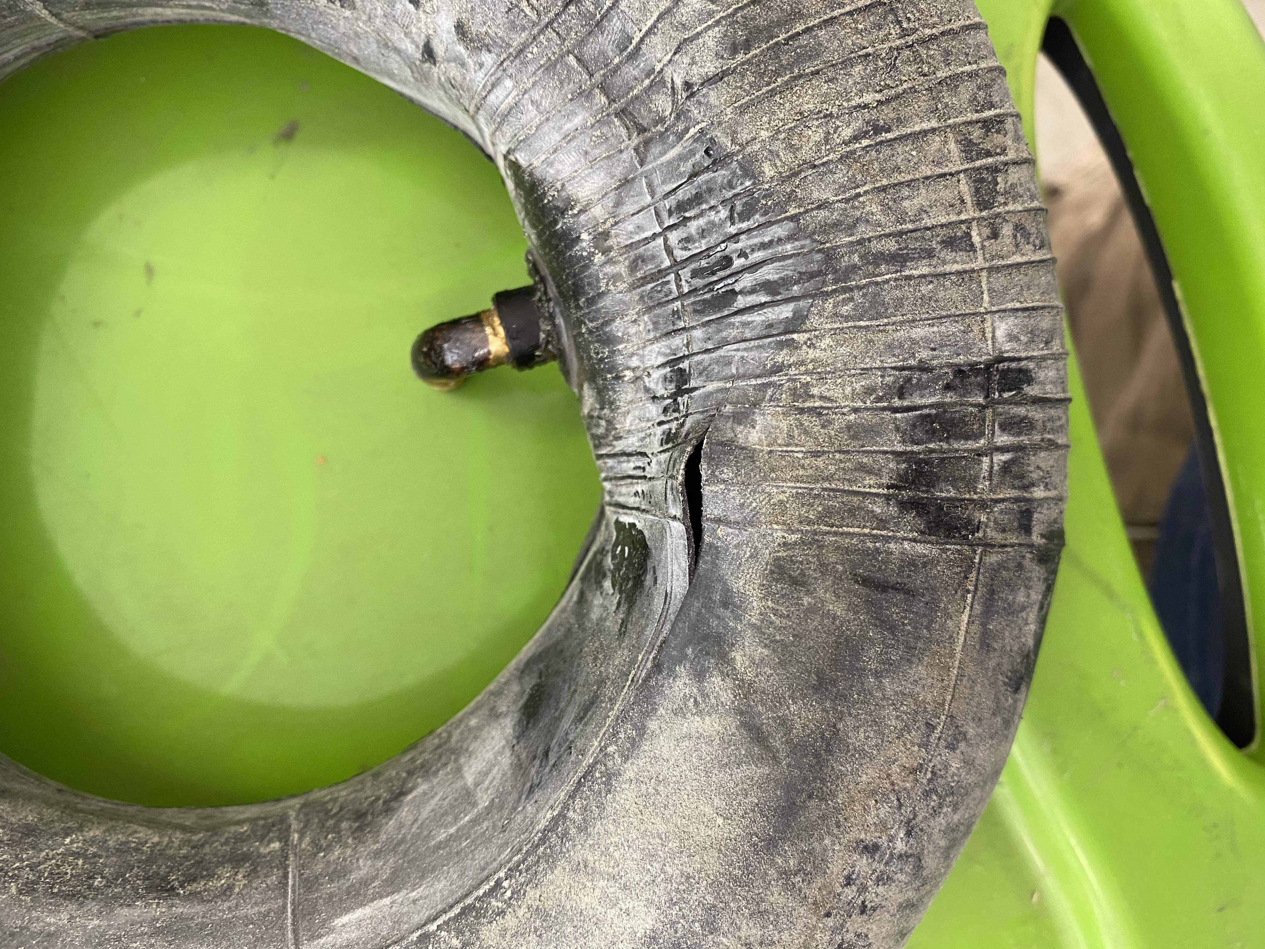

What tube are you guys running on your 404 tire and wide Bushwheel fork ?
I just had one put on my Pacer , went out and did five landings and went to the hanger.
I was opening the hanger doors and heard the sounds of a failing tube - “ phisst”
Flat tire. I have the stock aero classic tube
I have heard some people use a Beaver Tube
Anybody got a part number for the beaver tube ?

ABI knows about the beaver tube and will give you part numbers or sell you one if you ask. They will include it when ordering if you ask as well.
