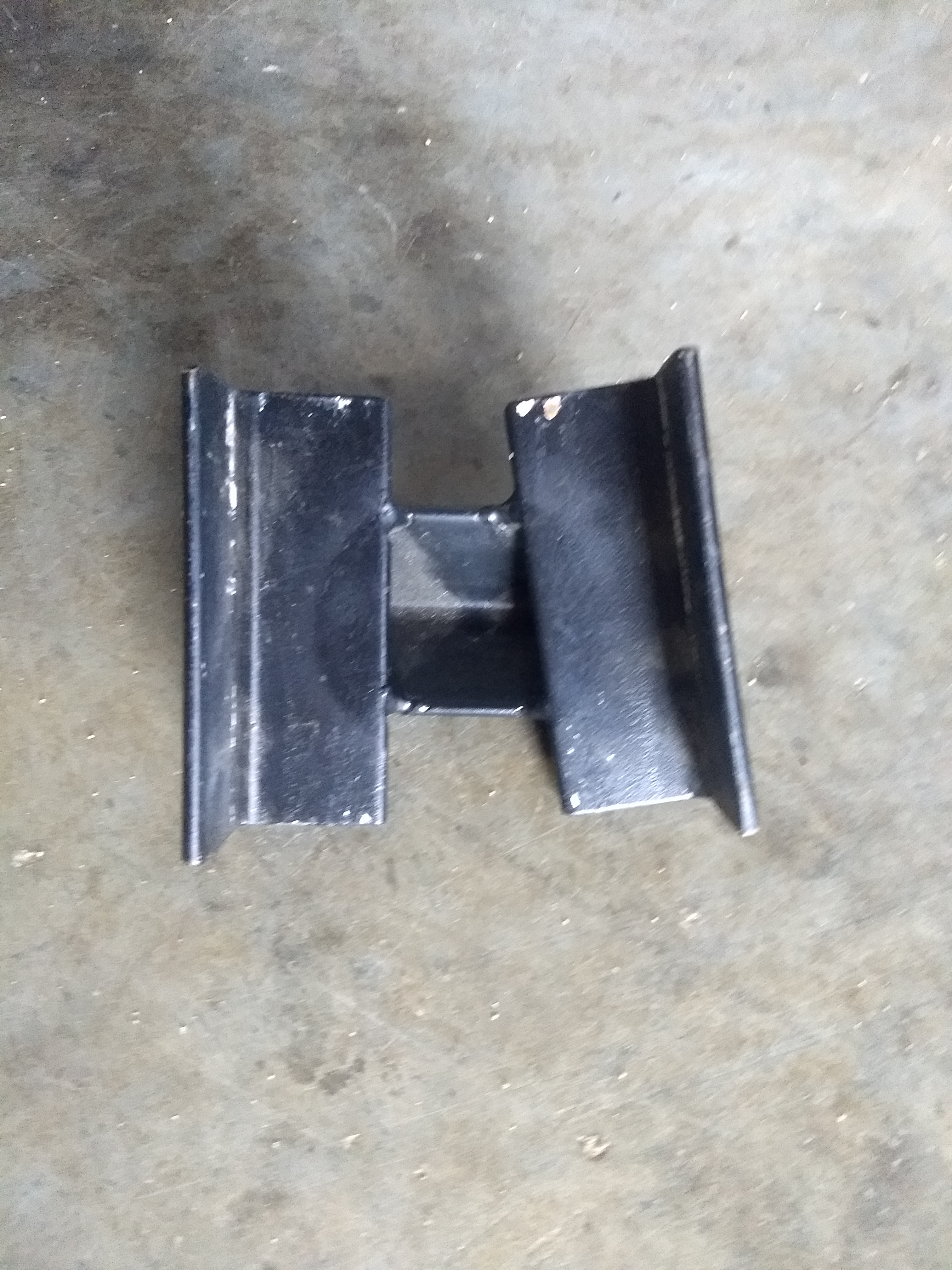

I made my own out of angle iron. Maybe a foot long piece is all you need. I'll try to attach a pic of it.

For the jack pads pictured and similar designs- You can source 1" wide adhesive-backed UHMW tape from McMaster Carr that will protect your paint and help them pop off after a load has been applied. Just make sure they don't pop off too easy. I use a squeeze clamp or similar for insurance against unintended release.

I've used a couple different types...V-channel into steel, and two beefy steel pieces that clamp together with bolts. Grabbing the gear leg isn't a problem...the problem is how easy it is for the contraption (and airplane) to fall off the jack, especially if there's any breeze. Between the spring in the gear legs and the moment of the wings it's really easy to rock the jack plate off the jack. The resulting damage can be significant.
Give any choice at all I lift my gear leg from above. I use a engine hoist in the hangar, or a tripod of stout poles and a mechanical advantage in the field. It's much more stable and safe.

I prefer the 2 pieces of metal clamped together with bolts. Fits more then one style of gear leg, doesn't hurt the brake line if its setup like Pinecones, and a stub welded on it is easily lifted with a rolling Jack. Much more stable. Harder to find a rolling jack in the field, but in the shop it sure is nice.
