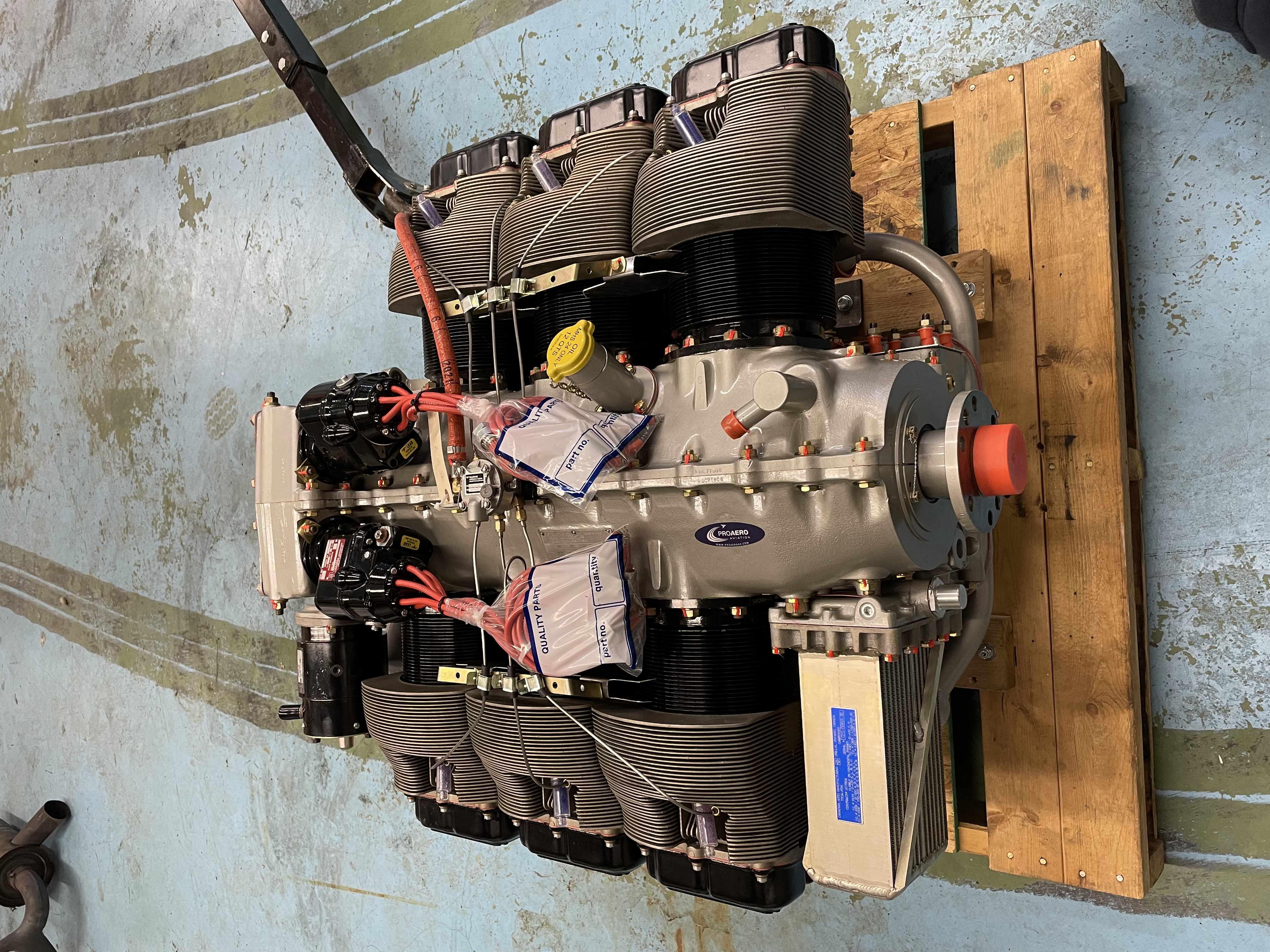

The more this or any thread gathers info, the better, as it’s here for anyone to search up for years after. I like to see threads wander.
The new heart.
