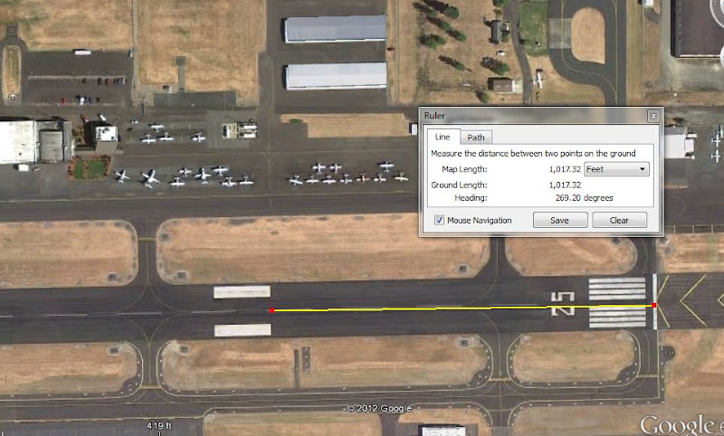

Re: Grass Strip Length and obstacle clearance
Good News, I think! Using the Google Earth?ruler technique, I have found that with starting under the power wires on the SE end, I measure 1310 feet to the 50 foot power line on the NW end of the runway. I haven't had the opportunity to check the accuracy claims for this routine, but I feel they must be good enough to say this strip looks possible now. A little more dozer-scaping will be required but I think that cost will be reasonable enough to have my A/C accessible within 200 feet of my house rear door. I have a lead on a nice looking Aeronca 11 AC and will be pursuing that for a while. Will be back to report on the development later on.

With the PA-16 (o235-C1 115hp engine) I can land on the pavement with a slight headwind and be off the ground again within 1000 feet. It has a climb prop. Recently I've landed several times in a friend's commercial sod field measured at 1000 feet on google earth. He sells the sod for a living so it's always mowed and in perfect condition at about 3000' elevation +/-. There are standard powerlines at one end but not at the other end. I land toward the power lines and take off away from them. Based on my experience going in and out of there with that airplane I would not take off toward the power lines. I don't think I'd make it and am not interested in confirming that. Perhaps you can search around for a strip that is similar in surface to what you are hoping to do and take some real world measurements taking off and landing so you know exactly what your airplane can do before going through the effort to construct a strip that may not work? An extra 300' might make all the difference for my situation although I still don't think I'd like watching those power lines approaching so quickly!
