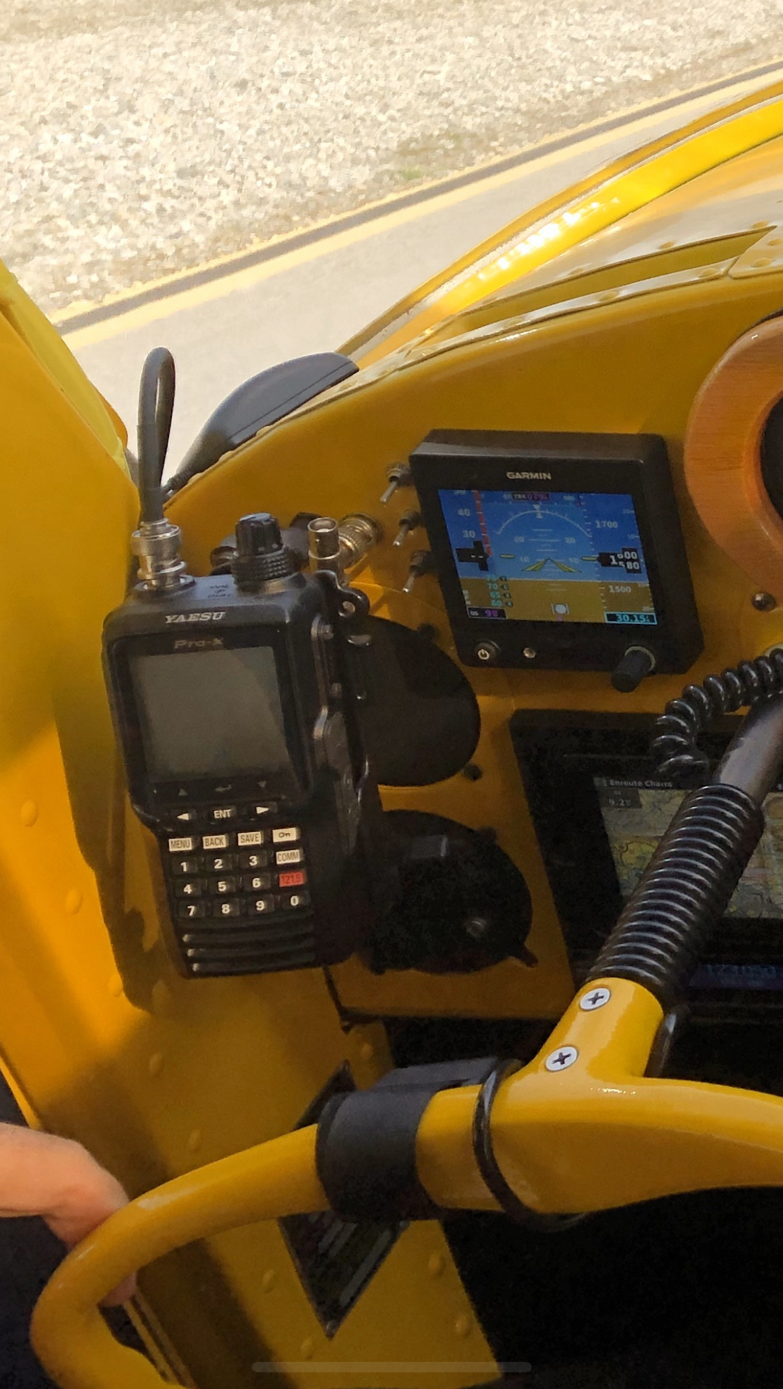

My Yaesu came with a cable that clicks on the side that has two sockets for a headset. I keep that within reach and the handheld mounted on a ram mount. The coax is plumbed to an old VOR antenna that I no longer use. Pretty simple setup. Can’t use the PTT on the yoke, but that’s a minimal inconvenience. I can also pick up a VOR on the handheld.
I have the coax from the antenna mounted to the panel and a short coax from the handheld to the panel. Makes it easily removable.
