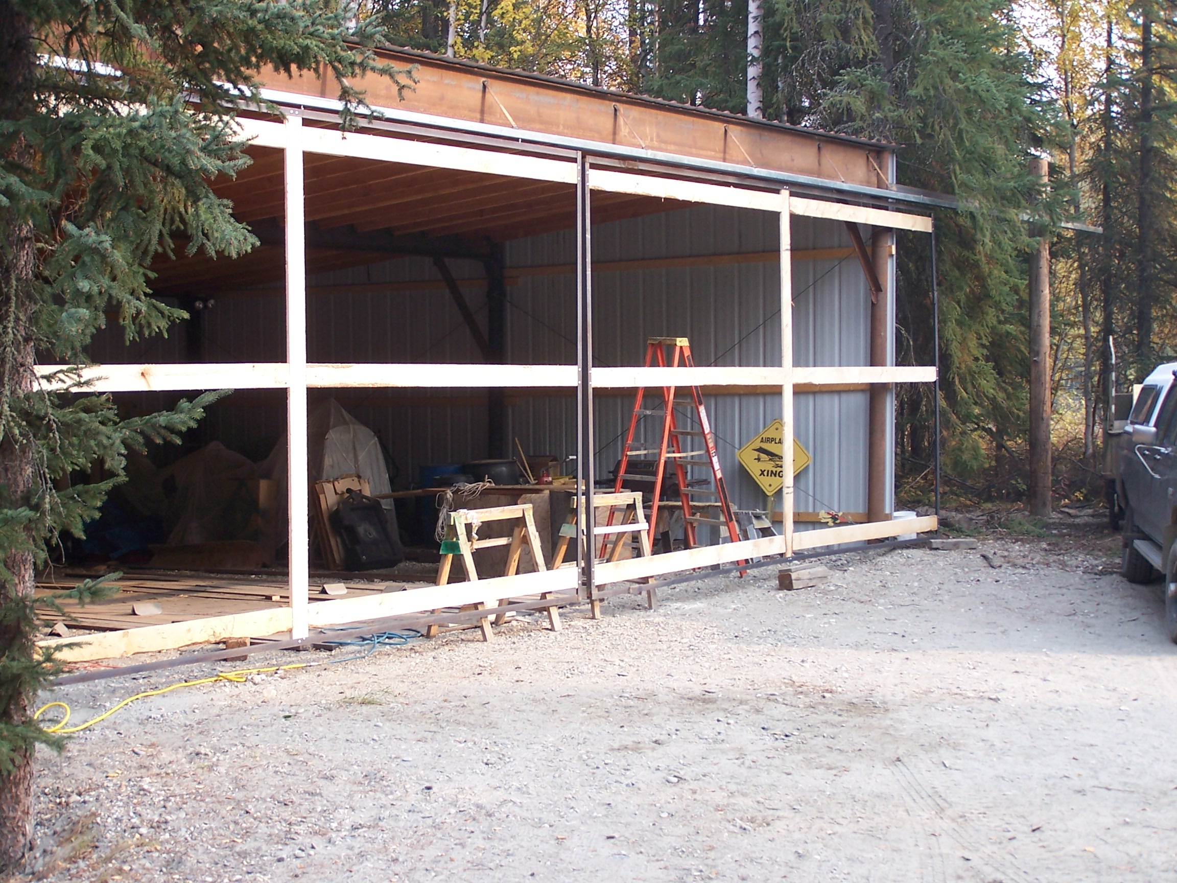

We built 2 such hangars that appear to fit your needs while living in North Pole, AK. Both are simple shed roof designs. The first was an open sided T hangar employing a front 40' I beam from Alaska Steel with mid and rear headers of laminated wood that we made on site. For posts I found a pile of 7.25 OD well casing in Fairbanks and purchased from the owner what I needed. Those rafters were 2x12x14' which I already had. Wood purlins topped with sheet metal roof. Very cost effective and strong structure with proper bracing. The second is 40 x 32 clear-span as we added a mid-span I beam to eliminate internal posts. Went back and procured more casing for exterior posts, two I beams were ordered from Alaska Steel. Lots of welding as I cut angle for saddles to attach wood rafters to I beams, then bolted in. You have to get creative transitioning from steel to wood to ensure structural integrity. Doors are barn style utilizing a double hanging track. Great for uneven gravel floor and snow. A structural engineer can advise you on beam sizing for your dead and live loads. You should also calculate the mid span bend moment which will give you a vertical measurement of deflection under load. This simple measurement will tell you when you need to get up there and push that snow off. (Recommend the old school wood snowshoes with no ice cleats for weight distribution as you can't see where the purlins are and to avoid denting/ scratching your metal when you do this). Added bonus is you can hang your Cub to change undercarriage. Make sure that is taken into account on beam sizing.

Pulled out an old shot of above described hangar. Building the doors. Just 2 large sliders. Very simple and light.
