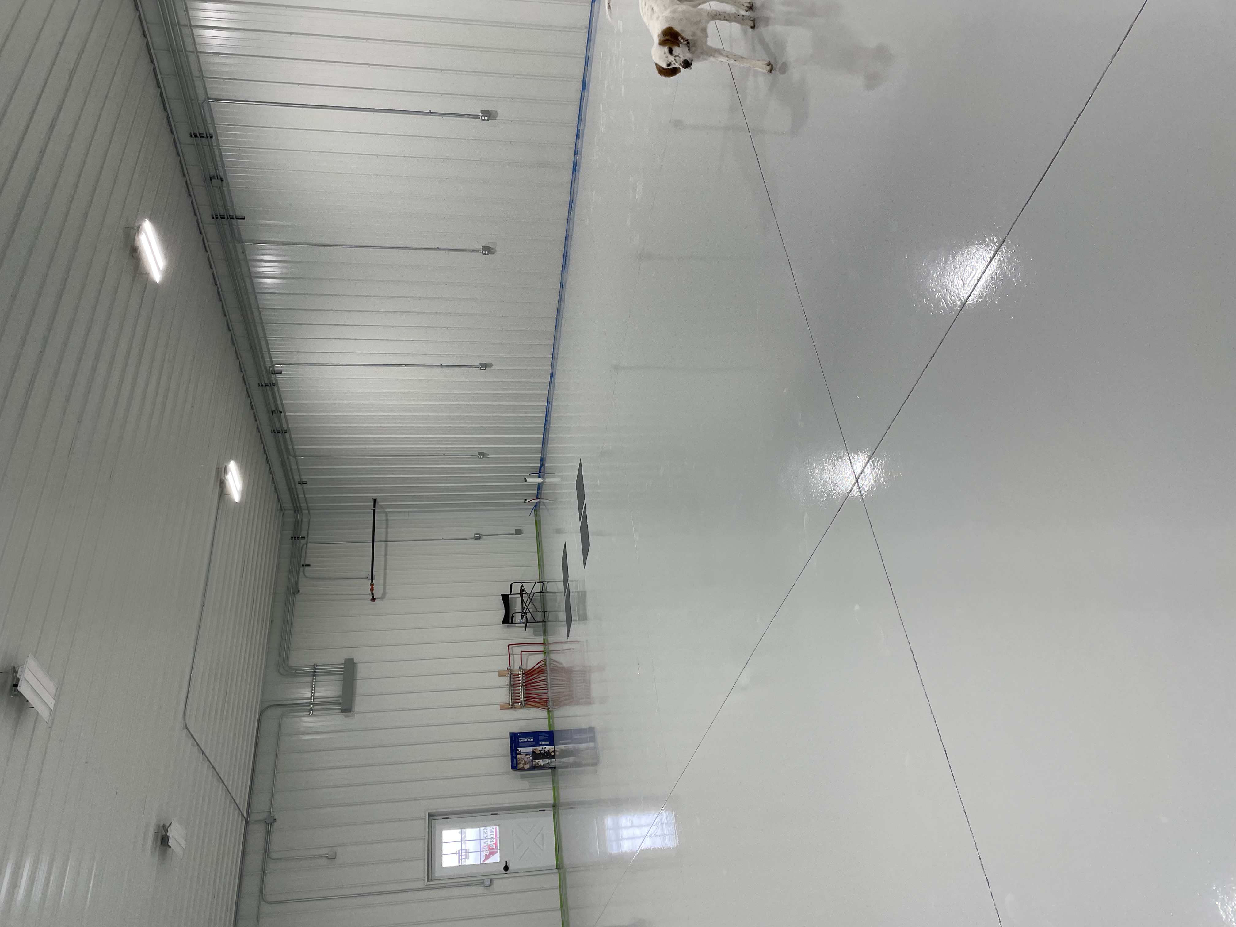

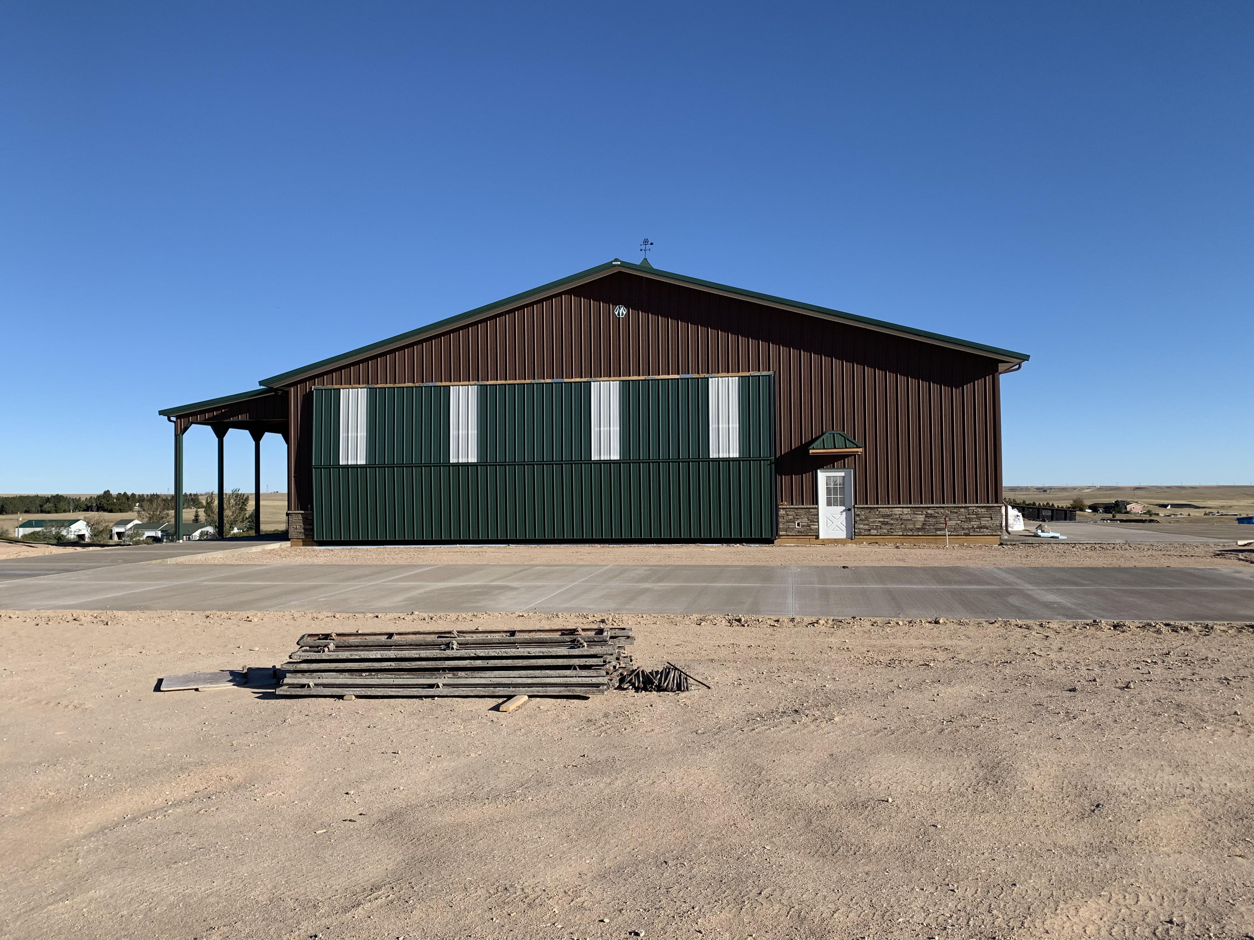

I just built a Morton 80x80 at WY05. Built like a fortress. Installed a Schweiss 50x16 bifold with the new wind lock system. Pay a bit more for Morton but its worth it with the warranty and the fantastic insulation. I also installed radiant floor heating and the Sparta Coat Polyaspardic floor coating

gregwyatt: You need to wear sunglasses in there? Sweet hangar!
Radiant floor heat is a perfect match for a hangar. Besides having it in my shop, hangar, and home, I also have it my building in town I keep my crane in.
With the thermostat embedded IN the slab, and set at 50 degrees, my total cost is zero to heat it as it is totally offset by a 2 KW solar grid tied array, that produces enough power on an annual basis to 100% offset the heating loadings during the winter months. The one time expense of the solar array, 15 years ago, makes me think I now have have free heat, like buying my plane gas in bulk and then for the next few months, flying for free, a little mental trick that is also actually more cost effective. Electric boilers are key, unlike gas fired ones they have no flue losses! With the electric floor heat, an auxiliary air heater (4 KW wall hung fan forced) keeping the slab at 50, quickly brings the temps up to a higher temp when needed. I have found this two heat source system to be more responsive and efficient then a single source. Rad floor to keep things well above freezing, 50, then only when needed aux heat gets things cozier quickly. It's not rocket science to install yourself, I did anyway.

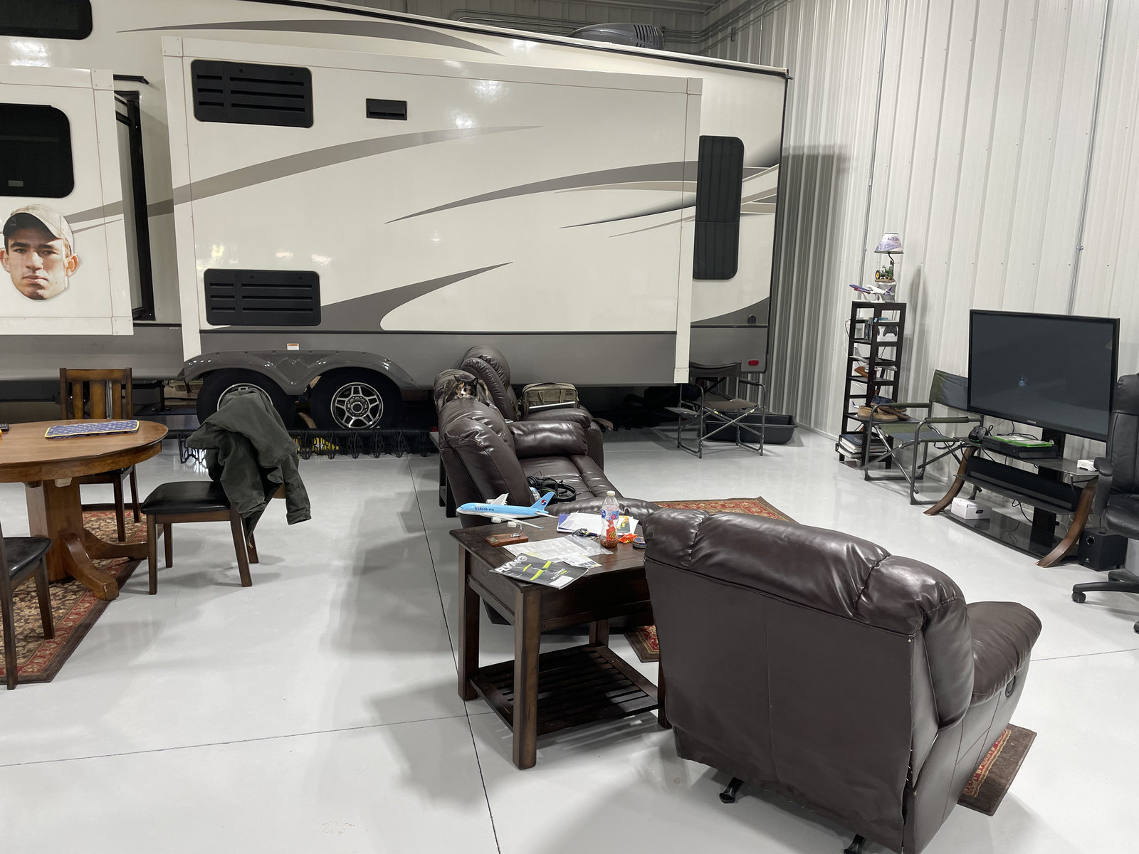

Thanks Kurt, we are still about a month out from having the living quarters complete. We have been living in our fifth wheel since last summer and moved into the hangar about a month ago a day before the real winter weather arrived here in SE Wyoming. Its very comfortable and Ive started to set up the man cave a little. Stays nice and toasty!! Anybody have a walk behind commercial floor scrubber they want to sell let me know. It's a job trying to keep the floor clean.
