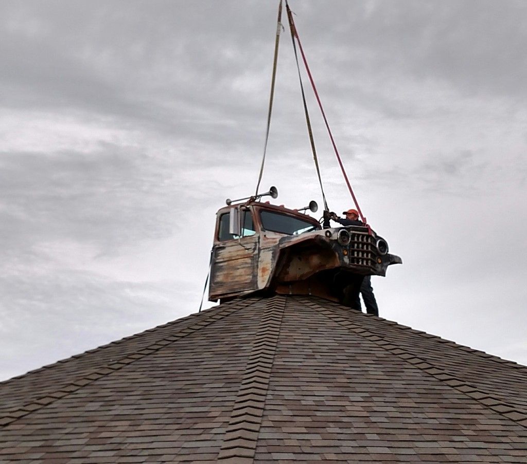

I set a Jeepula on a 8 sided garage today that has a pretty cool revolving turntable. He can fit 8 rigs in there and has easy access to any one of them. The Ford panel truck is on the turntable, it's remote controlled and has it's own electric motor, it spins pretty briskly. I know this concept is not new, and has been used for hangars before, but to see it in action was pretty cool, as were his various rigs. He had a 1300 lb 'Nam era all aluminum Jeep that was was designed to be dropped via parachute, all original, it makes a great rock crawler he said! My favorite was the blue and silver snub nosed Ford hauler with a tilt cab plus a dump bed, all re-engined and fully decked out inside.
A Jeepula is like a cupola, except a '52 Willys is used :shock:
