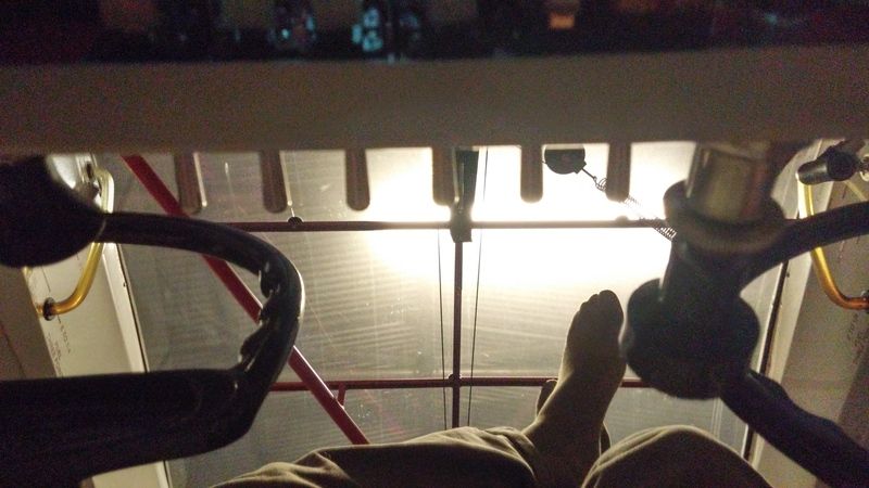

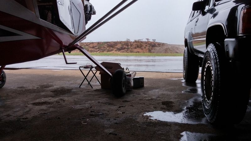

Happiness is...
Making the most out of a rainy afternoon!
Now if you'll excuse me, I need to get back to hanging upside down under the dash.
Re: Happiness is...
I was just about to lament the days of having an airplane in the hangar and being able to wrench on it on a rainy day...
But then I remembered I do have that-- It's just a LOT more wrenching and it's in my garage. I work on it in my socks.

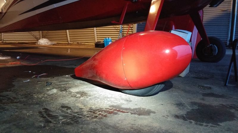

Cameron,
You still have the extended "wheel pants" nuts on the axles :lol:

8GCBC wrote:Cameron,
You still have the extended "wheel pants" nuts on the axles [emoji38]
Late night at my office:
I need to mount them up and see how much they'll do. They're pretty swoopy.

Wow... with those sexy wheel pants and the Grove gear that'll be one speedy Pacer !
We're having a discussion on another board about the Pacer wing twist and its effect on cruise speed. Apparently the short-wings were designed to be optimized with that twist, and removing the twist slows the airplane down a bunch instead of speeding it up.
For anyone who grew up during a certain time, remembering a certain early anime TV series... "Go Speed Pacer, go Speed Pacer, go Speed Pacer Go!"

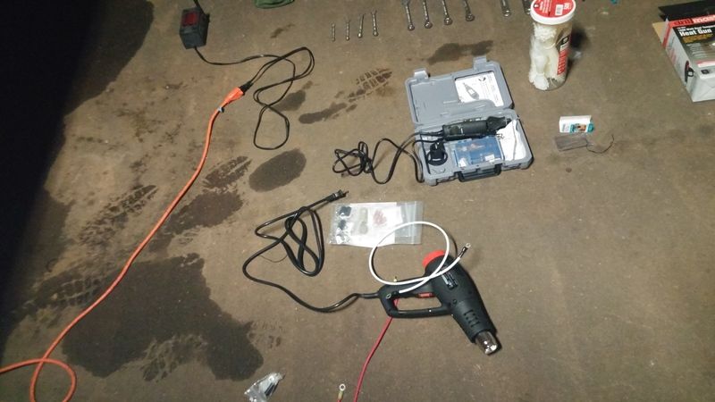

This was my view for much of the afternoon / evening:
On the plus side, I got all the under dash wiring complete. What a pain. I went up in amperage from 35 to 60 on the alternator, which required rewiring from 10 to 8 ga. Plus the new alternator is internally regulated and over-voltage protected, so there were some old components that had to come out and new wiring routed.
I replaced the old 35a breaker with a 60a current limiter, so now I have a hole in my dash that's labeled "ALT"
I got the idea that it'd be neat to wire an indicator lamp in there since my new alternator has the wiring for an optional alternator out indicator. Heck, it's already labeled! Problem is, I can't find any good ones. I made a trip to the aviation department of the local radio shack and they didn't have anything worthwhile. I've also done about 30 minutes of internet searching and the best I can come up with is this:
They don't look that bright.
Does anyone have any experience with something really bright?

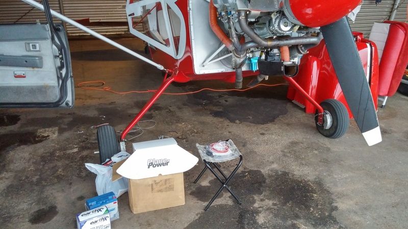

Firewall forward wiring complete:
MOC OK!
Next up is gabbing a battery box for the new earthX, cleaning up the wiring behind the panel, and reinstalling the interior.
This whole process would've gone much faster if I hadn't accidentally dropped stuff into the floor and had to remove the interior to remove the FOD. Next time I'm going to tape down some sheeting like a painter.

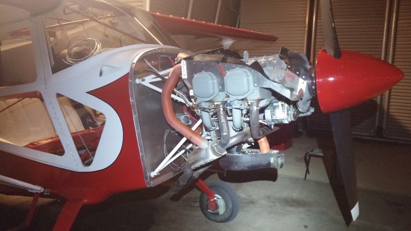

Carburetor air intake plenum looks good, so does the exhaust and the front/center crankcase baffling. If you're looking to improve cruise speed and engine cooling, take a look at the cooling/cowling design on Peter Garrison's Melmoth 2. There's a big chunk of speed there, when compared to Piper's original system. Not to mention having better tools to keep your engine running better.

Cam, Looks like you have a lip on the bottom of the cowl where the air exits already, Lots of discussion on this and various fixes on the RV forums! Glastars have the same problems!
You mite extend it just a bit or try another angle to create a little more vacumn on the bottom of the cowl. I had to do that on my M6 Maule to get it to cool correctly as it had a bastard cowl on it? 1/4" made a difference on the length, also have one on my RV6, it is sealed up on both ends so the air has to come out there and I think that is what makes it work!! #-o

EZFlap wrote:Carburetor air intake plenum looks good, so does the exhaust and the front/center crankcase baffling. If you're looking to improve cruise speed and engine cooling, take a look at the cooling/cowling design on Peter Garrison's Melmoth 2. There's a big chunk of speed there, when compared to Piper's original system. Not to mention having better tools to keep your engine running better.
It looks like he's essentially turned the typical pressure cowl upside down... Not sure how it'd be more beneficial... Different, for sure. I'm already using much smaller inlets and exhaust to reduce cooling drag, as well as a much more streamlined cowl to reduce form drag. I think once I replace the floppy stock RV baffle rubber it'll fix my cooling problems.
M6RV6 wrote:Cam, Looks like you have a lip on the bottom of the cowl where the air exits already, Lots of discussion on this and various fixes on the RV forums! Glastars have the same problems!
Have FUN
Thanks GT! That lip only extends to where the cowl mounts. It's clean where the cowl exhaust is. There's also a small lip below the cowl exhaust. Here's a couple of pictures:
(that lip is straightened out now.)
I'll get you a better one of the forward face of the firewall tomorrow.

I measured the hole in the panel and it's about 1/2", so I think I'm going to order one of those. Thanks!
This alternator is much better than my last. It started charging the battery immediately after cranking. The old one I would have to rev the engine to between 1200 and 1800 to get it to start charging.
The EarthX cranked amazingly fast as well. Unfortunately to permanently mount it I'll have to make new battery cables. It hooks up differently than the old lead-acid battery does. Right now it contacts the yoke tube at full nose down elevator and I don't have any slack left in the cables to move it. So I'm going to re-mount the old battery for now while the new wires come in the mail. This will also give me a chance to fab up a nice new battery box instead of hacking up the existing one to "make it work."
Cam, not sure how to draw on this so will try verbal!!
If you built a small triangular fillet on each end of your tab, then the air would have to exit over the tab and not blow out the side? Hope that make sense #-o ??
Also you might flatten it out a bit to see what happens, looks pretty severe!! Might be causing turbulation instead of a vacuum??
I think 30-45 degrees would work better for U. Looks like almost 60??
Look at some cowl flaps on the ones that have them, Long small angle! I know when I open the cowl flaps on my 210 it changes the angle of the airplane and I have to trim if in level flight, ya might even go faster?? =D>
Comments worth every penny you spent!! 8)
