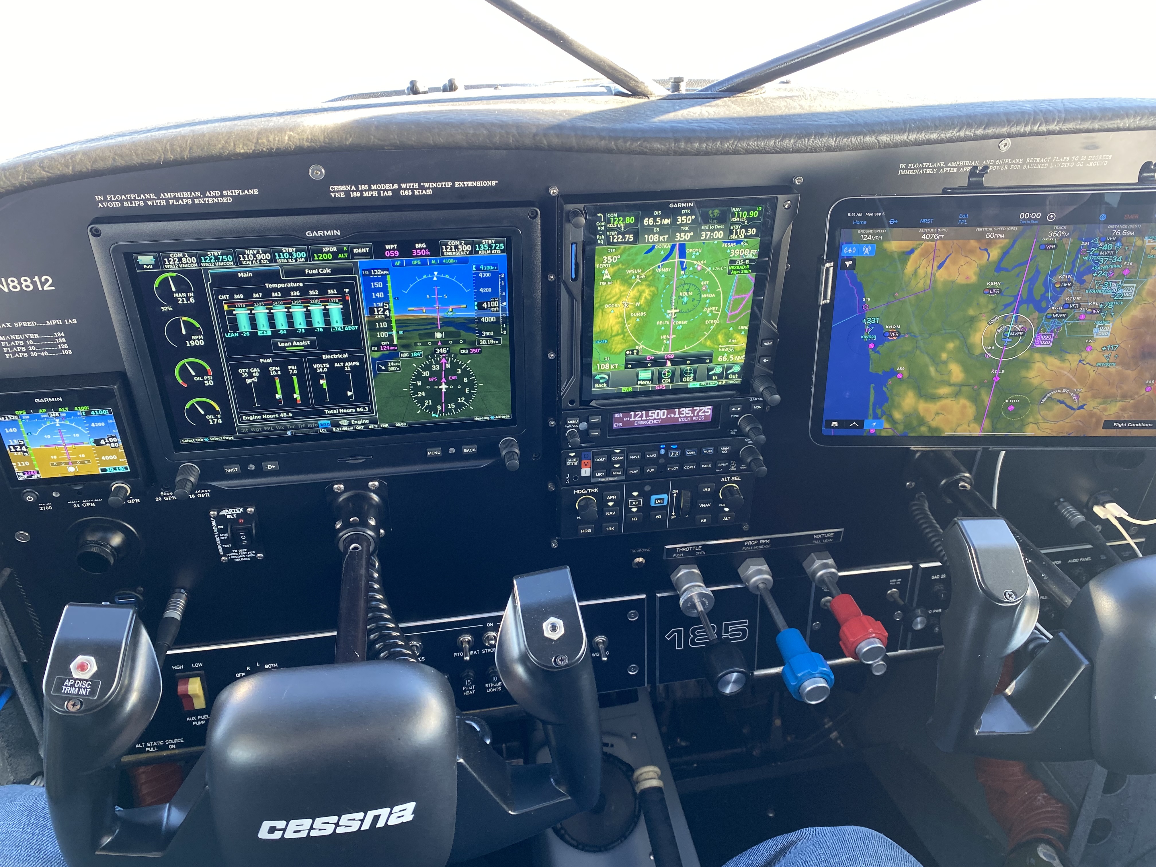

To directly answer your question, no. I went 10” G3X pilots side, G5 backup, along with a 750 and 500 autopilot. I run a IPAD on the copilots side and my engine instruments are on the G3X. I usually run the ribbon of basic EIS DATA on the G3X, along with half of the split screen with addition engine data. I will periodically use that side of the screen for other duties (flight plan, weather, traffic…..). I briefly considered putting in another G3X for the copilot, very glad I didn’t. The IPAD on the copilots side tilted towards me is the perfect for VFR and especially IFR. As I’ve been working on my instrument ticket, I’ve found it invaluable to have the GFC 500 directly above the control quadrant, every altitude and heading ATC instructs is quickly changed on the heading and altitude bugs with the GFC 500 knobs. When it comes to avionics, what little I know, it seems a single manufacturer for the entire panel is the way to go, everything’s made to talk to each other. I wouldn’t do a JPI, but it seems like this subject is like asking if somebody likes glass or round gauges, que the debate.
One things for certain, I’ve never heard of anybodies eyesight getting better as they age, do you want to look at a 10” screen or 3 1/4”

hotrod180 wrote:
Dog is my Copilot wrote:I have a G500Txi. I went with a 7 inch landscape screen because it fits better in an early C180. Also have a GTN650Xi/355/345R and a GFC 500AP. I love my panel and have zero regrets. I went full glass in 2020. ....
Can you post a pic of your panel, Josh?
Thanks.
Image - just showing off some speeeeeeeed !
Josh
