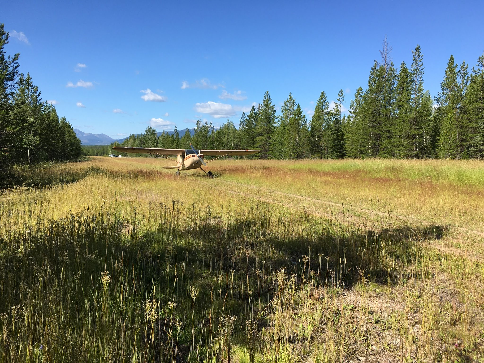

Lots of good ideas! The strip is about 2000ft long and most of it is pretty good, however hunters bumble their way onto it and rut it up in a few spots. I've tried filling them in by hand but once the mud hardens its like concrete. By the sounds of most of the posts, big and heavy is the way to go if I want to cut and fill. I'm sure I can find a scrap I beam kicking around this ol pulp mill.
Not the rutted section:
MRebel offline
Posts: 22
Joined: Thu Nov 01, 2012 7:39 am
Location: Canada
Re: Homemade airstrip grader/groomer
That much vegetation will handicap most any sort of drag.
