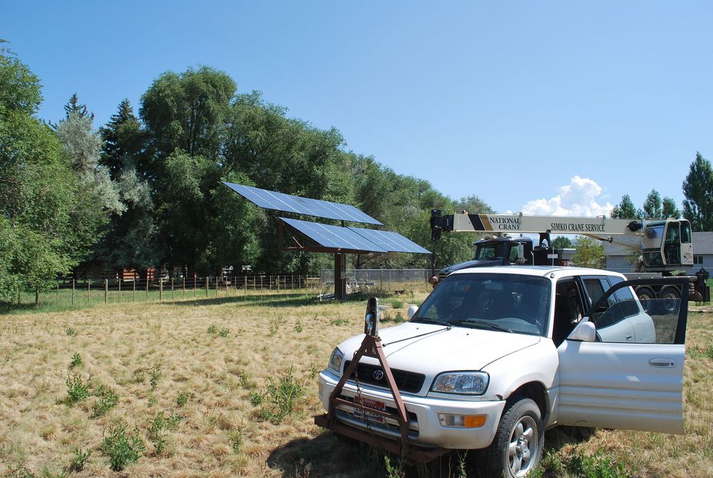

My current project, all MIG welded. 10' x 20' steel racks for solar arrays, my own design, I have about 35 of them up now. A bit over 3 KW per array.Some as high as 60'! Most 10 or 12'. They weigh about 1400 lbs, and 4 of them on one big pipe seems to be working well, though most are singles, with a few doubles. I pre fab them in the home shop, and then truck them to the job site, really keeping my time spent there to a minimum. I can do these as cheap as a "store bought" one, but with all local materials, delivered, and installed. They are built to be picked with a crane, good thing I have one. This 4 array system, installed last year, will be doubled in size with another 4 array rack, that's what I'm building now. The customer drives a Tesla, and put 59 K miles on it the first 6 months he owned it.
Strictly a self taught welder here, but with a all around construction background "when in doubt, use a gusset", is my motto. And, when able to buy buy used pipe "use larger dia. then you think you need, it's still pretty cheap". Keeping them square is the trick, ( the usual carpentry lay out skills come in real handy) I have my system down now to the point that when finished, they come out within 1/4" square, some perfect. One was an inch out, over the diagonal, but still easy enough to correct when installing panels, just like a good carpenter building on a bad foundation can make it work. Fun stuff, I really like working with steel, after being a nail bender most of my life!
That tow bar on the Rav4 knocked a deer down the other day, if I would have been in the Yaris, it would have ended up in my lap. No harm to to the 4 or the deer, that bar has been on 5 different rigs over the last 25 years, guess i built it right.

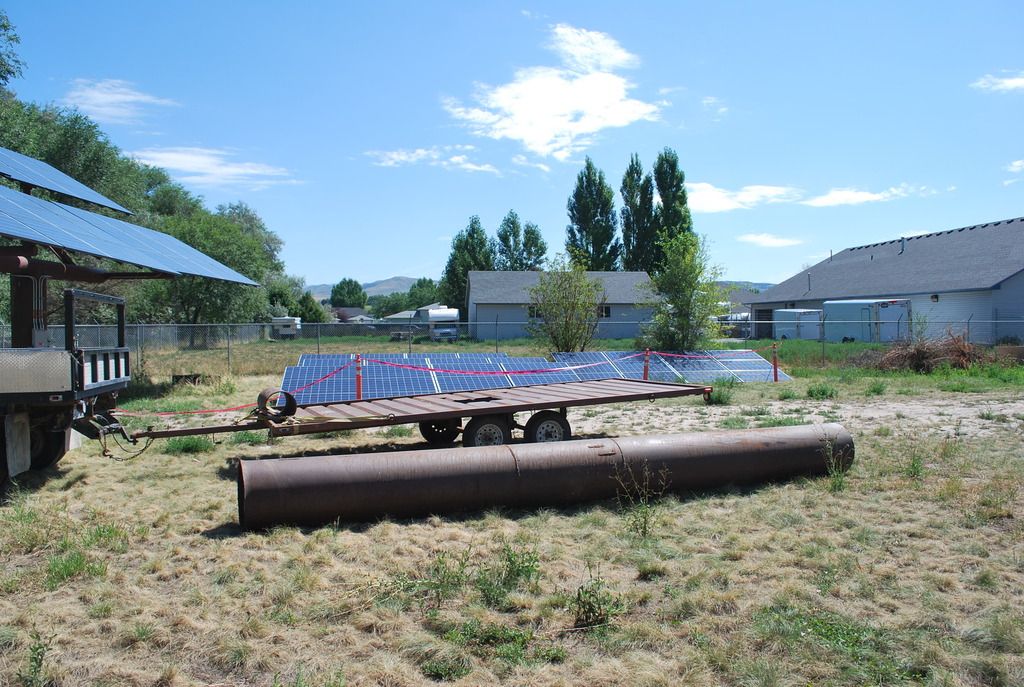

So.... the other day I'm doing a crane job at a semi retired well drillers place, unloading a big water tank off a trailer, and I happen to notice a pile of misc. pipe., some large enough dia. (24" and up), to be just what I need for the main vert support pipe for the 4 solar arrays I delivered yesterday. See his boneyard at the upper right? Tonight I called him up and said I have cash money for the right pipe, and is he going to be around tomorrow AM?

He had exactly what I was looking for, a 20'+ length of 28" pipe, (I need to match the other array, it's vert pipe is also a salvaged/pre owned 28"er) schedule 80 no less! Sure it was scabbed together but welded right, and was straight other then one end being mushroomed a bit, that end will go in the 10' deep hole with 6 yards of concrete around it so no problem. Plus, using my new concrete bucket I just bought for the crane, this pipe will not only be IN the concrete, but will have concrete INSIDE it, so, hell for stout. $300.00, a great deal for him and I saved about the same, considering a new piece would be about $600 or more. The last thing I needed was 24' of 14" pipe, he didn't have any so we went across the road to his brother's boneyard, who also didn't have any. Bummer, as they sell it in 21' lengths when bought new, so I was looking at 2 lengths to end up with 24'. But then I spotted a short piece in the weeds that looked about right. The only piece of 14" we could find, and it was 38", so now I can buy 1 length of new, and have 24'+, a very productive and cost effective morning.
35 miles later, at the job site, I rolled the 28" pipe off the trailer, next step is to cope the top out for the 14", and then plant it in the concrete. Sorry for the thread drift, this is a welding thread after all, but as usual sooner or later whatever I do seems to involve the airplane. The tall grass and a tailwind made reversing my landing for takeoff a little iffy, so I taxied up along the blue shop and blasted off into the wind on the field with the small pivot system, it being out of the way. The well driller got 300 bucks and a 10x12 photo of his spread, and he had zero problem with me flying in and out, liked it in fact. =D>
