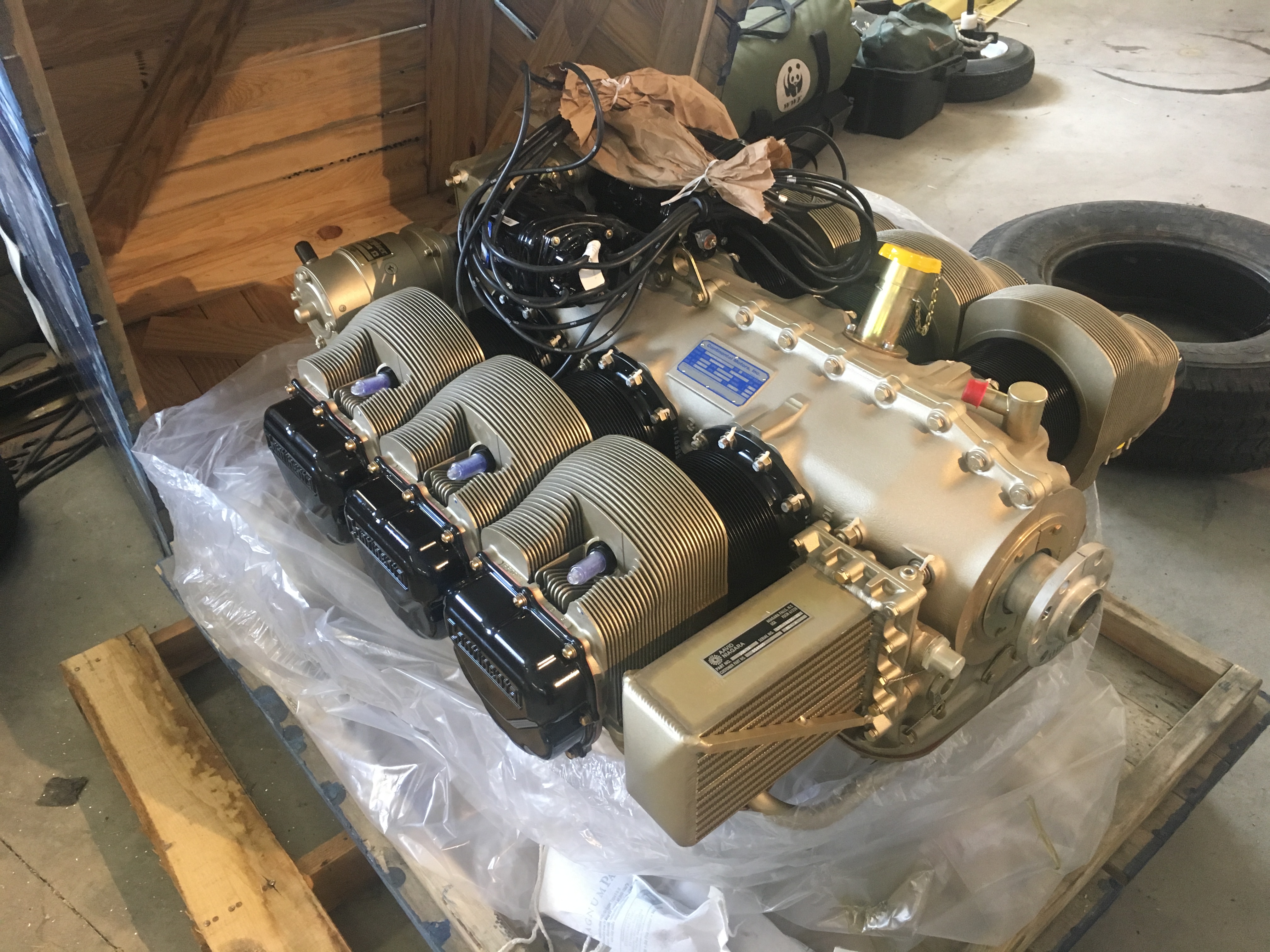

I recently installed a TCM factory reman and it didn’t come with a single yellow tag. Log book entry only. How old is that case, crank, gears? Who knows. No AD record either.
Well the only yellow tag was the test run record.
A few local builders will give you a book with build photos, lot numbers and tags for even misc hardware for engine overhaul records. That can be very handy if some AD comes out against internal parts.
