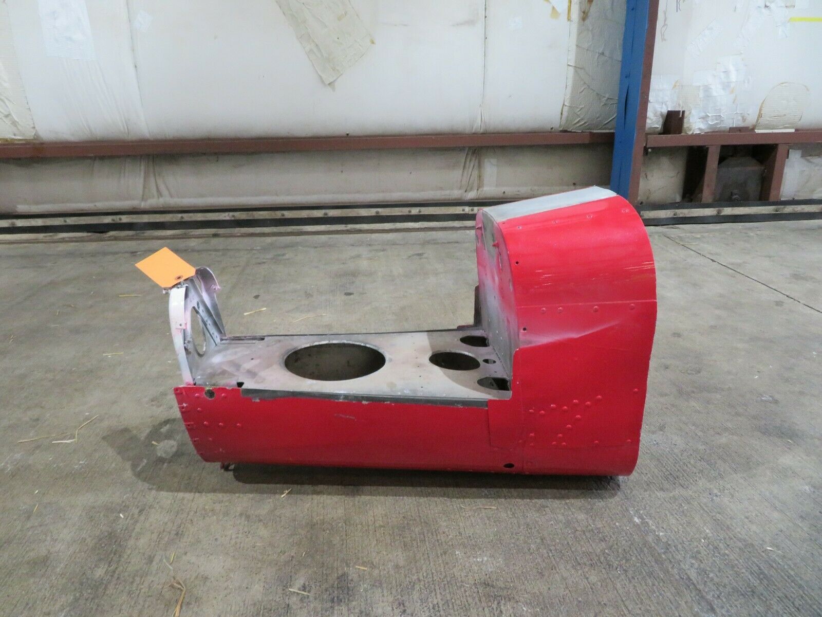

Here are some pictures of the one I have... Noticed that a Cable wore a slot out of it towards the front, Not sure if your mechanic will want it due to that..
Brian.

I know of not a single 180, 182, 185 with jack screws on the other side of the forward bulkhead… 0712206 is the same part number through 1962… the one I have is out of a 1960 C model 182… there is a bulkhead that is normally just aft of the jack screws that has been removed from mine already, that may be what you are referring to..

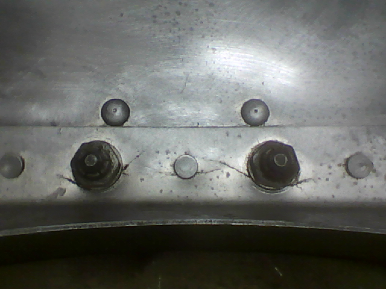

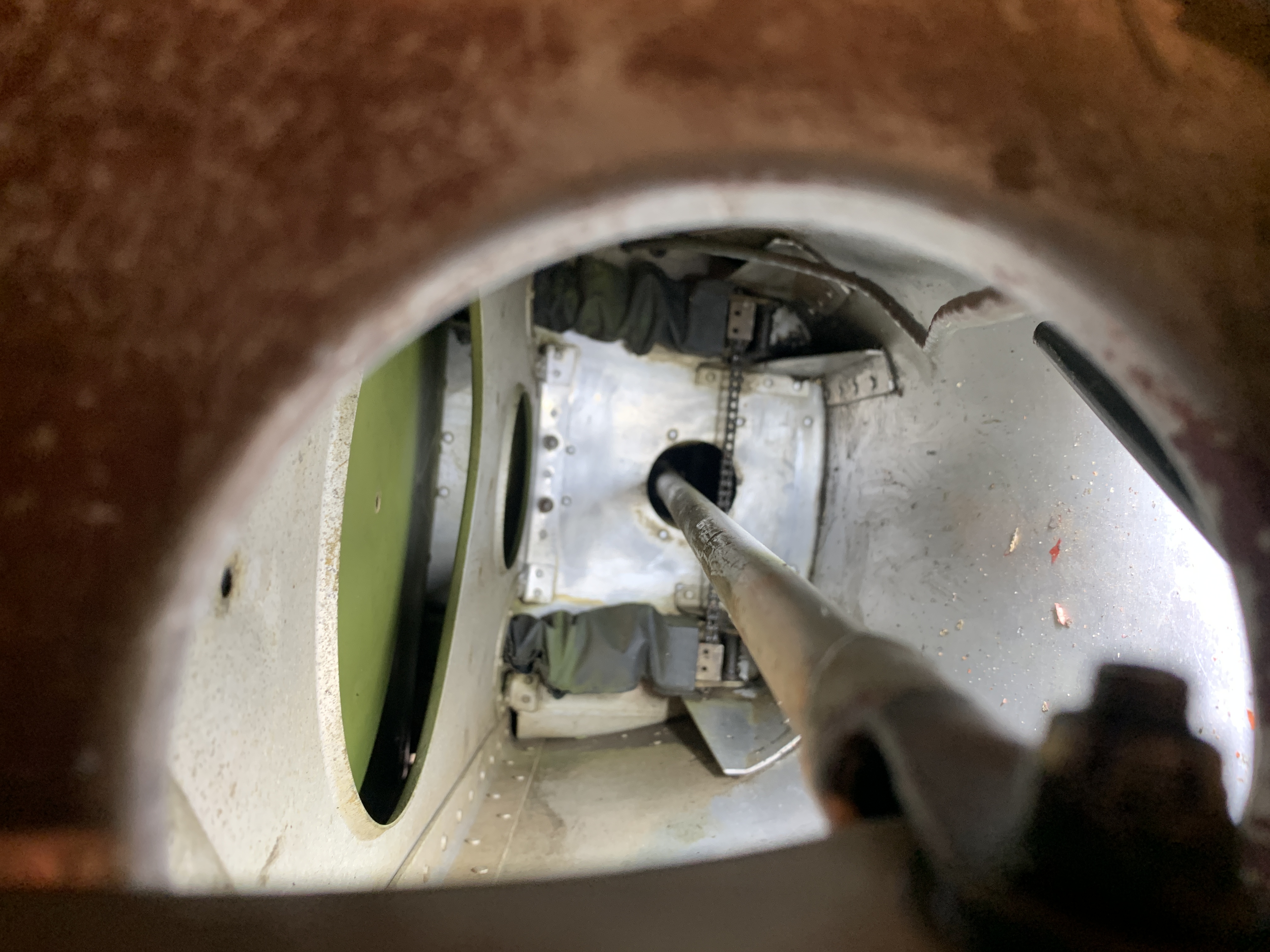

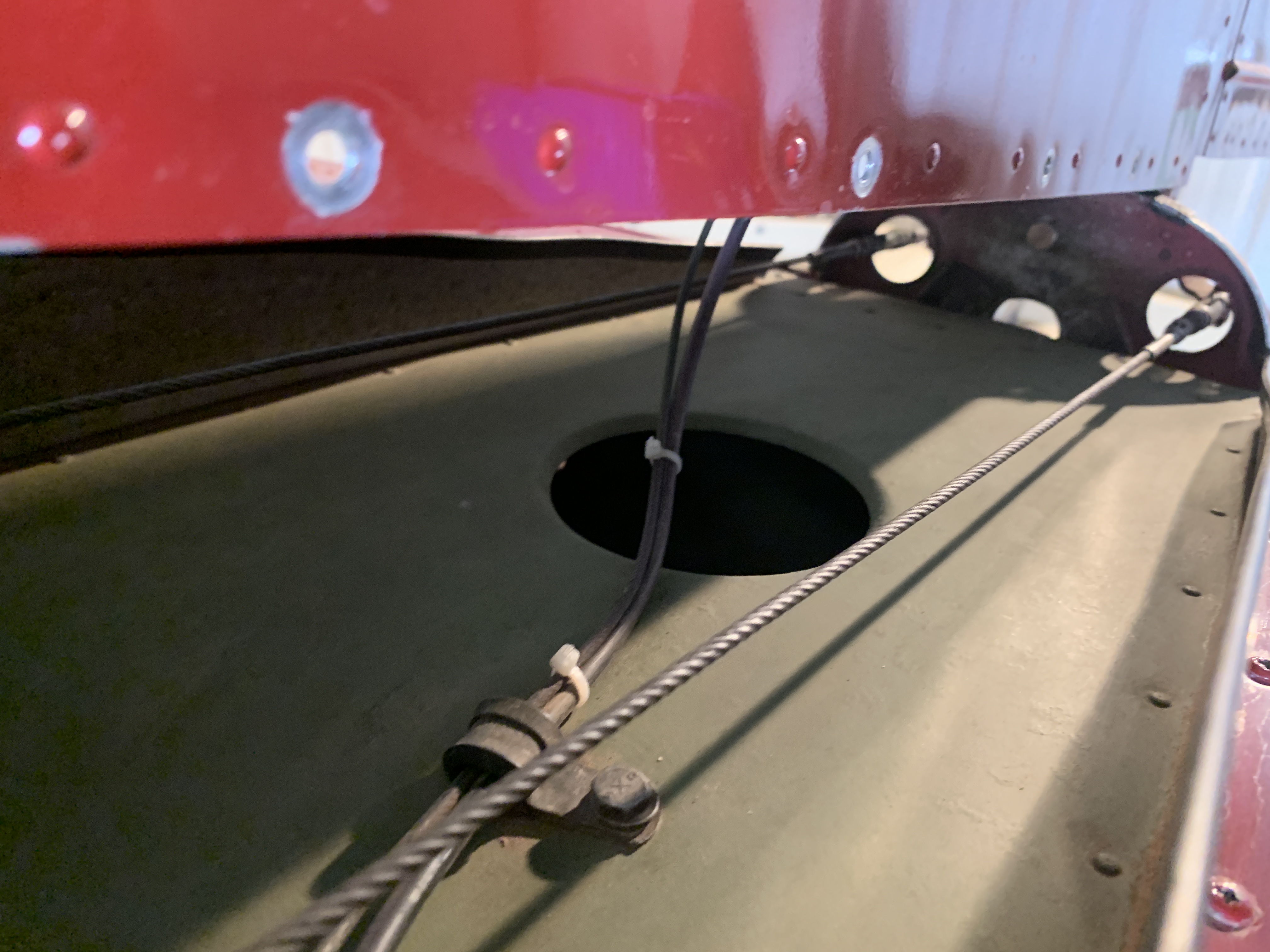

Thanks for the response. My explanation was some what lacking but here are the facts. The mounting plate that is between the 209 and 230
bulk head that sits horizontally under the vert stab is the part I am looking for and was referring to in previous post. In the parts manual they list it as a (bulkhead assembly -tail cone). My jack screws are below this plate and do not rise above that plate thru access hole like the one you sent a picture of. My tail actually has a upper and lower plate I will attach photo's to help clarify. The parts manual does not show a tail section like mine I'm not sure why. In the pictures you can see the cracks I am dealing with. I am being told this plate must be replaced not repaired. Any advise or ideas would be much appreciated. I hope this clarifies the parts I am looking for.
Thanks

ZBDRACE wrote:Thanks for the response. My explanation was some what lacking but here are the facts. The mounting plate that is between the 209 and 230
Thanks
So is the Crack in the green part in the top picture? That's part of the horizontal stab, not the tailcone. If the Crack is in the piece shown in the bottom picture, picture taken from below and rear, then that is the part Brian referenced. If it's in the top part, then you need to look for that part number in the horizontal stab part of the parts manual, not the tailcone.

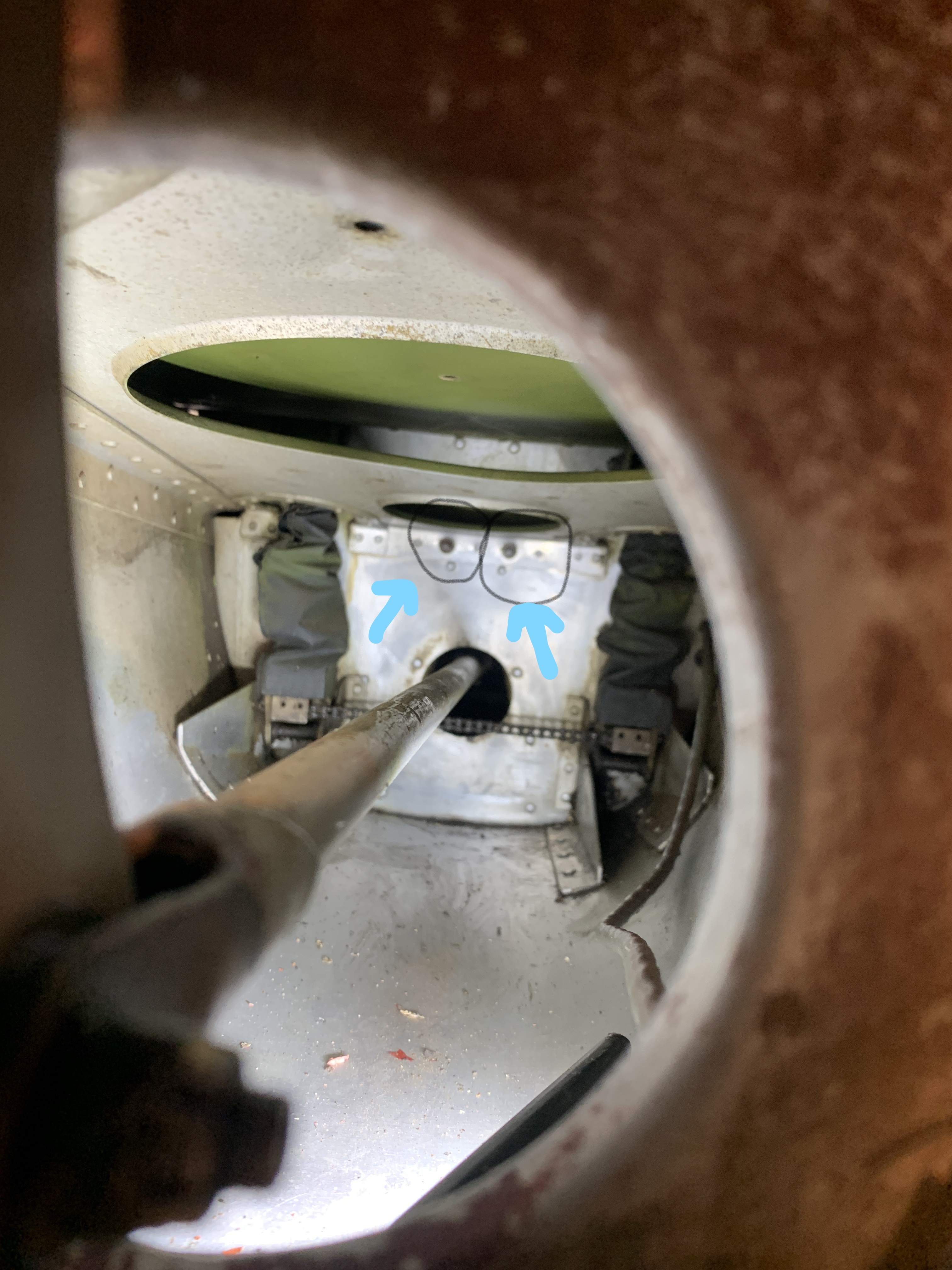

Here is a view thru the tail cone. I circled the bolts where the cracks are.
ZBDRACE offline
Posts: 28
Joined: Mon Sep 21, 2020 10:16 am
Location: St. George
Aircraft: CESSNA 182a
Re: IN NEED OF 182 A TAIL CONE PARTS
ZBDRACE wrote:Here is a view thru the tail cone. I circled the bolts where the cracks are.
That is the piece that Brian is trying to sell you. The jackscrews are going through it on each side of the bolts you circled in the picture. I circled the jackscrews in the picture below. That's where they go through and attach to the bottom of the horizontal stab.

Got it. I had to go look at the plane again to see that there where 2 plates. Thanks for all the input and advise.

Question for Aeropod or any other qualified individual that will chime in :Aeropod made a comment about a repair and being a couple hour job. I am all ears, If this was your repair how would you tackle it? I am being told that the horizontal and vertical stabs need to be removed and the new plate riveted in. Do you see an easier way to resolve this fix. I am not a A&P and I would be very interested in any ideas on how to repair this crack with out removing the tail. Any advise would be much appreciated. Its repairs like this that make me want a experimental aircraft.

ZBDRACE wrote:Question for Aeropod or any other qualified individual that will chime in :Aeropod made a comment about a repair and being a couple hour job. I am all ears, If this was your repair how would you tackle it? I am being told that the horizontal and vertical stabs need to be removed and the new plate riveted in. Do you see an easier way to resolve this fix. I am not a A&P and I would be very interested in any ideas on how to repair this crack with out removing the tail. Any advise would be much appreciated. Its repairs like this that make me want a experimental aircraft.
Thanks again Dan
Unfortunately, there is NO way to repair that without removing the tail section... However, that only takes about an hour or so to do... The vertical and rudder can be removed together, the elevators removed from the stab and the stab separately.. Once you are in there you can do a more thorough check of the attachment brackets, trim screws etc in accordance with the tail AD and Cessna service bulletin. And since it will be off I would recommend buying and installing new rear bushings (F Atlee Dodge) and possibly go though the jack screws also. Its a good time to do that maintenance with that kind of access.
