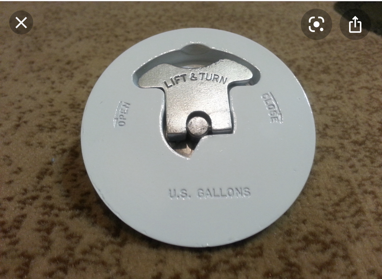

They look like this one.

The cap in that photo looks like a metal cap and it is NOT a killer cap. That cap has two o-rings that are easy to replace. There is a whole thread on BT about improving the o-ring material, as a matter of fact, as Beech guys use the same cap.

The thing is that the one in the pic I posted don't have the backup vent feature.
Maybe they should be called killer killer cap then :o
So, can it be converted to just killer cap ?

If you really have the old Wisco plastic ones, maybe toss 'em and install the metal ones

I have the metal ones and as long as you keep both seals in good condition they work perfectly well to prevent water from coming in or fuel to leak out but that is not my Q.
Just wonder if they can be drilled to put a backup vent valve just in case the main vent gets blocked for some reason.
If that can not be done think I would rader buy Atlee Dodge adapters and go that way.

Well, thanks for the picture slow18. I see I have the red plastic "killer caps" on my recently acquired 180K wet wing. The o-ring on the perimeter must be good since I really have to dig to get them off so must be the o-ring where the flip twist deal goes through the center. Have been thinking if I leave it outside, I will either tape plastic over the area or get a toilet bowl plunger and rig a strap to hold it in place to seal water out.
