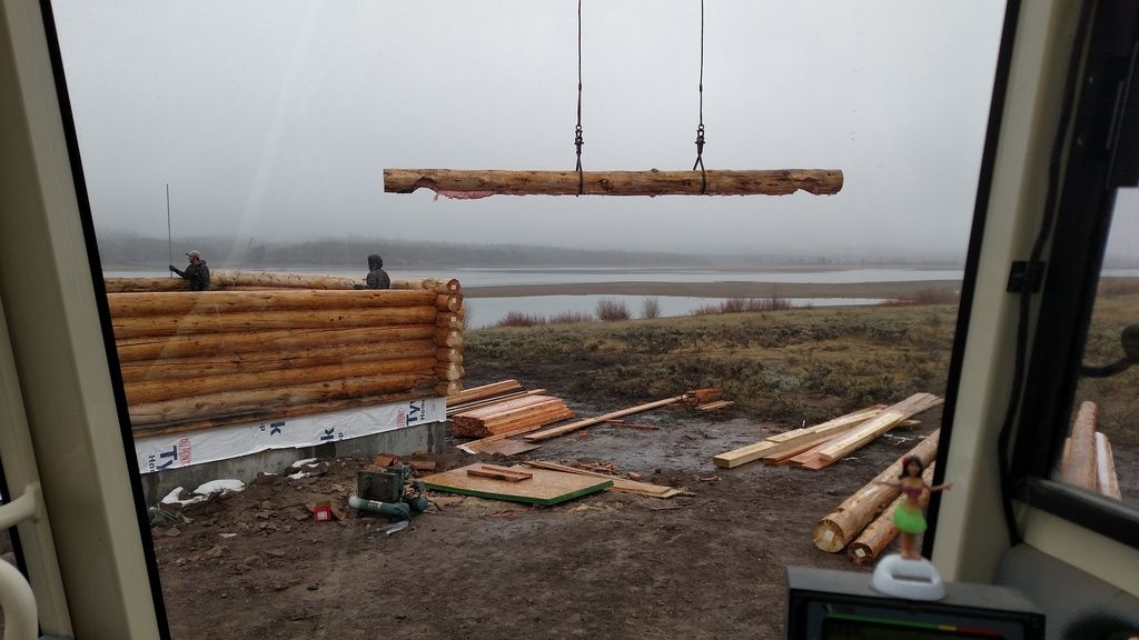

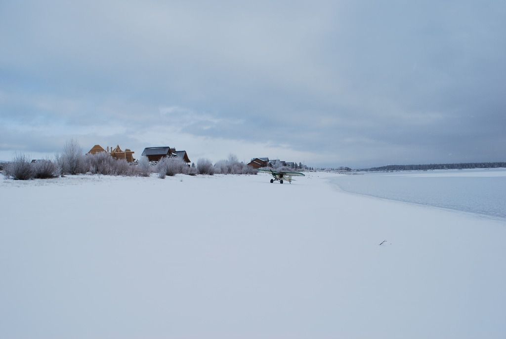

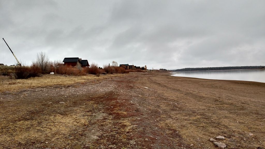

I was swinging logs on a log McMansion project for two weeks straight, and every other time I'd rotate I got this view.
On a lunch break I walked the shoreline, (the job site is on the left) and came back today to land it.
Didn't measure it or anything (not that's there is anything wrong with that), just eyeballed it. It went as planned, though the snow depth was just deep and crusty enough for me to drag it twice and get a feel for things. As you can see the landing was pretty short, no braking of course. 7 degrees temps! After eyeballing this for so long on that boring job, it was super satisfying to come back and "kick it's ass" :twisted:
